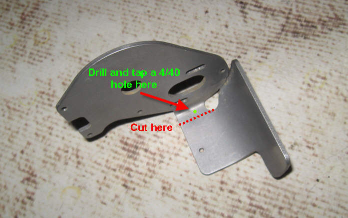

I built a mod motor jr for oval racing years ago, but mine used the H-arms vs the 5 link. The trans conversion is very easy to do and I used the stock motor plate (modified). I know I still have the plate here, but I can't find it. But this is what I did:
By doing this, you're still able to attach the motor plate to the chassis for a little bit more stability...without having to fabricate a new piece.
