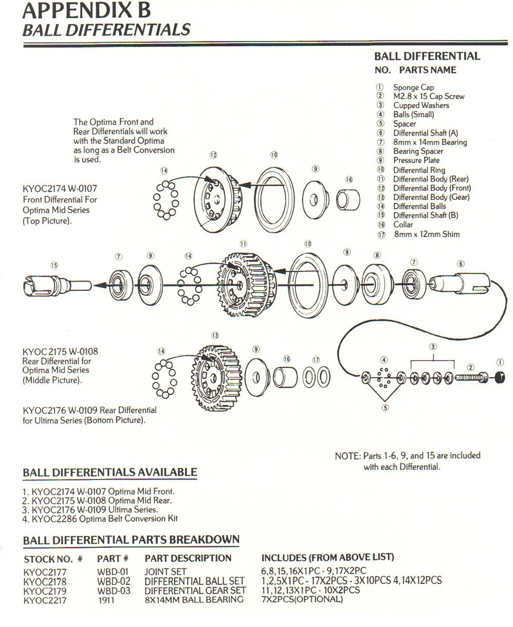

Just in case it helps....
Factory Works website
