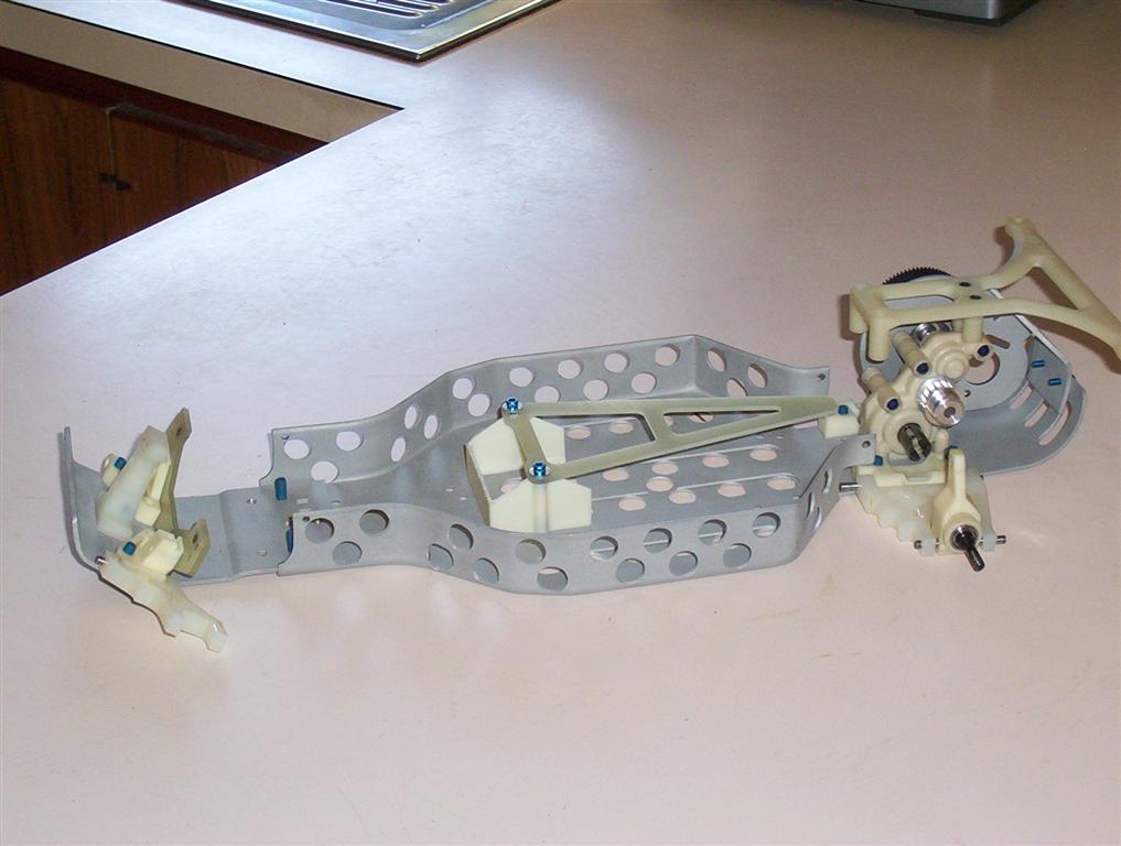

Hi Guys,
Hi Adam,
Thanks Mate!
I have made some more progress,
I found that I can use RC10T hinge pins with a couple of shims.
I will try to take some more pics this afternoon.
I have turned the front diff into a spool, by leaving out the diff balls and cutting drive rings
out of rubber sheet.
Since it won't need to turn I used bushings instead of bearings and replaced the 6 small ball
bearings with a 4-40 small pattern nut as a spacer.
I have done this before with my T3 when running a 3 cell lipo, it works!
Cheers, Dave. :)

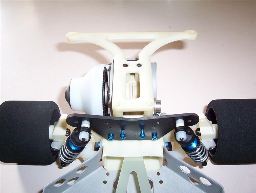

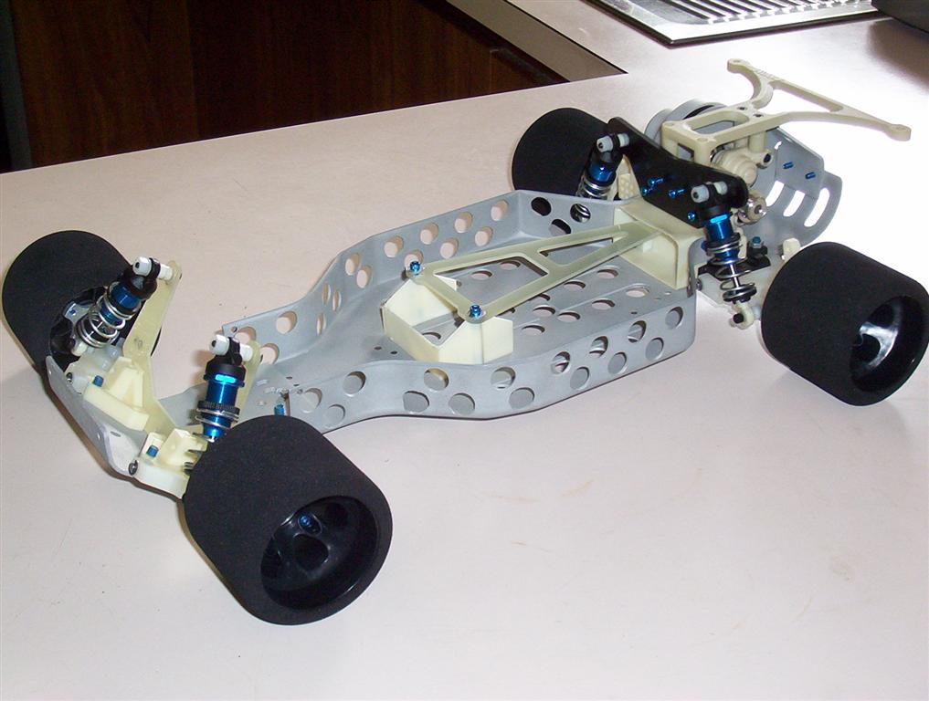

Hi Guys,
The promised pics,
The postie brought some more parts from Tower Hobbies,
but now I am out of parts again!
I am using vintage #6360 RC10 rear arm mounts that are 1.5 degree toe-in, not re-release #6360
rear arm mounts which are 3 degree with #6366 1.5 degree rear carriers.
I put the left hub carrier on the right hand side and right hand hub carrier on the left hand side to
give zero toe in.
Cheers, Dave. :)

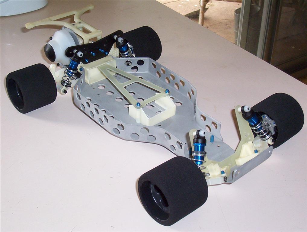

A couple of more pics,
Cheers, Dave. :)
