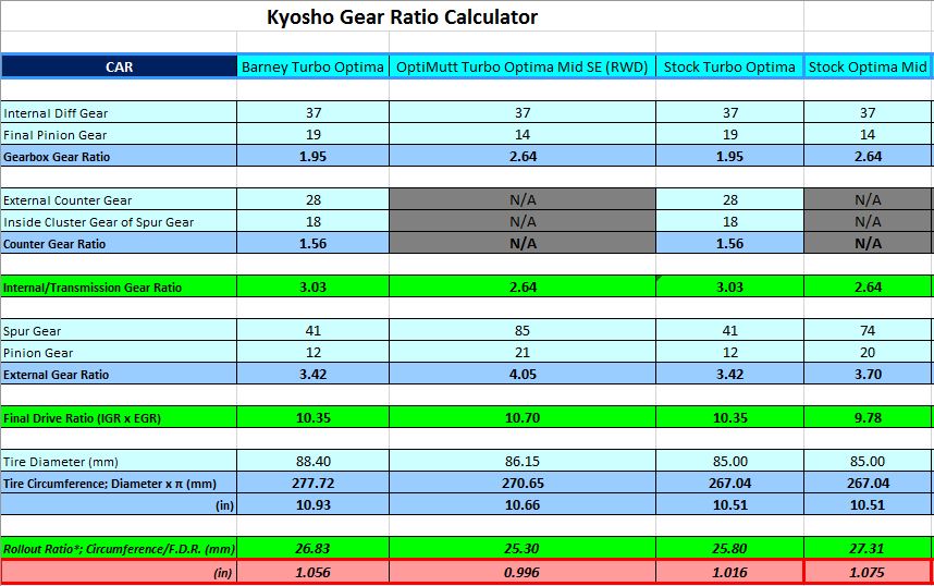

doublfelix wrote:I also need to track down a pinion gear for the 24° stock motor (27T) that was thrown in as part of the deal, is there a gearing chart somewhere (or in other words, what size pinion am I looking for?). There are also a few screws here and there that have either started to strip, have the wrong type of head, or are (will be) missing.
Your optimal final gear ratio is less dependent on your motor as it is on other factors, like your spur:pinion ratio and tire diameter, because all else being equal, every 540-size motor rotates the same distance in one revolution (and therefore has no difference in rollout ratio). The stock Optima Mid has an IGR (internal gear ratio) of 2.64; the EGR (external gear ratio) is your spur-to-pinion gear ratio. You haven't mentioned the number of teeth of the spur gear you're using. (Stock Optima Mid had a 74T spur and 20T pinion, I believe, for an EGR of 3.70.) Multiply your IGR x EGR gives you your FDR, or final drive ratio.
If you can provide your tire diameter, you can calculate your tire circumference; divide that by your FDR and you'll have your rollout ratio...I aim for that number to optimally be 1.00, plus or minus 10%; i.e. 0.90 - 1.10. Anything in that range is probably close to ideal. If you're aiming for a bit more torque, go with the choice that's 1 tooth less; if you want more top speed, go with the choice that's 1 tooth more.
Let me know your tire diameter and spur gear tooth count and I can provide a couple pinion numbers that would be close to theoretical best. I made my own spreadsheet to calculate this.
