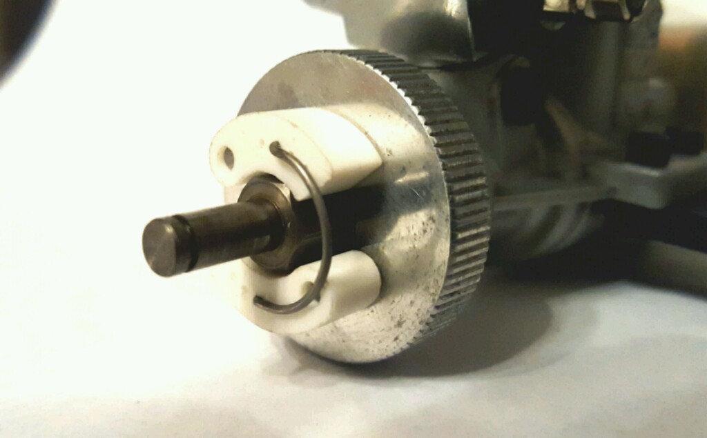

Can anyone shed some light on these clutch springs? I have only ever seen two, maybe three in total. They are bent too nice to be home made and I have never seen literature anywhere about them. None of my manuals show them.

They are genuine associated parts. Only used for a little while before associated (apparently) decided they were'nt needed, and stopped using/making them. Early kits have them, and they were available separately like any other spare part. I have a couple early kits that have them, and one individually packaged one, but it has the yellow Yokomo packaging for the Japanese market. The nip one I have is the only one I have ever seen, so I think it's safe to say they are extremely rare.

I thought they were a factory piece but found it strange that I have never seen them in any documents. It's a shame Associated did away with them as it seems like a brilliant tunable set up. I never liked the way the stock shoes drag on the bell at idle.

I believe they were in the early manuals, and I vaguely remember there being a supplement card when they stopped using them. I'll see if i can find anything on it in any of my paperwork. I believe the reason they stopped using them is because they dragged on the clutch bell pretty bad. I've seen some that were razor thin from rubbing against the bell. In addition to the mechanical problems that created it also created a potential high frequency radio interference issue. Imo, it was a good idea on paper, but not executed well mechanically.
