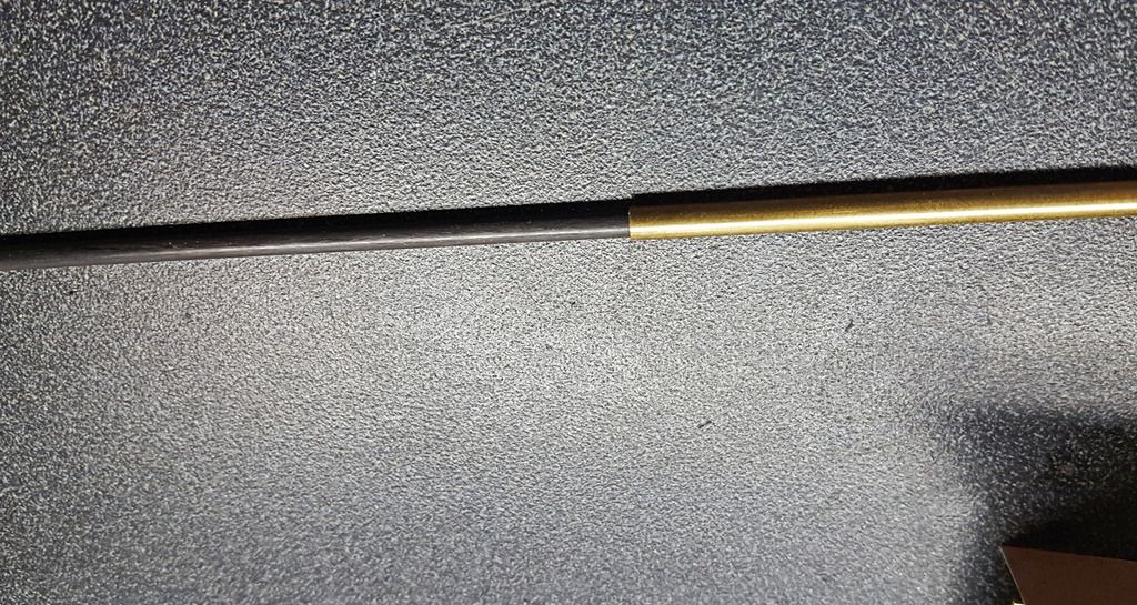

To make my chassis rails incredibly strong I'm inserting Midwest .125 solid carbon fiber rods into them. Super strength without the weight.

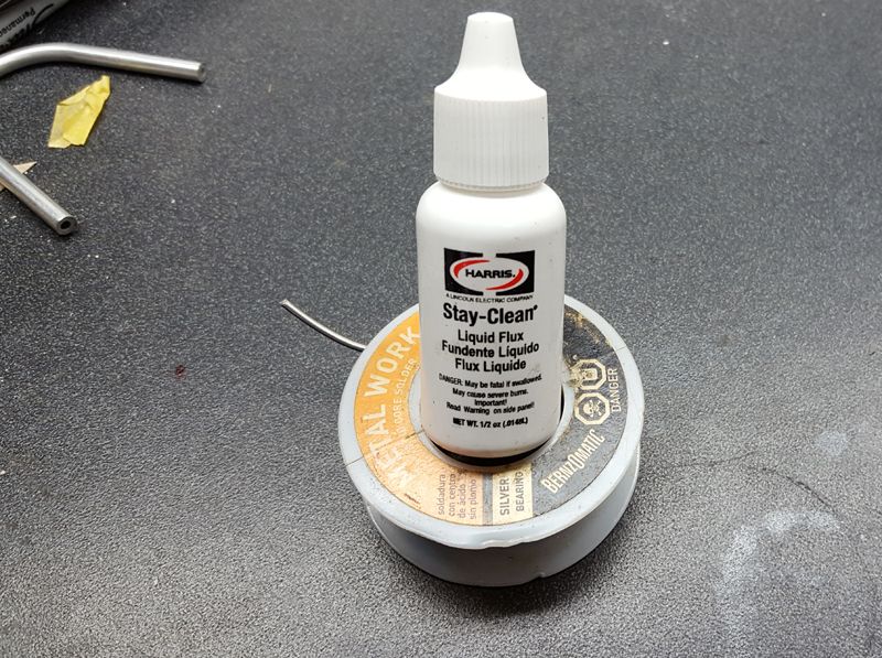

For solder I'm using BernzOMatic silver metal work solder and StayBrite liquid flux.

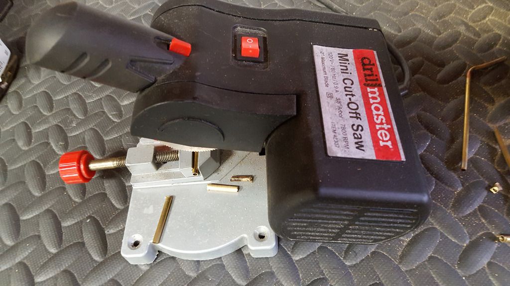

I've been using this little chop saw from Harbor Freight for years. It's made to cut brass tubing and was only $14.00. A very handy little tool.

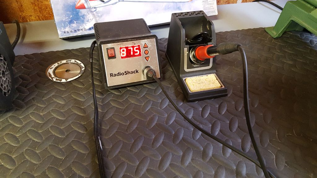

The most important tool you'll need is a soldering iron that can achieve very high temps.

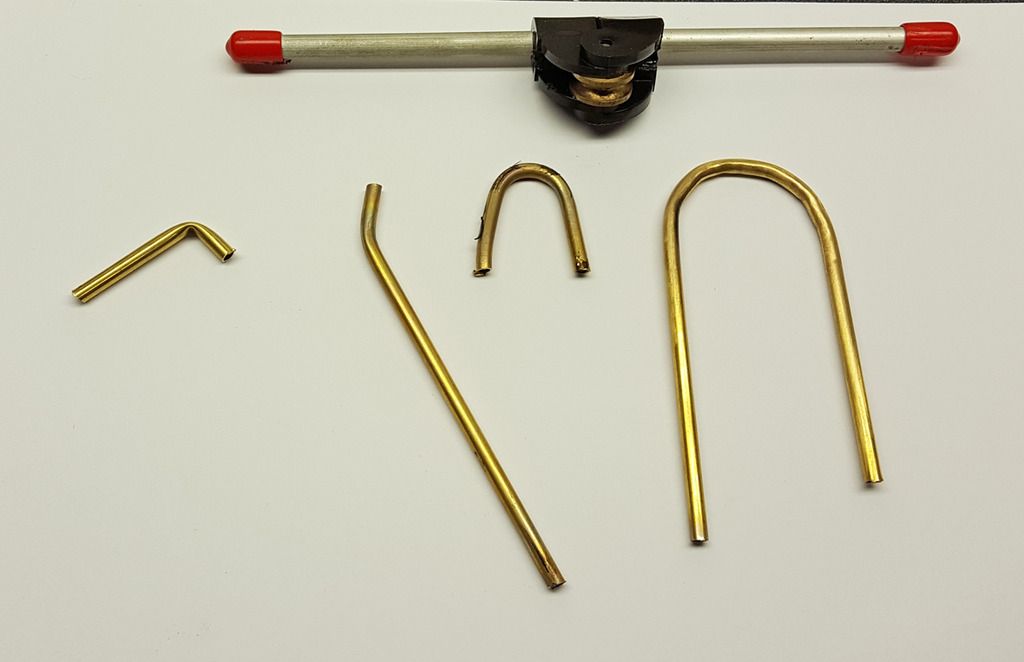

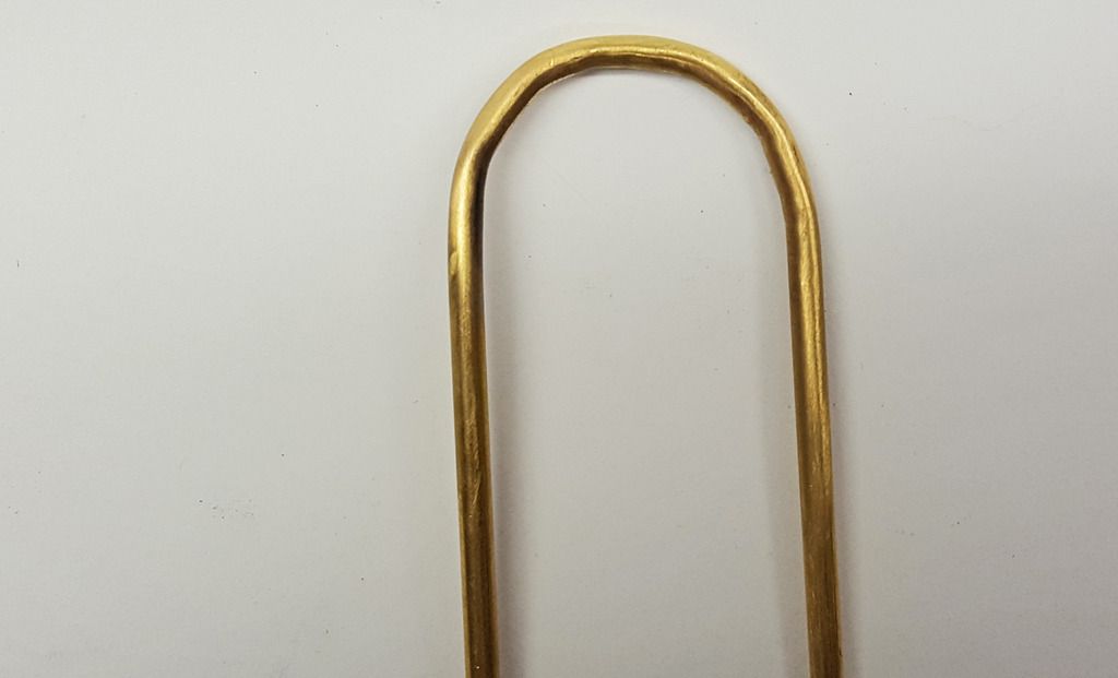

This cheap little Dubro tubing bender is very handy too. You'll also need a propane torch to heat up the tubing for bending. The first bit of tubing shows what happens if you try to bend it cold. The other examples are heated tubing bends. Note that larger more complex bends will result in some kinks and dents. These are easily fixed though as I'll show later. If you invest in a brake line bending kit you could do perfect bends. The Dubro tool cost about $5.00 so I went with it.

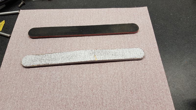

Solder is incredibly hard stuff to sand. I highly recommend sanding sticks as shown and paper of about 120 grit for smoothing the solder joints. Lighter paper of 400 - 1000 grit can be used to smooth and polish the final product.

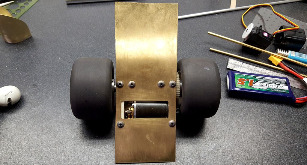

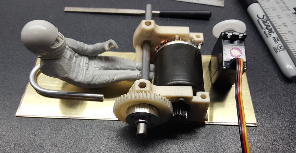

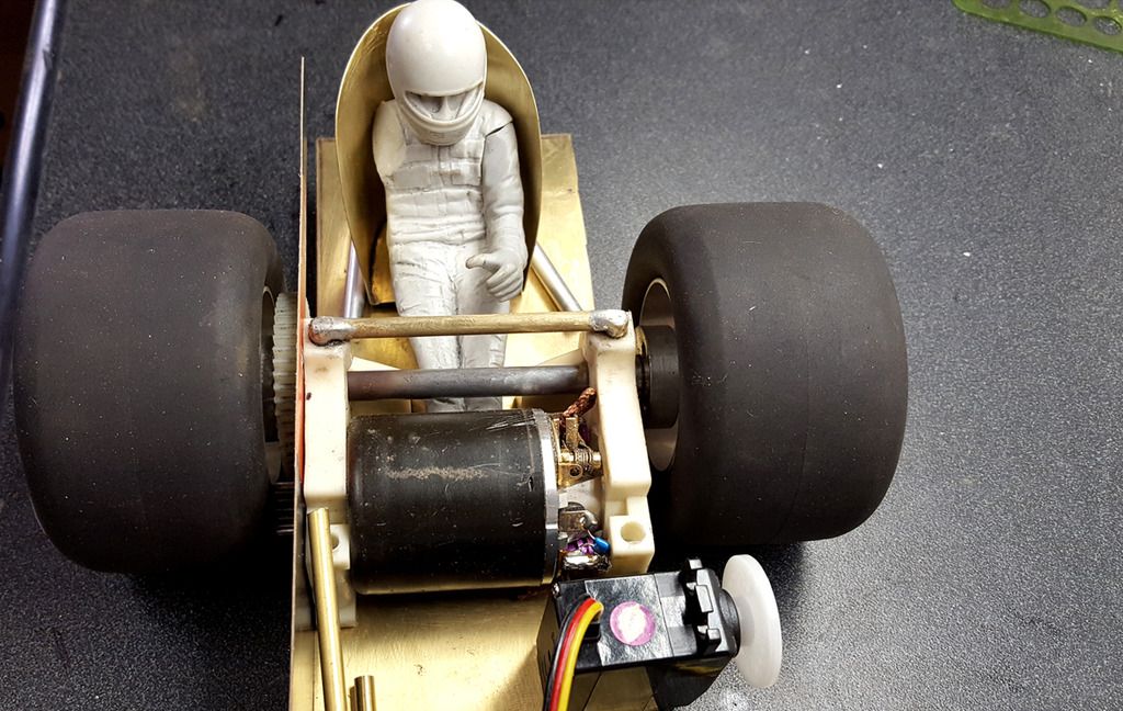

Here is the .032 sheet that I cut out to form the main chassis piece. I'm using RC12E rear axle mounts, hollow axle and an old Paragon mod motor which I'll rebuild later. The slot for the motor was drilled out and then hand filed. It's better to have too much material than not enough. The rear half will be trimmed away once I figure out how much I need and where to make my cuts

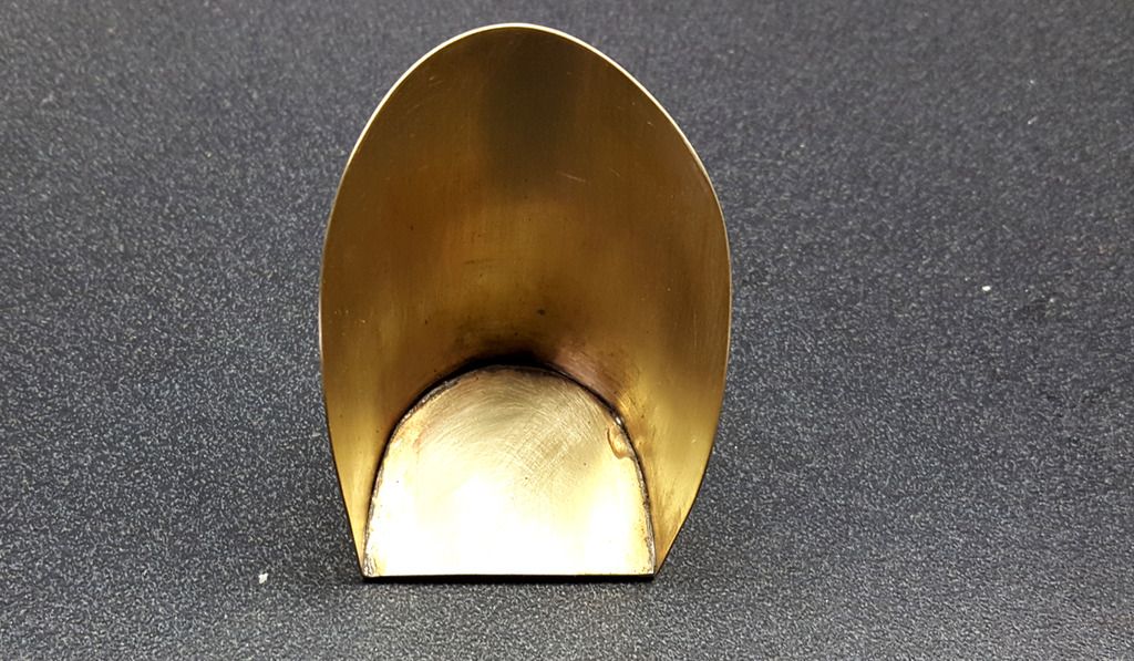

Here is the drivers seat which I cut out of flat .016 sheet. I formed this around a paint bottle I had handy and tapped it with a hammer. I then soldered the bottom in. It will need more trimming and fine tuning before it becomes a final piece.
The driver is actually a 1/12 indy car figure. I'm going to resculpt his arms and helmet. He's going to have an alky mask. Steering servo will mount up about there and a micro receiver will sit beside it.
Here I've added the first brace using the holes in the axle mounts.

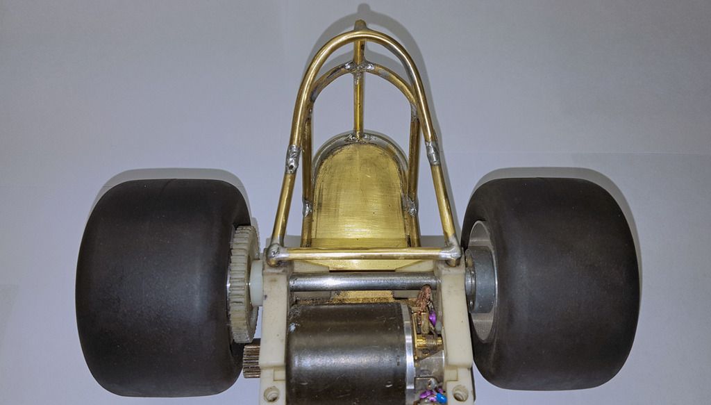

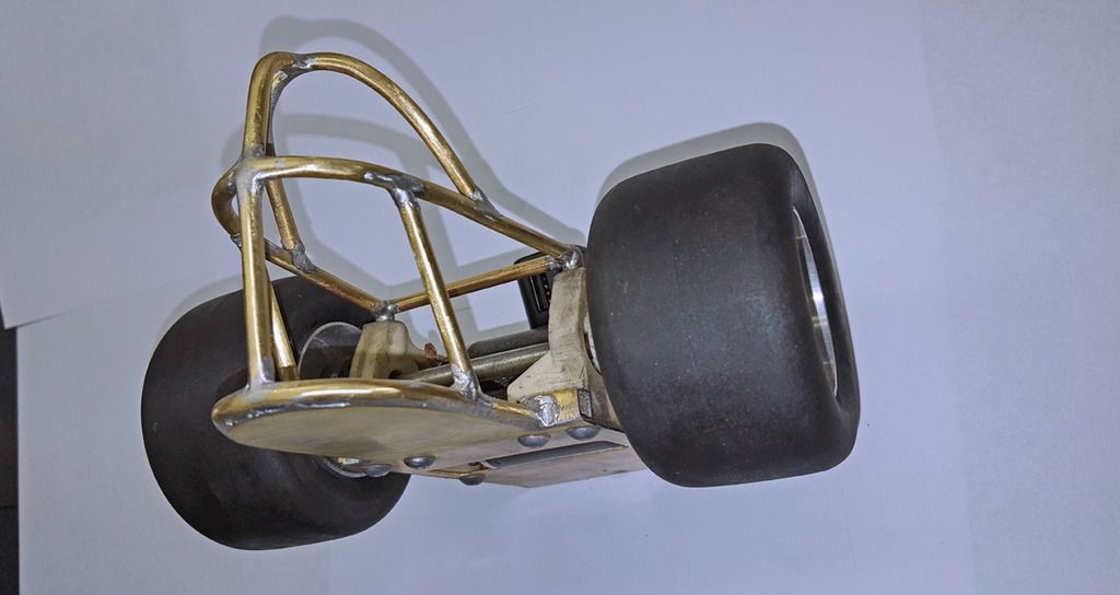

The main part of the cage has been completed. The RC12E front arms will not be used, they're just for mock up. I'll be bending up an aluminum axle for it.

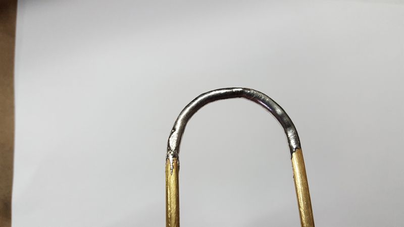

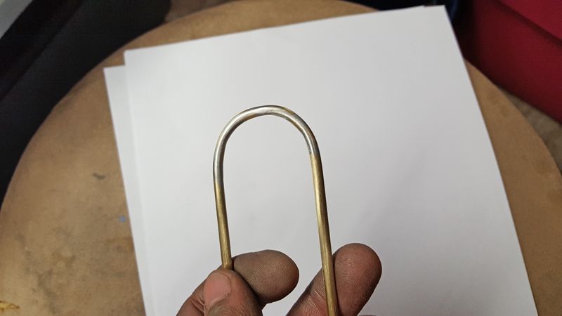

Here is piece of tubing that I had trouble forming. Notice the kinks in the tubing.
To fix a part like this you simply fill in the kinked or flat areas with solder.
Sand off the excess solder and there you have it.

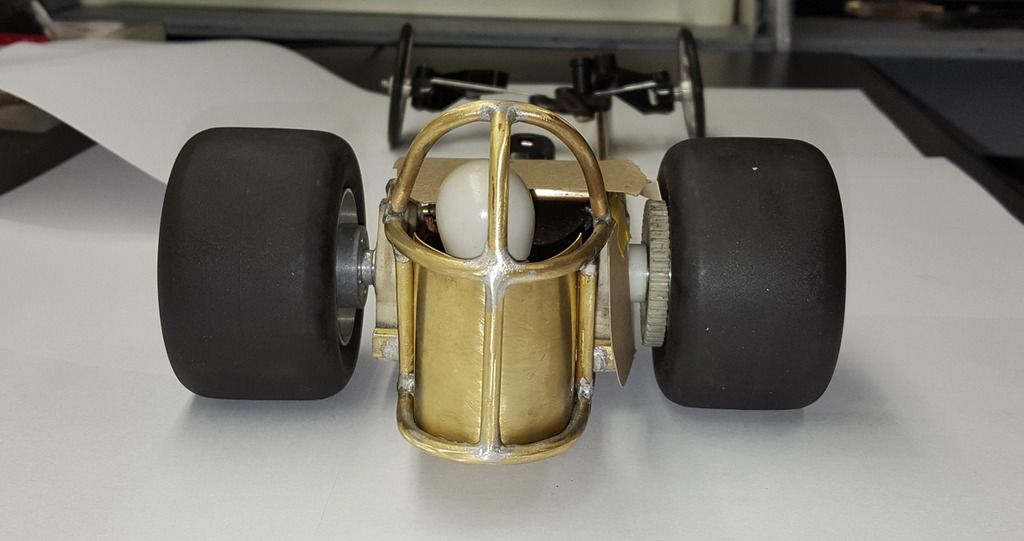

Almost ready to soldered into place. The seat will get a major trimming, I want it flush against the cage. This is where I'll have to leave it for this week. Hopefully I'll have the rails on it by the next update.

another way to bend that hard tubing without the kinks, is to fill the tube with sand, flatten, bend over and solder the ends shut, make your bends, and then cut the sealed ends off.

jwscab wrote:another way to bend that hard tubing without the kinks, is to fill the tube with sand, flatten, bend over and solder the ends shut, make your bends, and then cut the sealed ends off.
Blast! You're the second person that's told me that. Wish I had known before, I've already done all the hard bends too. Oh well, I know now, thanks for the tip.

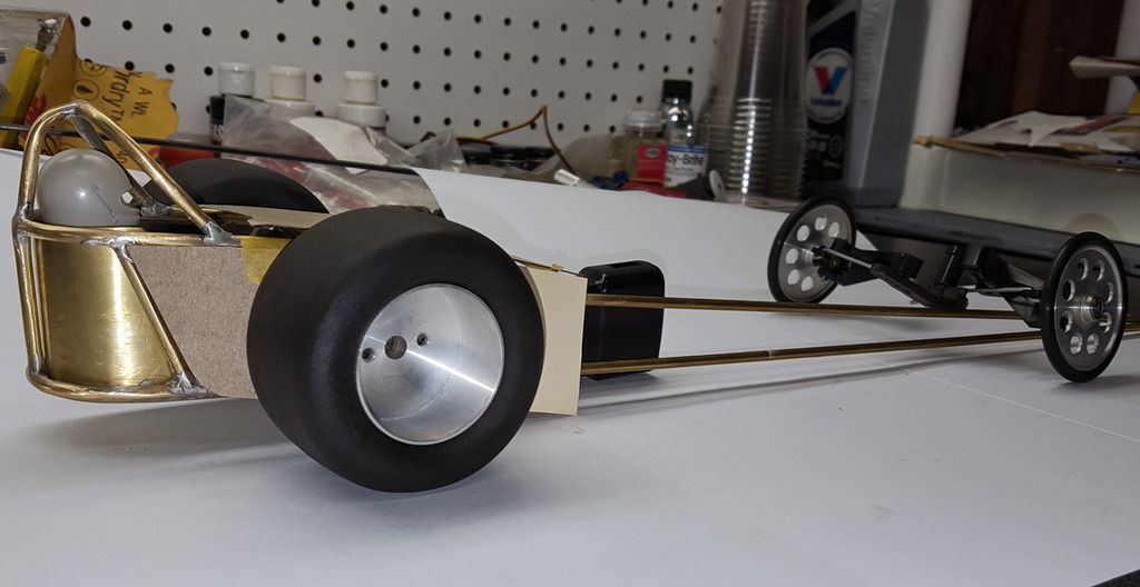

I'm going all the way with this one guys!
I had some free time this morning so I put in a few hours of work on it. I got the excess material removed from the rear and just about finished up the cage.
I have lots of sanding to do on those solder joints. I need to get that done so I can fabricate the parachute mount and push bar.
I'm almost happy with the fit of the seat now. Just a little more fine tuning. The driver will need to be raised up a bit now that the seat fits. I think it's really starting to look the part now.
Last shot, I'll have more updates by Monday.

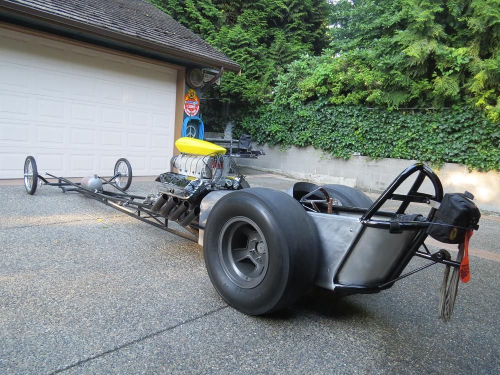

When you titled it dragula, i thought you were going to build this...

lowrydesign wrote:When you titled it dragula, i thought you were going to build this...
I was thinking about the Rob Zombie song at the time. :lol: I forgot about the Barris Munsters car. Always loved seeing it on the tv show.
