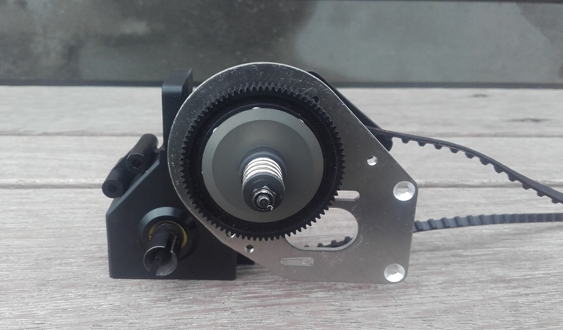

After sorting out the MID spares, I felt all enthusiastic and decided to build another. The last couple of builds has been LWB´s so this time it is SWB time.

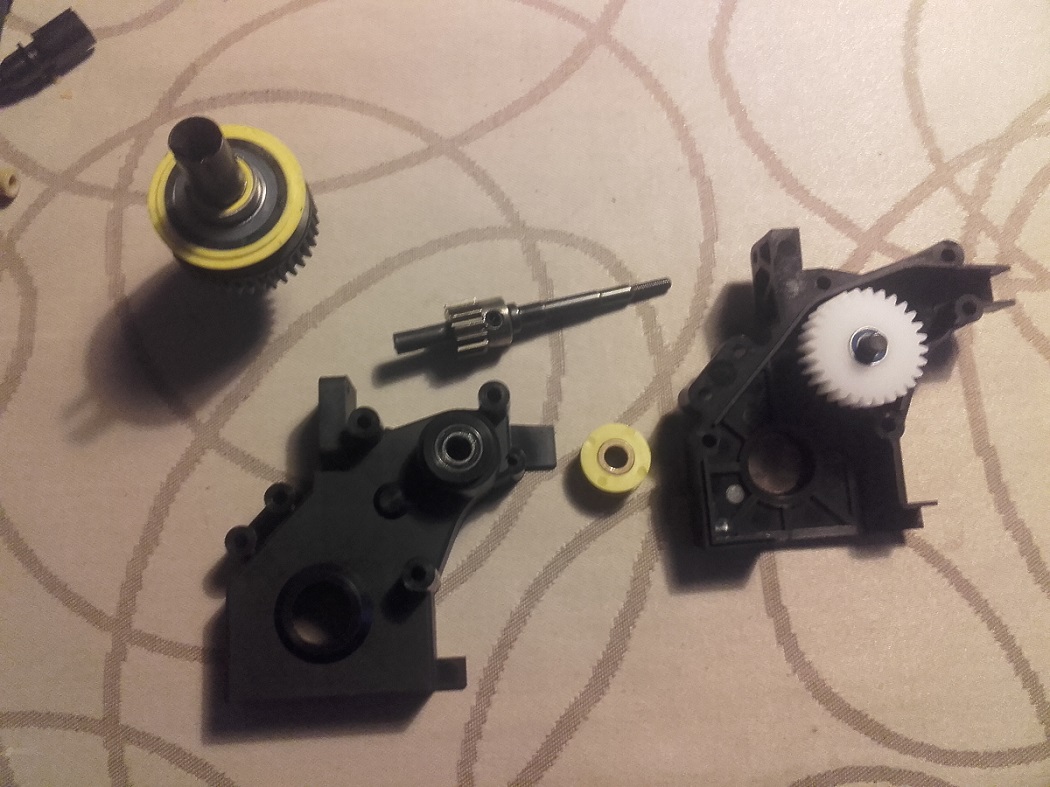

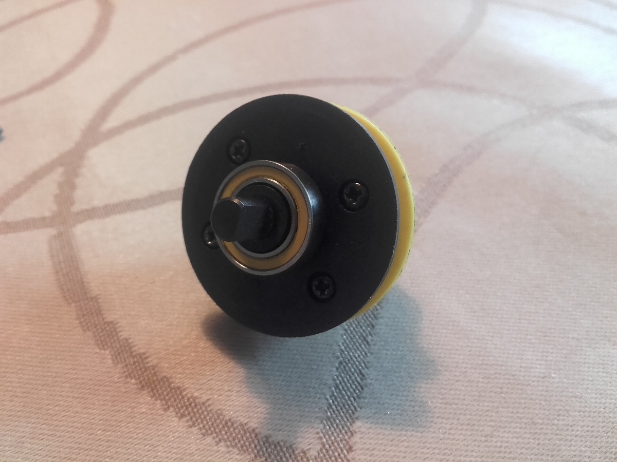

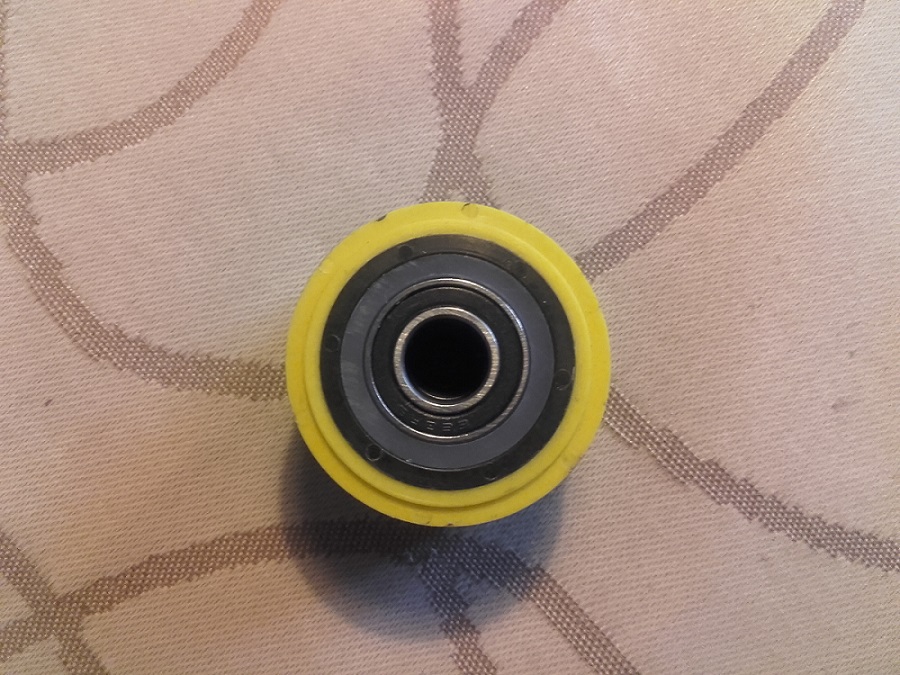

First I built the balldiff and replaced the original spacer with a sleve and a bearing - this should take care of the wobbly tendencies

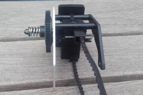

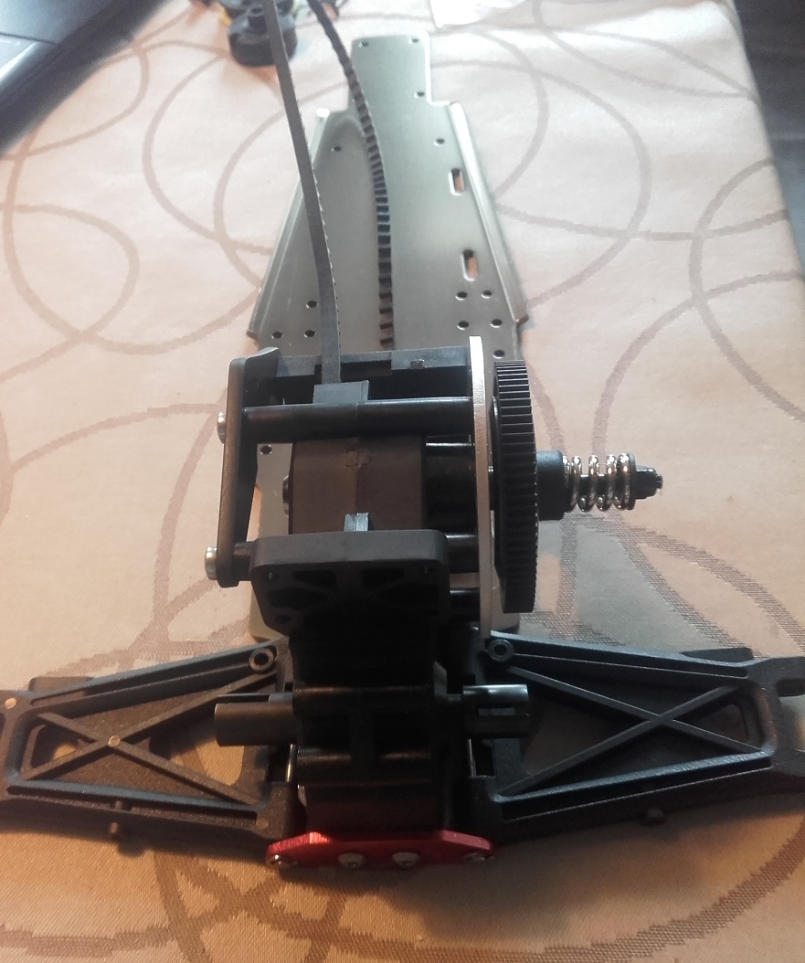

Next was fitting a slipper shaft and assembly of the rear transmission.

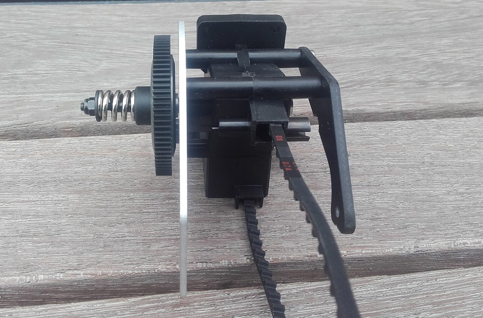

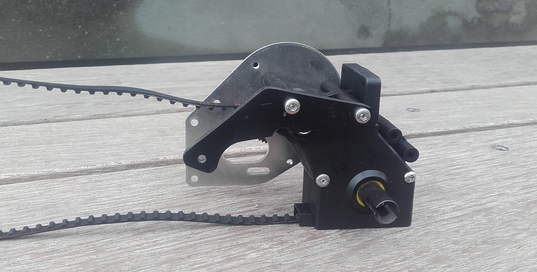

The finished rear transmission

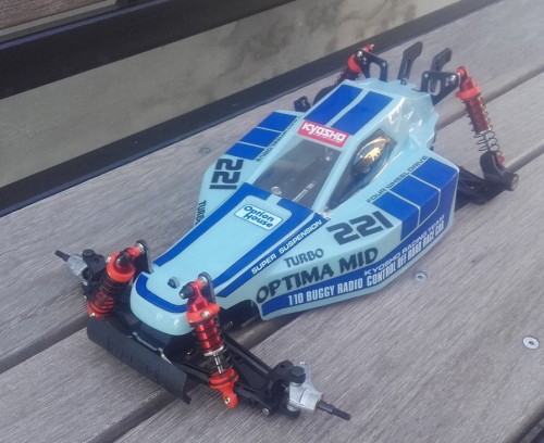

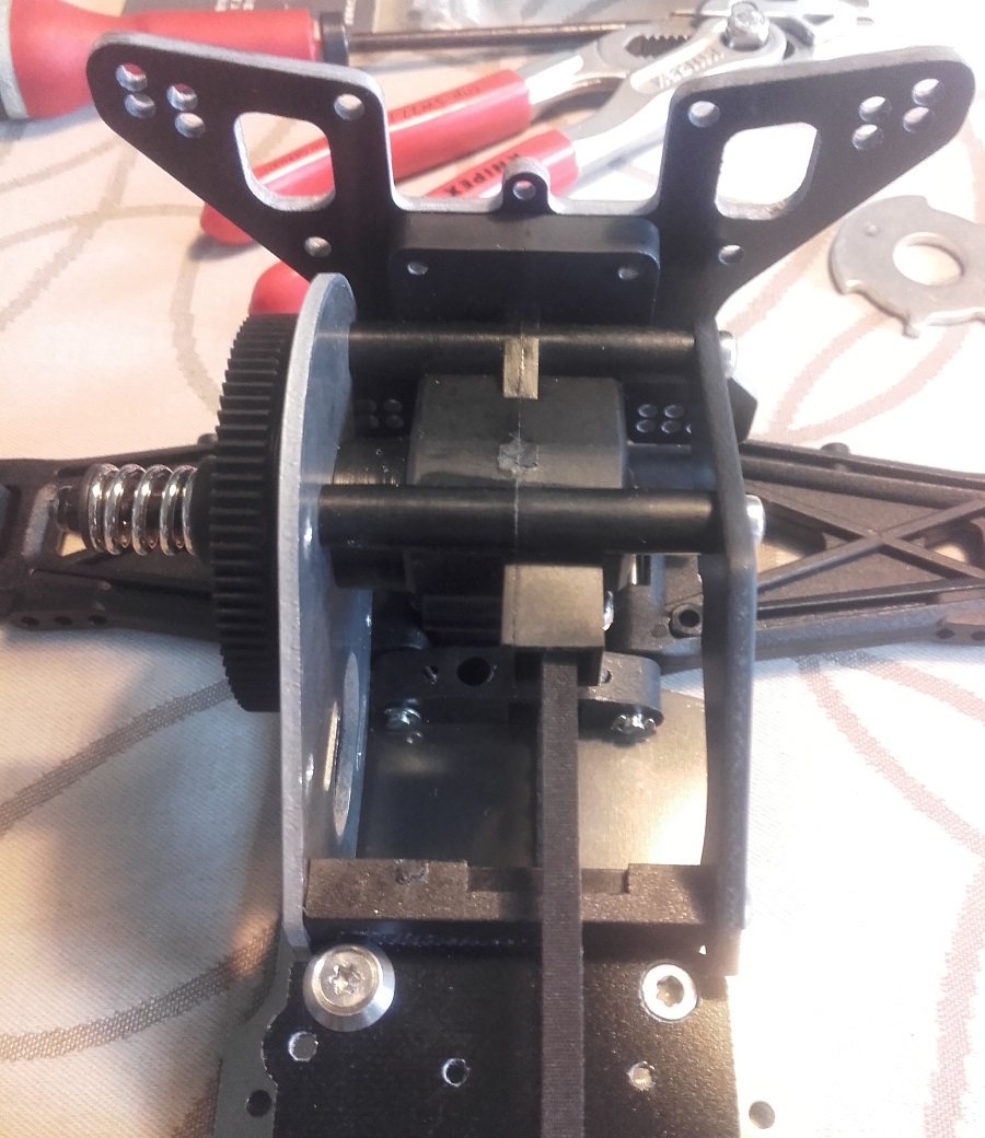

Rear transmission mounted on the chassis and the rear suspension arms installed with a 2 degree TF option part

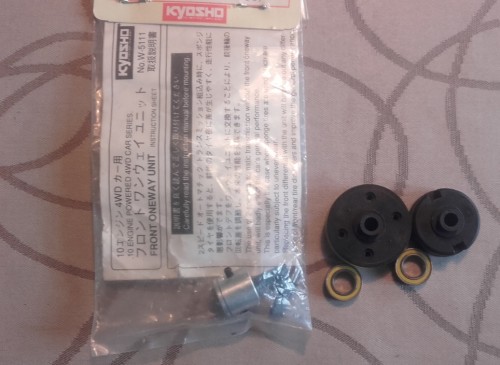

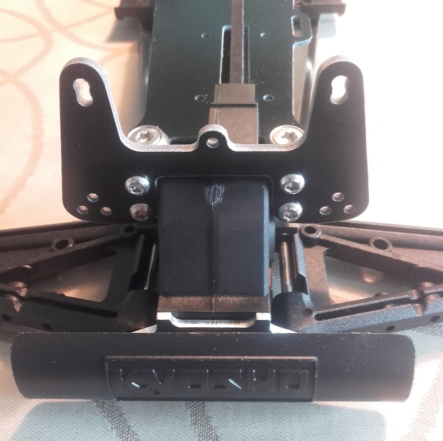

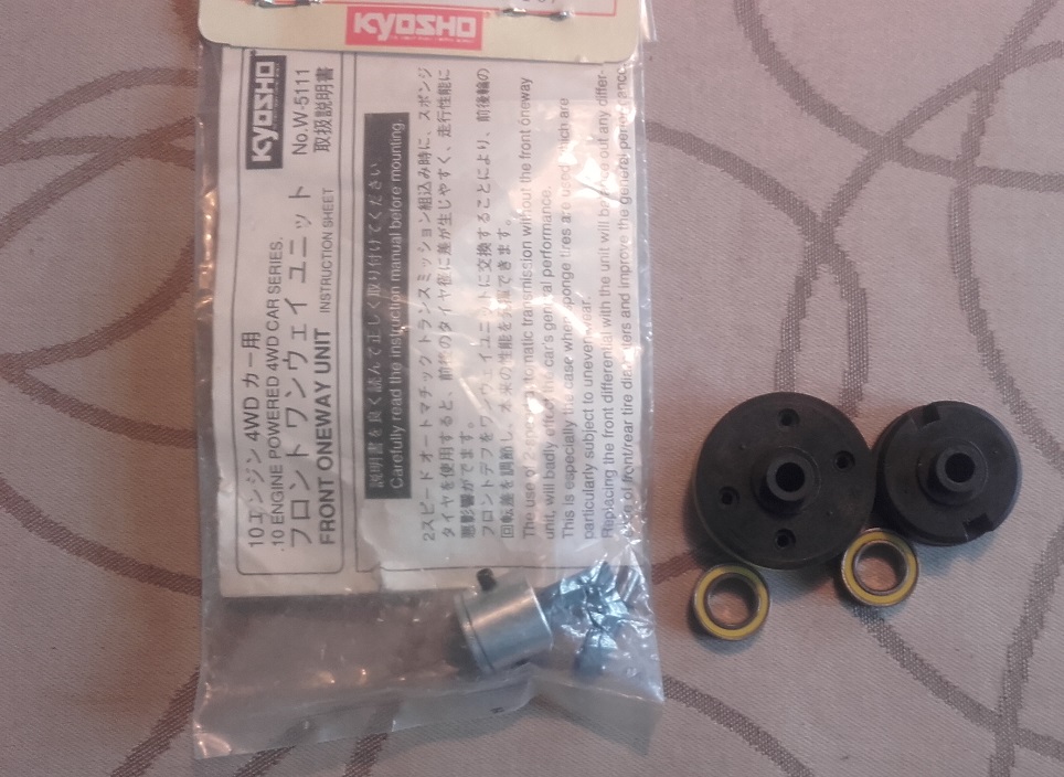

Next up is the front diff, which actually isn´t a diff, but a one way. I like how the bearing shields match the yellow on the pulley.
Next time, I´ll tell You all about how I mounted the front transmission and the shock towers :mrgreen:

Hey Dennis, can you tell me more about that slipper gear assembly you're using? Is that the B4 slipper gear mod?
DennisM
Posts: 2405
Location: Denmark
Has thanked: 30 times
Been thanked: 62 times
Re: Optima MID Turbo+
Post by DennisM »
It´s a mash-up - Carson shaft and spring, Traxxas gear and Kyosho plates :)

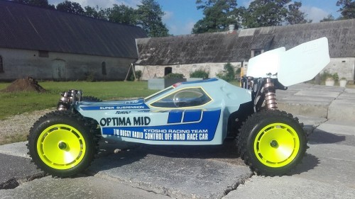

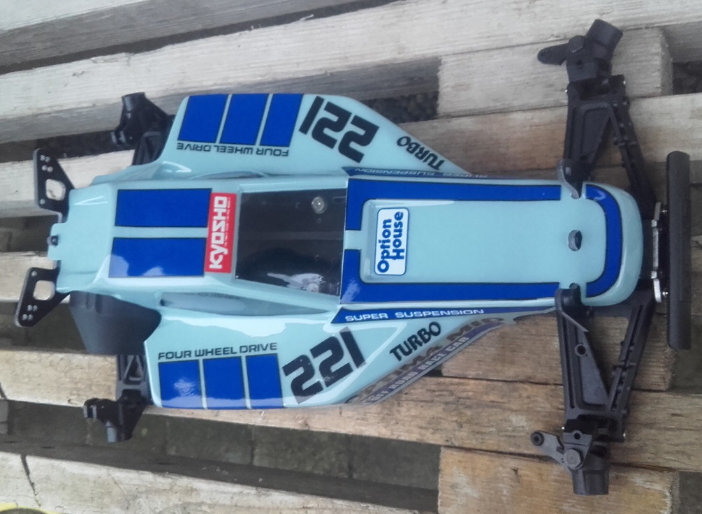

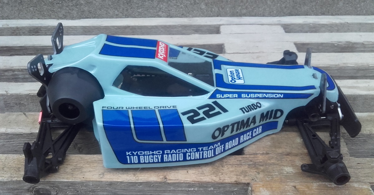

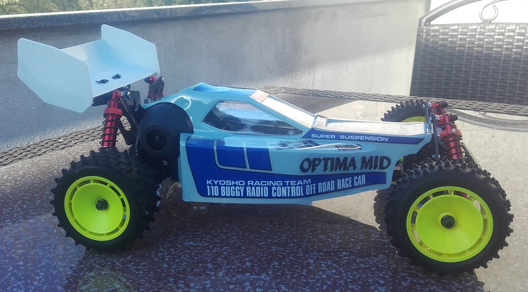

Now brace Yourselves for this last slide down the rollercoaster :mrgreen:

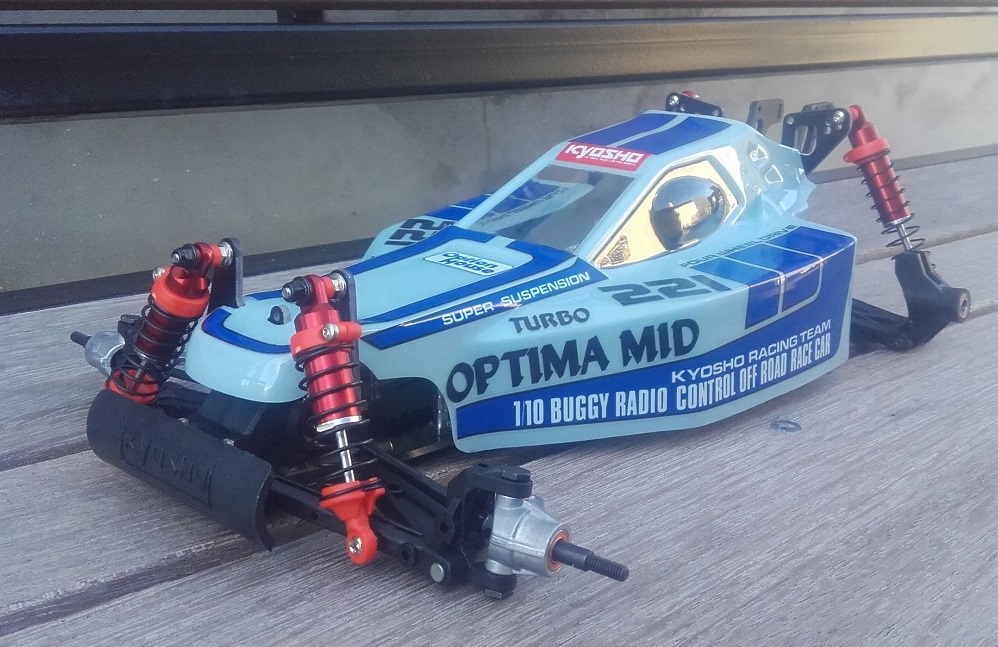

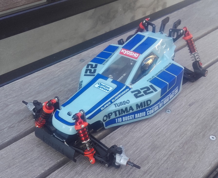

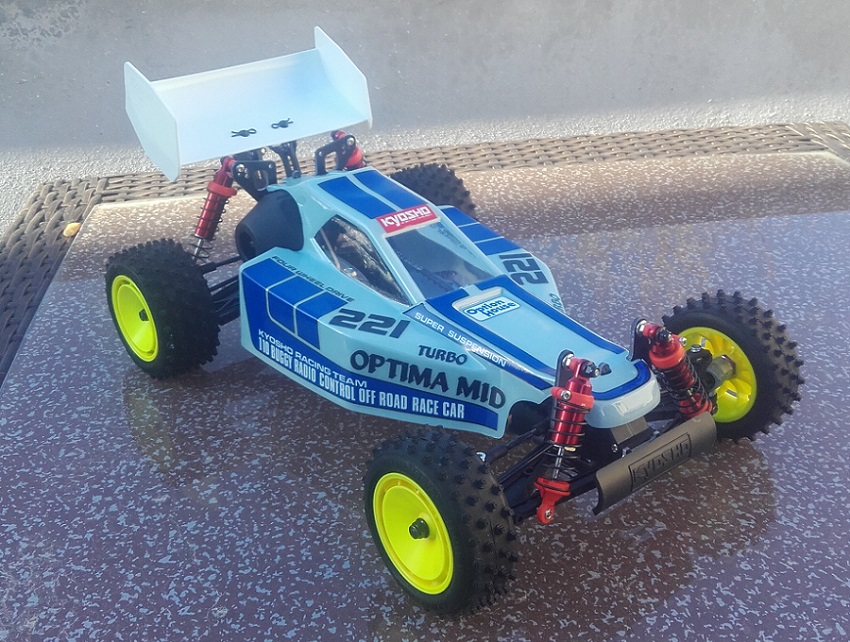

Replaced the "Ketchup" shocks with a set of Mayonaise.
Mounted some new FRP bell cranks (LA361) which dimension wise, is the same as the 39655 blue special unicrank set.
Gone fishing

Can you comment on the quality of the Mayo dampers?
Could you also please let us know what carson (and other) exact part refs you used for the slipper?

Lonestar wrote: Fri Jun 16, 2017 5:38 am Looks very, very good :)
Thank you!
Paul
Thanks for the kind words.
Slipper plates: Kyosho LA204
Slipper Shaft: Carson 500405684
Gear : 14T 0.8M 5mm bore Traxxas 5640
The flange on the shaft needs to be slimmed a little (bearing side).
A slim bearing (3mm) is installed in the gearbox at the non load side.
I´ve drilled and internal threaded (3mm) the shaft at the non load side, to hold a countersunk washer for keeping the non load bearing in place.
The Mayo shocks are spot on - good quality. E-clips are a bit rough though.
The plastic has a different texture - but if mounted with Kyosho plastic, I´m not sure I would be able to tell the difference.
