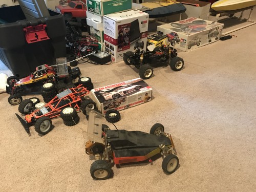

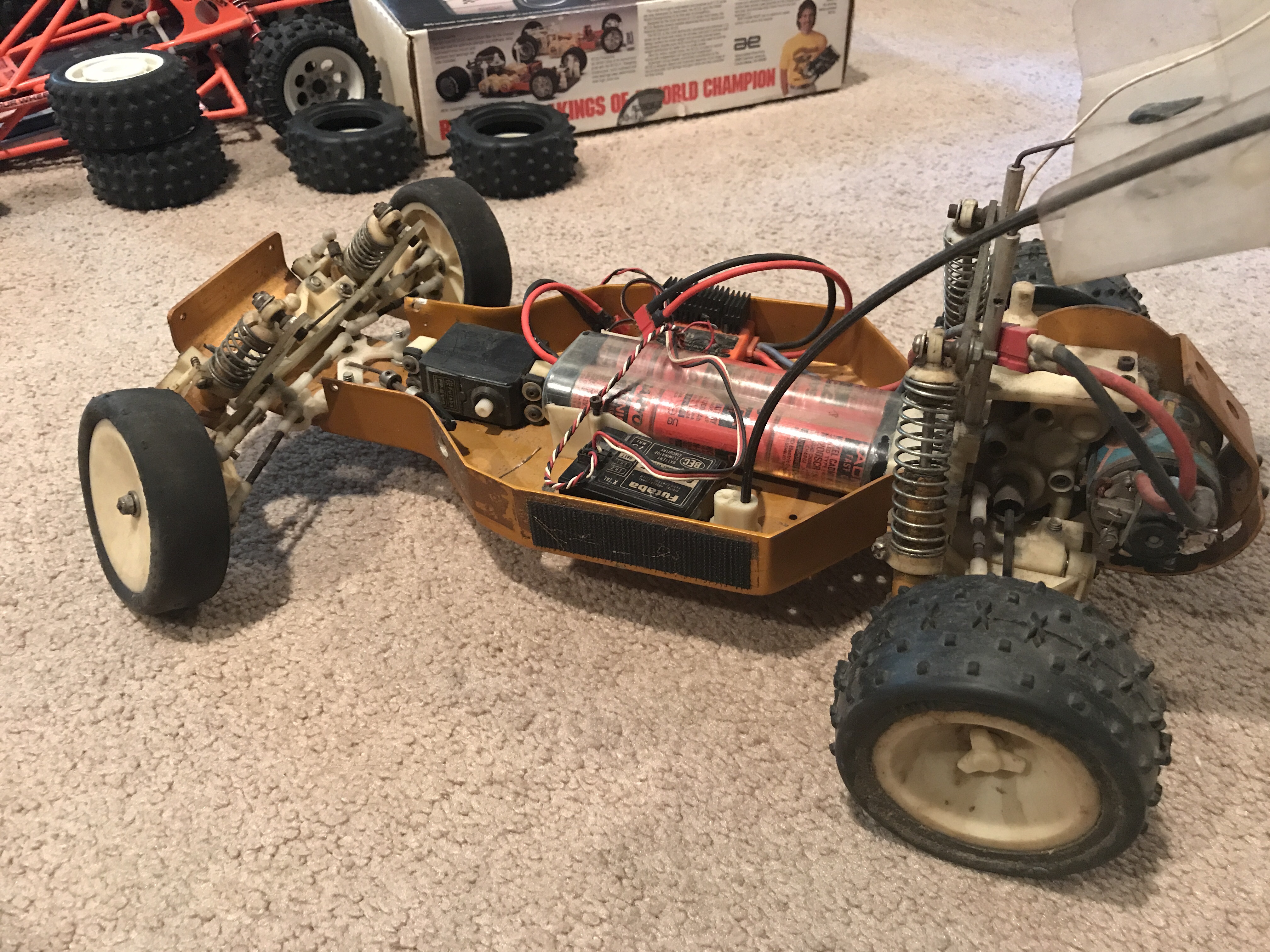

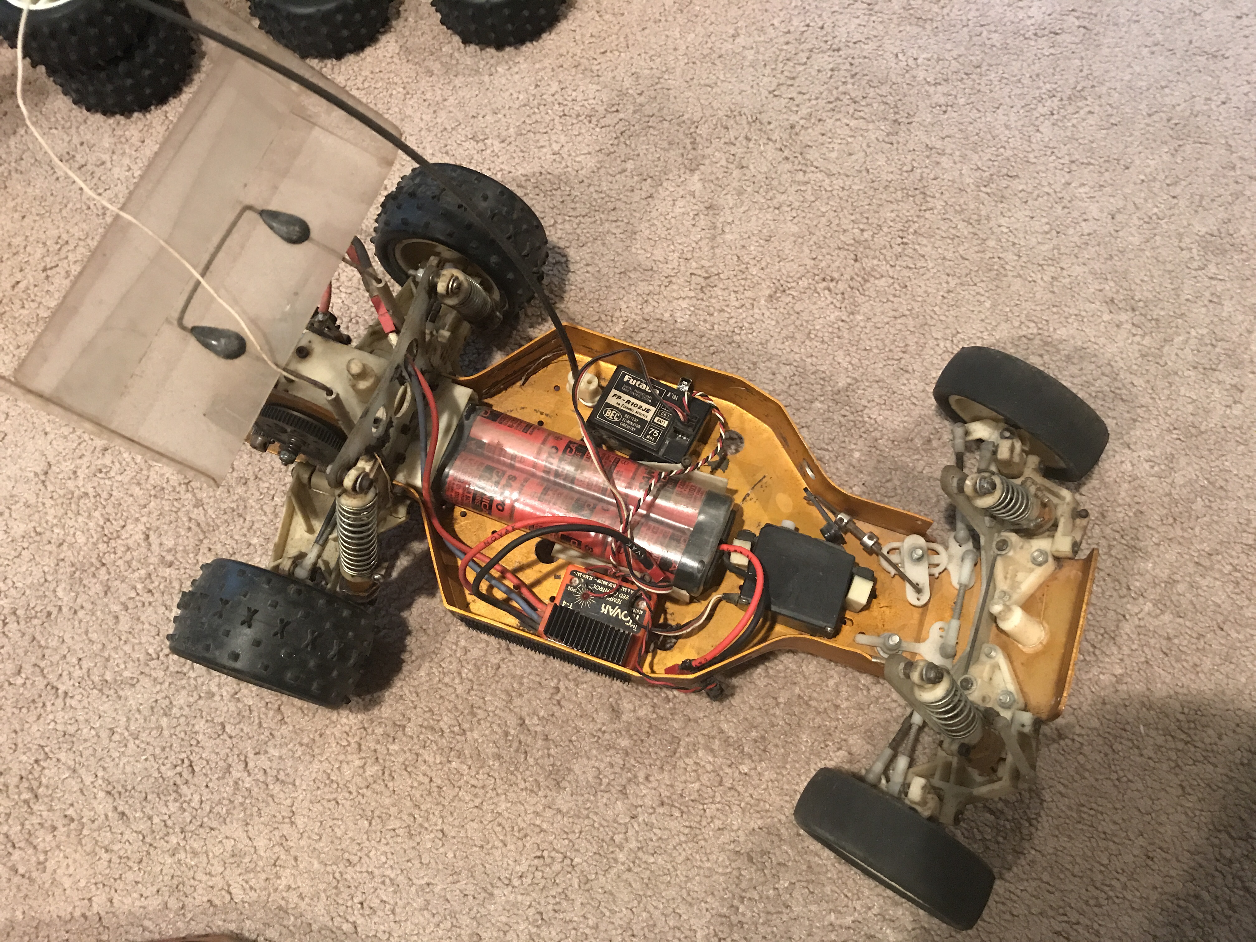

I bought my son (11) the RC10B6D Club Racer. My dad bought me my first RC10 around the same age. So the plan is to take him to the track to race in the club division. I would like to build my old gold pan to keep up in this class as well and have some fun and participate in the race activities as well. I am looking for advice on upgrades and electronic packages to make the older car as competitive as possible with realistic goals of keeping it fun. If I get hooked at the club level I plan on moving in to a new car and attempt modified. I have gotten a few parts on order. Wide A arms. Front wheel conversion. Rear wheel conversion. Bell cranks from ASC though I really wish I could find the JConcepts ones. New titanium turnbuckles and ball caps. After a good cleaning I think I may be on a good start. The electronics today really have me confused. I like the idea of staying with Reedy on this but am looking for all suggestions from anyone doing the same thing. Pinion and spur sizes etc. Thank you all for being a part of this sport and keeping it alive. It consumed me as a boy and coincidentally after pulling out all the old boxes seems to have me hooked pretty hard again.

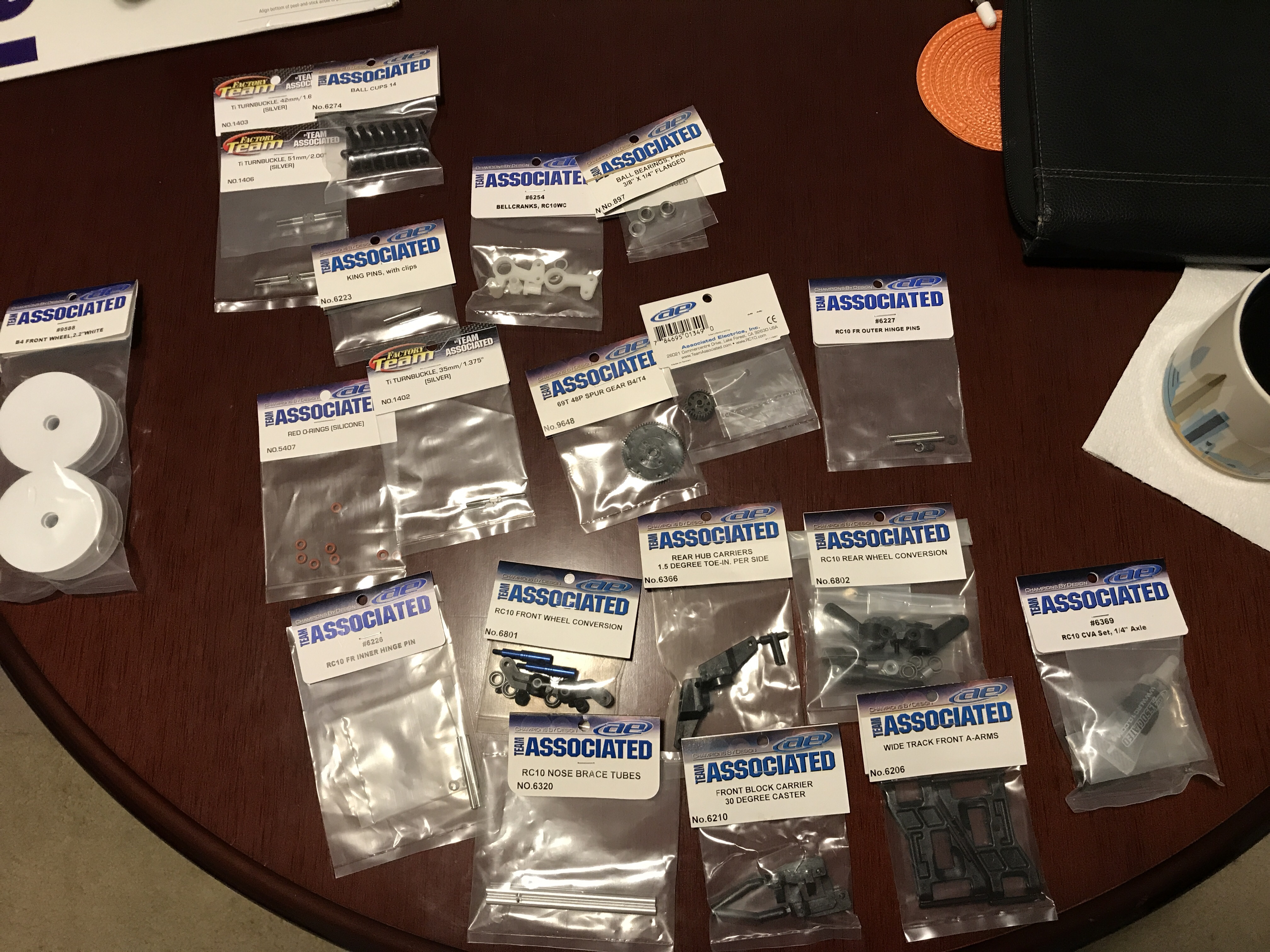

There's a lot to consider. I am assuming you will be running on clay. So once you have freshened up everything making sure your bearings, diff, and shocks are all working as should you then need to consider multiple ways to get modern wheels on it to run 2.2 wheels and modern tires of your choice.
You'll need new bearings and axles for rear hubs (associated sells a kit #6802) to do this and associated sells a kit with new front axles (#6801) Go to the website and look at the parts for the rerelease cars as a good education. If you use these two kits rerelease wheels are good for rear and fronts are any B4 wheel. Just noticed you already have some of this on order, good.
As to electronics, for club level I would get a 17.5T ESC combo from one of many options. You don't have to get into all the settings on them but it is something you can learn over time. I run this one in my RC10 and it is pretty easy to learn and basic if you want to stay Reedy.
https://www.ebay.com/itm/ASC293C-Reedy-Blackbox-600Z-ESC-Sonic-540-FT-Brushless-Combo-17-5T/401369803373?epid=11003810797&hash=item5d73812a6d:g:Q00AAOSwOwlZcTml
You'll probably want a modern radio too. By the time you are done a RTR will look like a bargain but what you have will be way cooler. It is not easy to take one of these old guys and get it up to speed of a modern buggy but at club level it can be close if you are a great driver in my experience. On astroturf Ihave sturggled to get pace but certainly enough to have fun in club level.

I guess in addition to the items already mentioned, you probably will want to replace those missing nose plate tubes and to flip those shocks right side up.

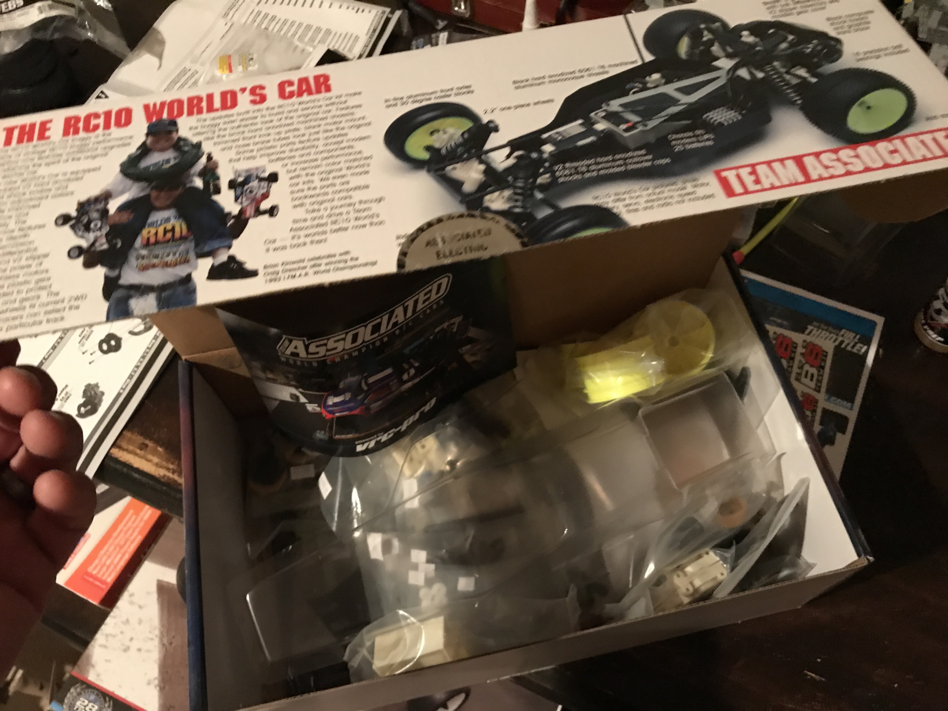

Build the rere. You are right, let's say it goes up one day a couple hundred bucks, hardly retirement money. Read all the threads on what to do if your tranny is an unfortunate binding one, seems a 50/50 shot. In essence, find an old stealth case and old style idler gear solves it.
You may have issues with CVA's popping, mine do not but you can go with longer bones if necessary, can't recall part number. I also changed my bellcranks to Dhawk aluminum. I've run a lot of laps on mine on turf and clay. The stock ball ends not the best either, choose your upgrade, I run RPM.

the re-releases are a combination of molded parts and manufactured parts from China and USA. The classic was fine, the worlds had four major/minor issues; a crappy idler gear and a case that isn't perfect but only fits said crappy gear, as well as dogbones that are too short on the CVA's, finally, a b4 top shaft that was machined improperly.. Super frustrating for sure.

Ok, so in gathering this info I am trying to understand how to get all said issues resolved. I ordered the #6371 the 3/16 cva set. Is that the exact same part that comes in the worlds kit or is it a “fix” for that part. Also Associated is out of that part so... Maybe there is a way to limit travel so the dogbone doesn’t get over extended? Here are some of the upgrade parts for the gold pan:jwscab wrote: ↑Thu Oct 26, 2017 8:37 pm the re-releases are a combination of molded parts and manufactured parts from China and USA. The classic was fine, the worlds had four major/minor issues; a crappy idler gear and a case that isn't perfect but only fits said crappy gear, as well as dogbones that are too short on the CVA's, finally, a b4 top shaft that was machined improperly.. Super frustrating for sure.
