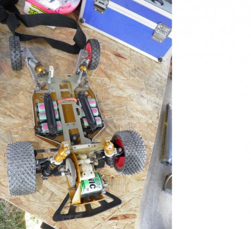

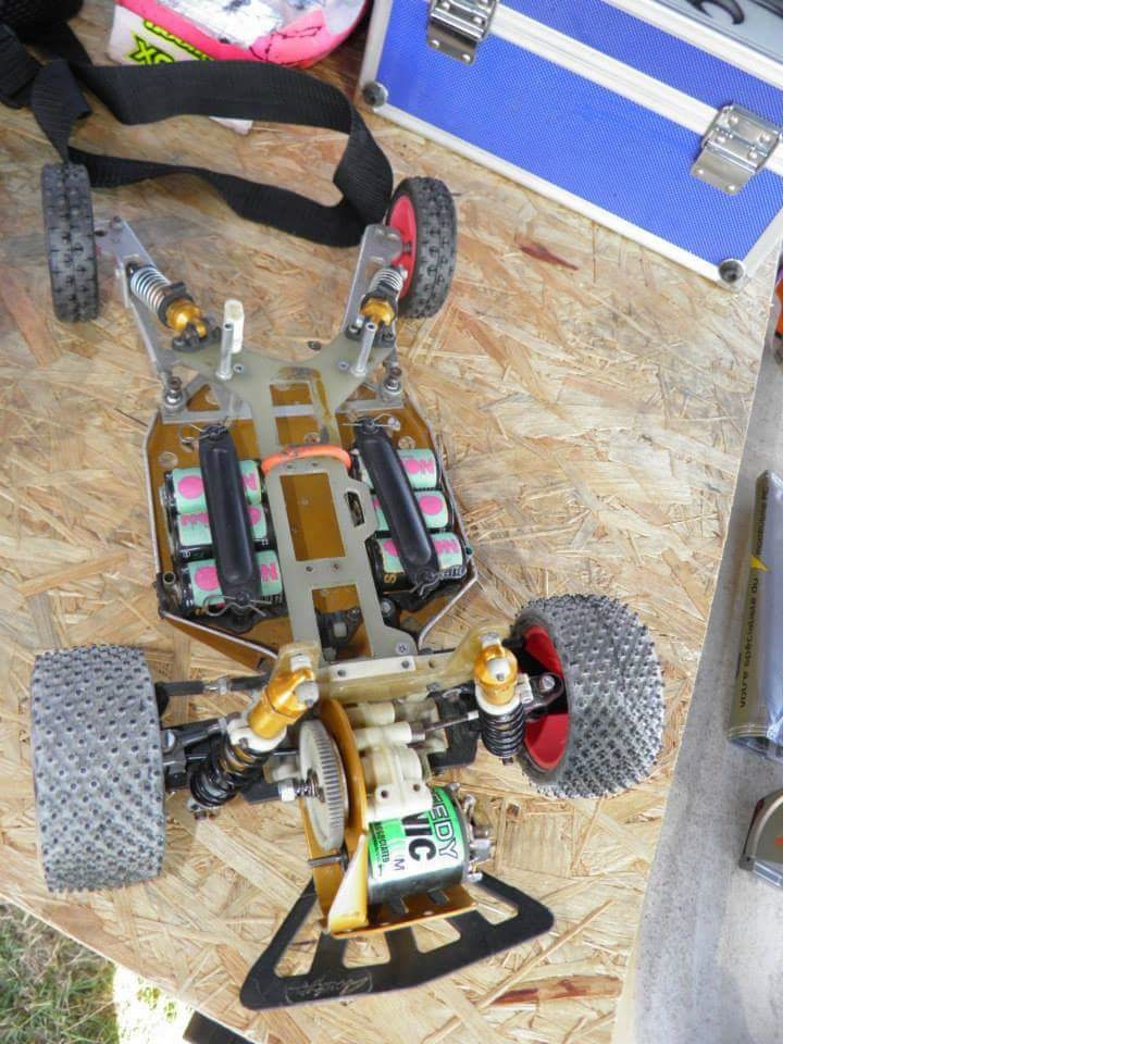

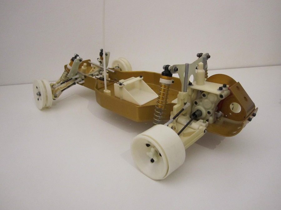

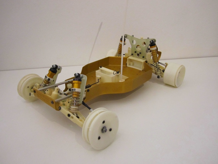

I will give it a try. This is going to be a slow one and i will use "the Postmans" prototype as some what a base, but with own diviations and solutions.
For example I will be using Kyosho Optima rere parts instead of Yokomo 870c parts for the front end.
I also found this interesting web page wich helps alot with some of the details.
http://www.rabbit-racing.jp/works.html
focusing on the RRT 1991 F-91

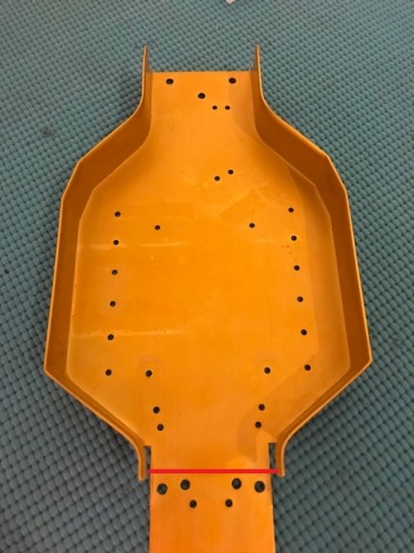

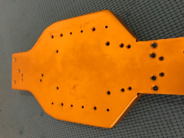

Here is the donor car.
For those who thinks that it's sacrilegious to cut this into bits and there after merging it with Kyosho part... well I'm sorry, but i'm going to do it.
Phin
Posts: 2817
Location: NY²
Has thanked: 87 times
Been thanked: 248 times
Re: RC10 FF
Post by Phin »
I'm not against the project itself but there are plenty of crappier tubs you can start with. :?

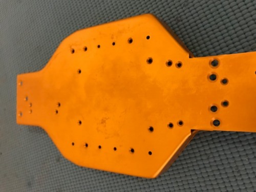

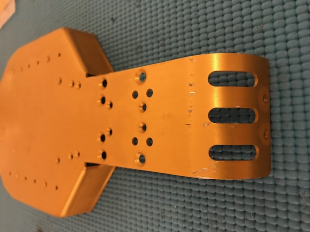

Well the chassis isn't flawless.
Gave it a wash in hot water and simple green.
Phin
Posts: 2817
Location: NY²
Re: RC10 FF
Post by Phin »
That's in very nice condition. It doesn't even have a servo access hole in it. :(
DennisM
Posts: 2405
Location: Denmark
Has thanked: 30 times
Been thanked: 62 times
Re: RC10 FF
Post by DennisM »
That chassis is going to fold like cardboard if You cut the sides of?

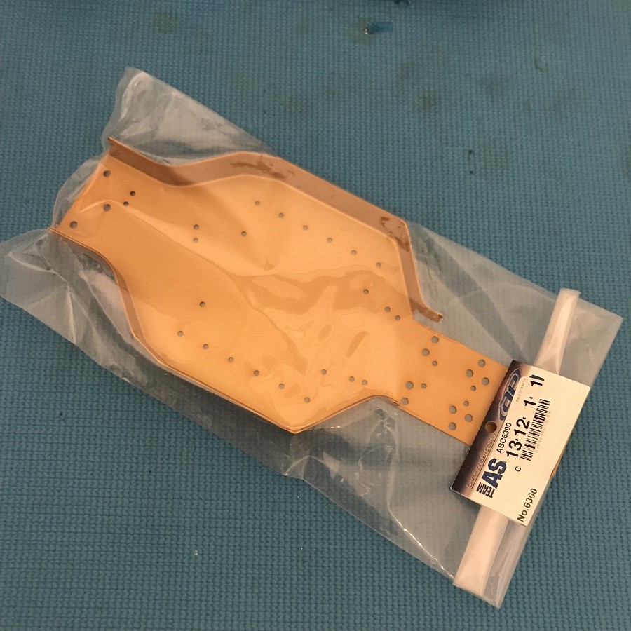

Phin wrote: Fri Feb 09, 2018 12:12 pm That's in very nice condition. It doesn't even have a servo access hole in it. :(
Ok, we'll see if I use it or not. A new #6300 is about 70-75$ shipped and I do not wish to use a scratched up one.

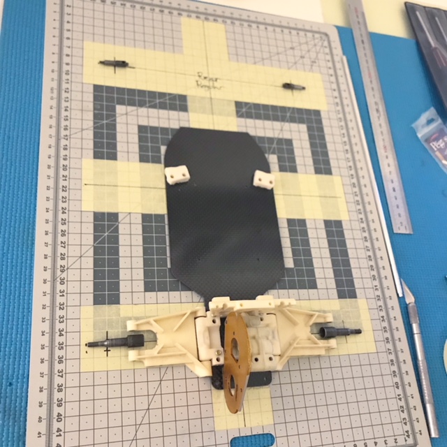

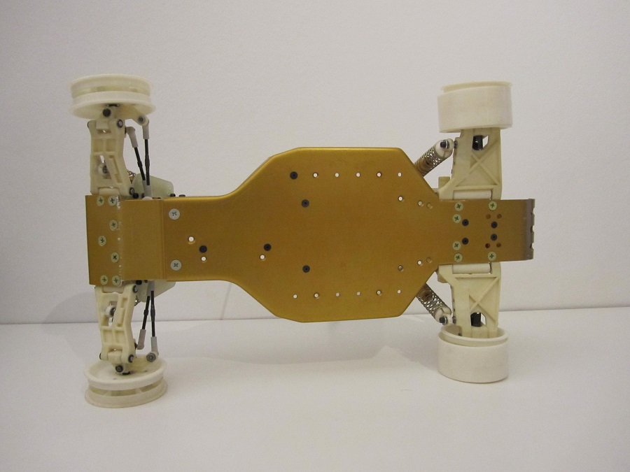

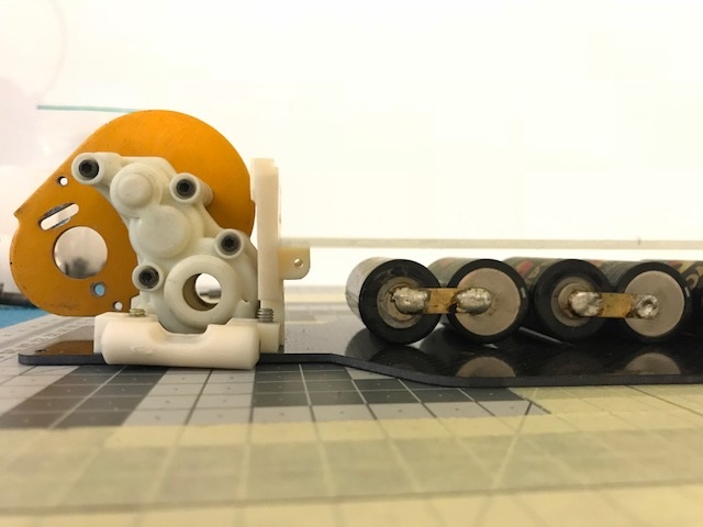

So I made a mockup graphite chassis just so i can figure how to go about it all.
I will not use the rear a-arms. They're only for reference.
My brain is hurting now. Time for beer

Asso_man! wrote: Sat Feb 10, 2018 11:51 am Good start! No front kick?
Thanks!
With a graphite chassis the kick up will be the 3 degree on the arm mounts.

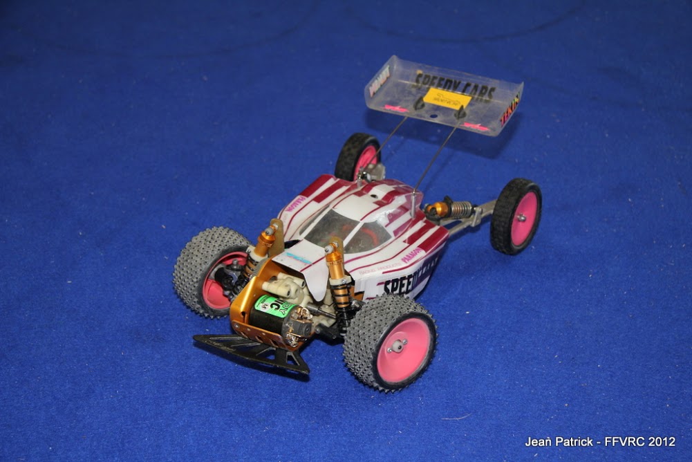

I have tried to see if "the Postman's" rc10 had a kick on his chassis, but i doesn't look like it. Looking att the rear guard and motor plate.
but it could be that he did what i'm thinking of.

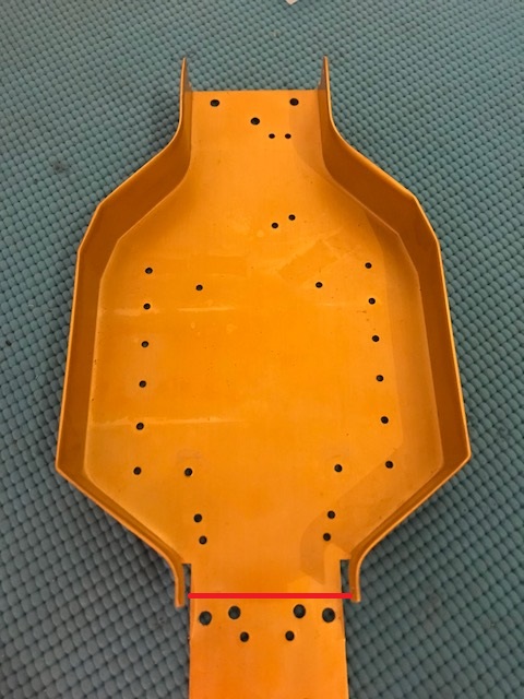

If to use gold pan chassi I would try to give it a bend just infront of the rear bulkhead. It might still be possible to use existing screw holes on the sides.
There will be a small angle differance for the top deck when doing this.

I listened to you guys.
I decided to save the old B stamped chassis and ordered a re-release chassis for this build. I will give a bit more time for parts to gather up before I start this one.

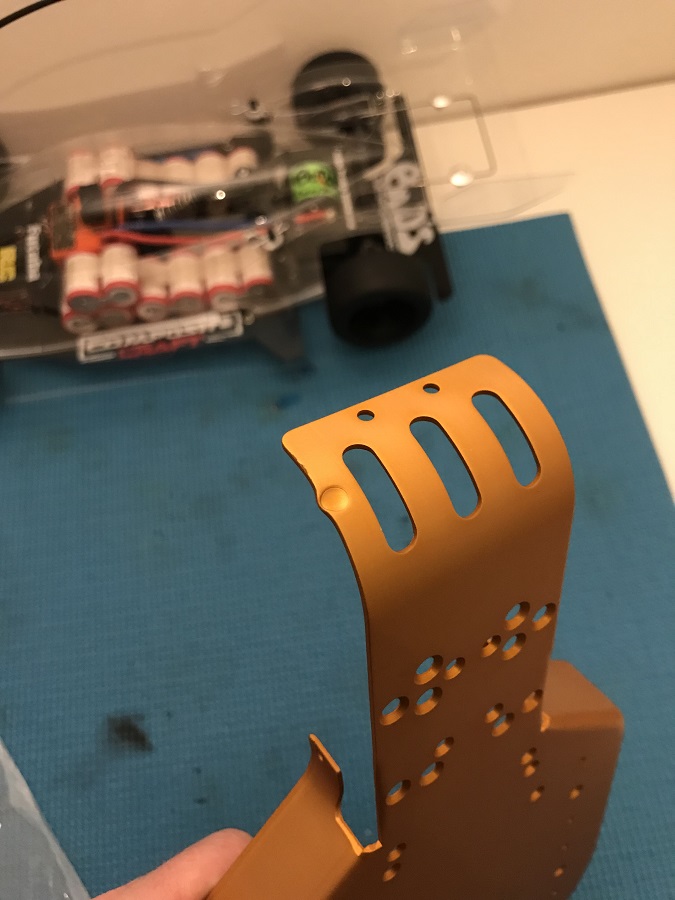

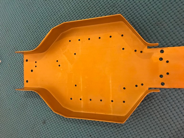

Post by sandkil »
Nice one AE!
Posts: 12353
Has thanked: 1133 times
Been thanked: 3930 times
Re: RC10 FF
doh! you should send them a pic. Might be worth a new chassis.
jwscab
Posts: 6583
Location: Chalfont, PA
Been thanked: 506 times
Re: RC10 FF
Post by jwscab »
ouch, for sure send them a pic of that, that was done in manufacturing.
