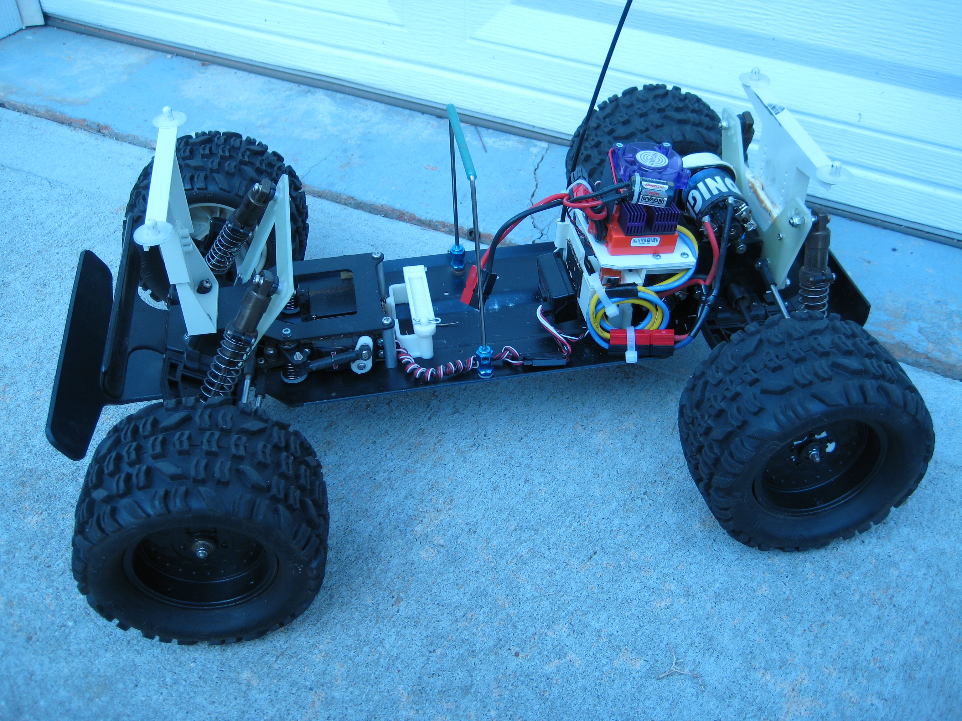

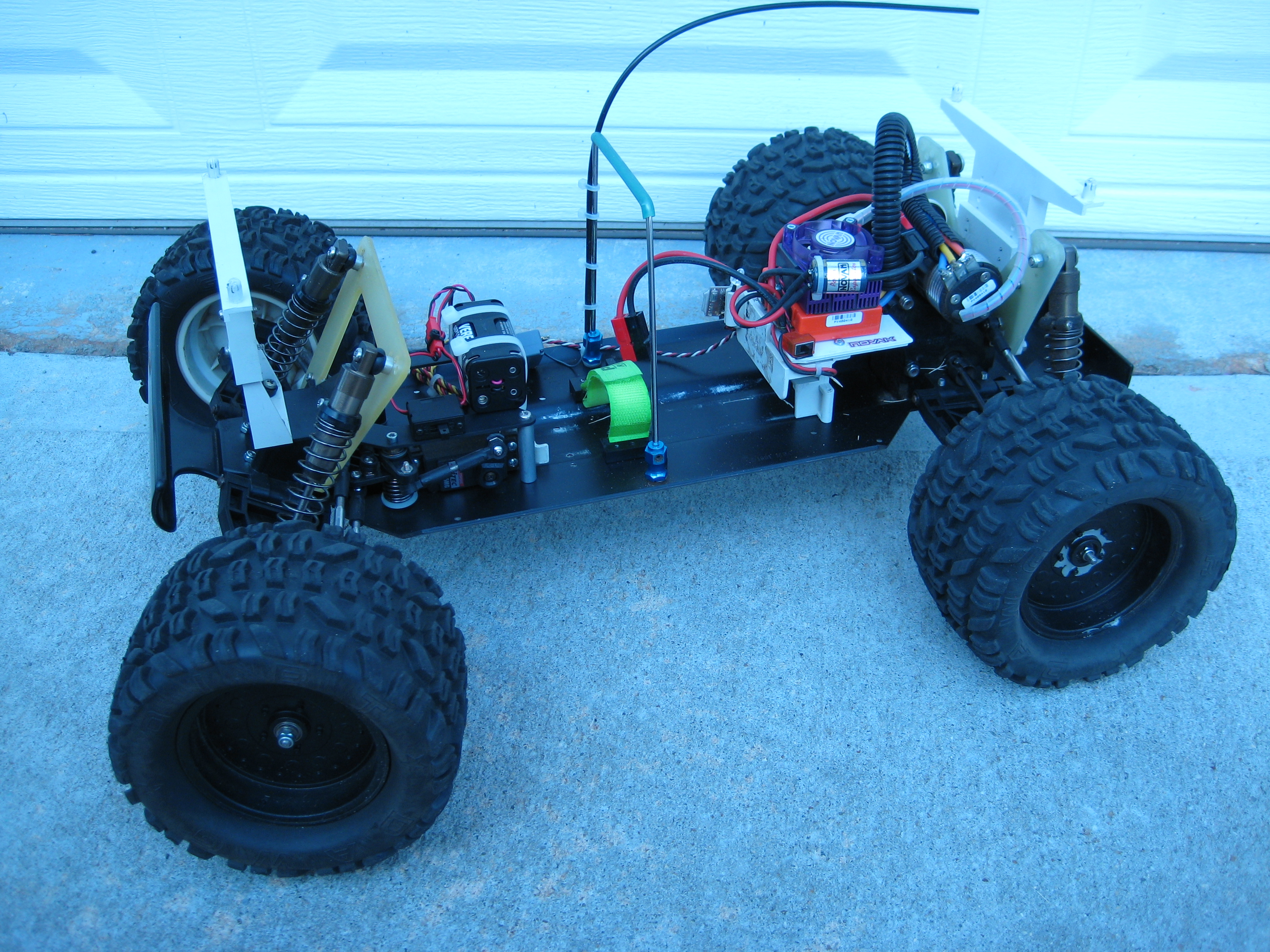

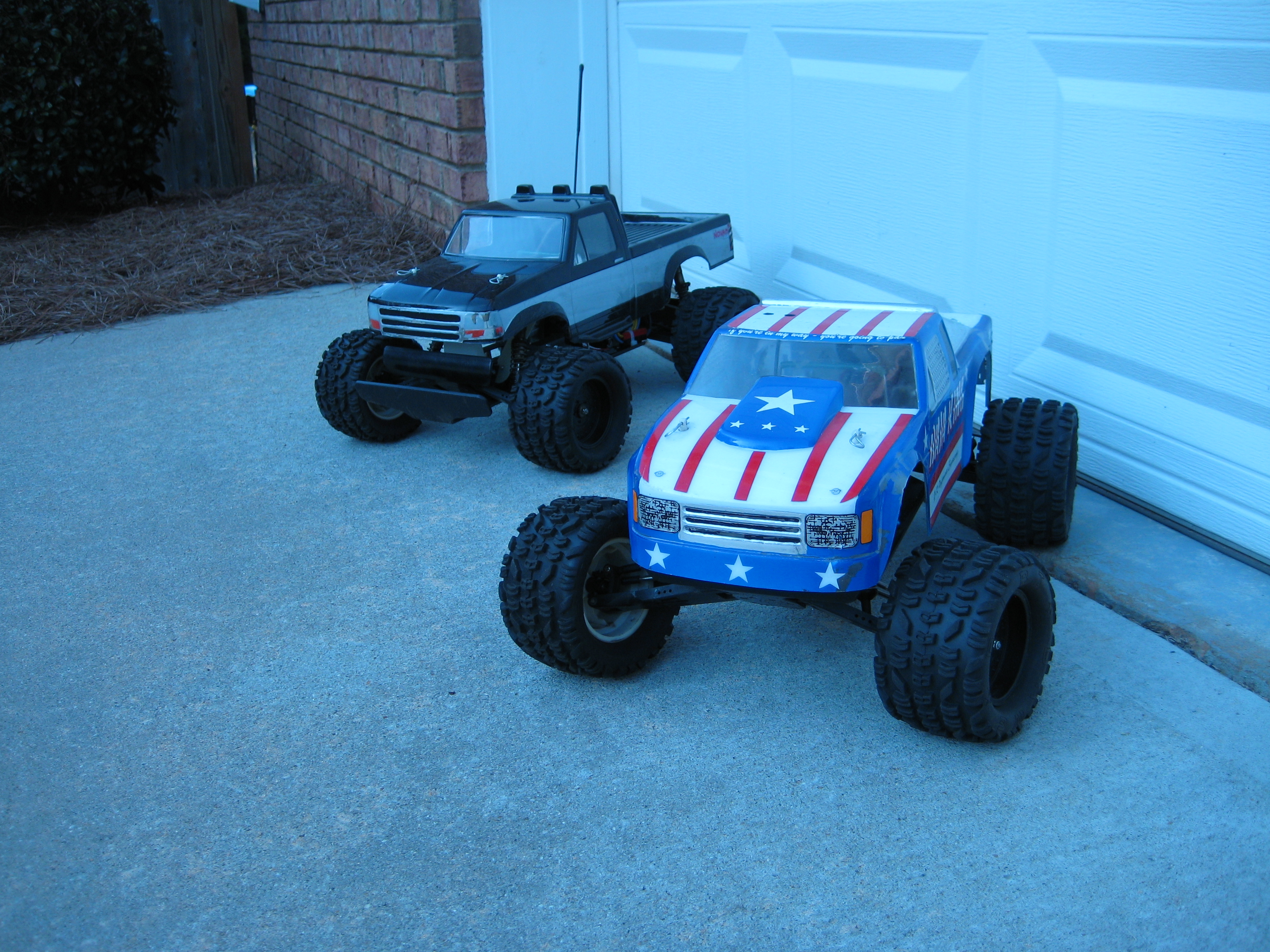

My son and I both have Thunder King runners. Well, mine is technically a Baja King, but they are the same truck as far as the chassis and running gear. The body-off shots show mine with the brushless. My son wanted twin motors on his, so he used the brushed Trinity Midnights. They both have the same Novak ESC, although I don't recall offhand which one it is (The trucks are not with me right now). I run a 3S LiPo on mine and it's ridiculous and an absolute terror to drive. It's way too fast and handles like a turd due to me locking the diff.
The diffs are a potential problem area on the World Scale trucks. They are tough to keep tight if you run them for any amount of time and / or with any sort of power. On mine at first, with the brushless/3S setup, I ended up having to use JB Weld to lock the diff. I then found a product made by RC4WD that is a 1-peice steel diff gear. This was years go and they no longer make them. My son's doesn't suffer as much from this since he's running stock-ish motors and 6-cell/2S batteries.
