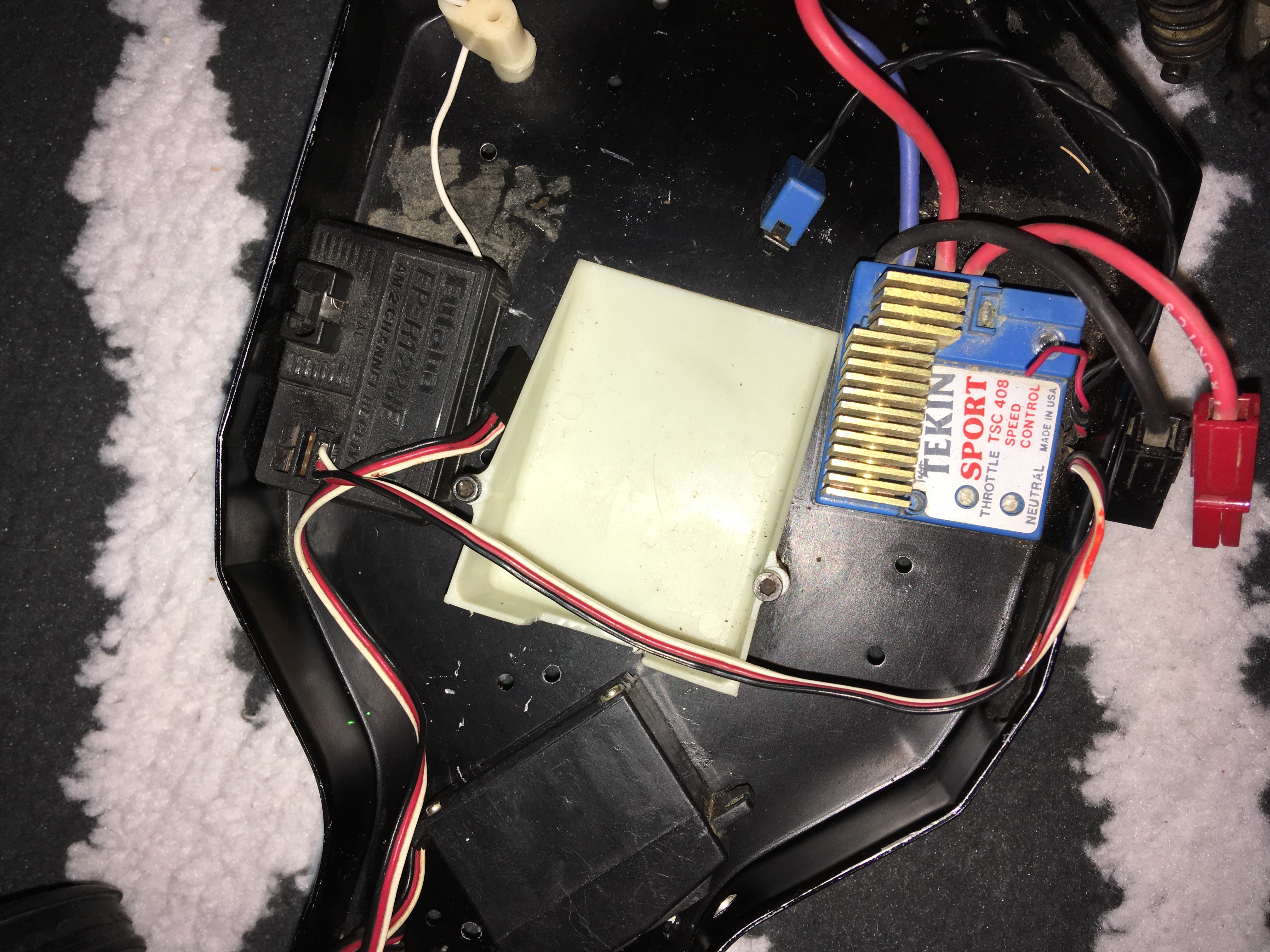

I’m looking to plug a motor into my rc10 and drive! I have the old green and silver Team motor but that thing was stupid slow 20 years ago! I included a shot of my esc so you don’t recommend something that will fry my stuff. I’m thinking something along the lines of a 14-17 turn (if my recollections of motor speeds are accurate).

yes, something around 15-16 turns would be pretty nice. The issue is that you need to find a brushed motor that is still in good shape or still available. There are hardly any brushed motor manufacturers for r/c application as the industry has moved toward brushless systems. Plenty of stock type or higher turn motors are around but mostly for rock crawler (slow/torque).
your best bet is probably ebay for a brushed motor.
for about the price of an old brushed modified motor, I use this system:
https://hobbyking.com/en_us/trackstar-roar-approved-1-10th-stock-class-brushless-esc-and-motor-combo-17-5t.html
it runs pretty well, certainly fast enough to break parts, but you could use a hotter motor also:
https://hobbyking.com/en_us/trackstar-roar-approved-1-10th-stock-class-brushless-esc-and-motor-combo-13-5t.html
either I think would be a good alternative.
