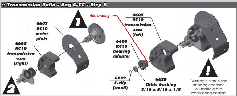

I have also been adding an extra bearing on the top shaft.
I put it on the inside of the 6605 bearing adapter. A little more stability on the top shaft and acts as a spacer to help remove endplay in top shaft.
I've also been using the outdrive bearing mod, adding a bearing where the original 6633 felt is positioned.
All bearings degreased and then oiled.
At one time fewer bearings (less friction) was a big deal. 4 minutes with 1200-1400 mah was tough. No longer.
My recent trans have 11 bearings and spin easily.
Keeping a good alignment at the most critical stress points, I feel, outweighs the slight frictional losses.
Just my take.
Chuck
Just my take.
Chuck
