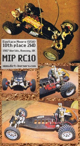

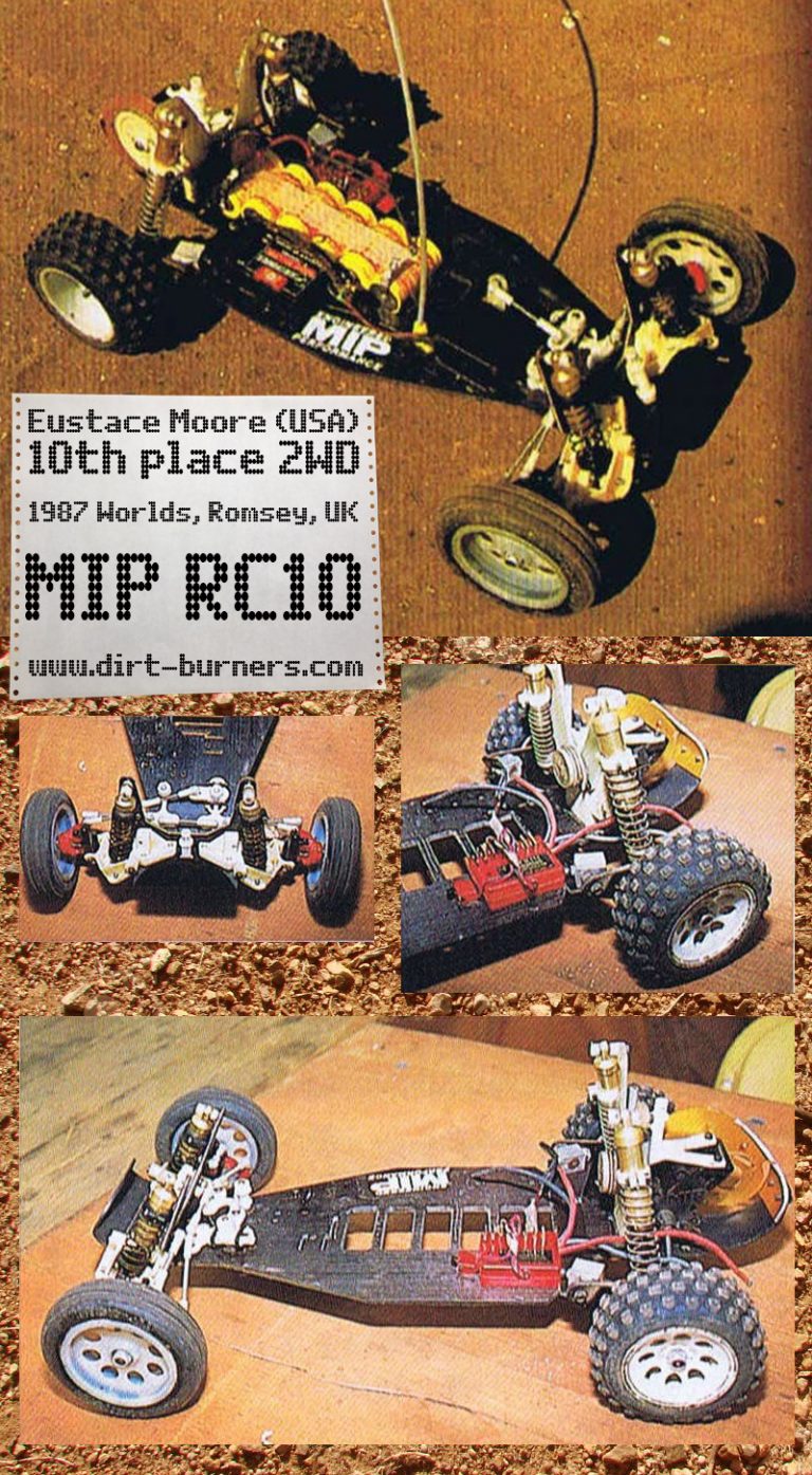

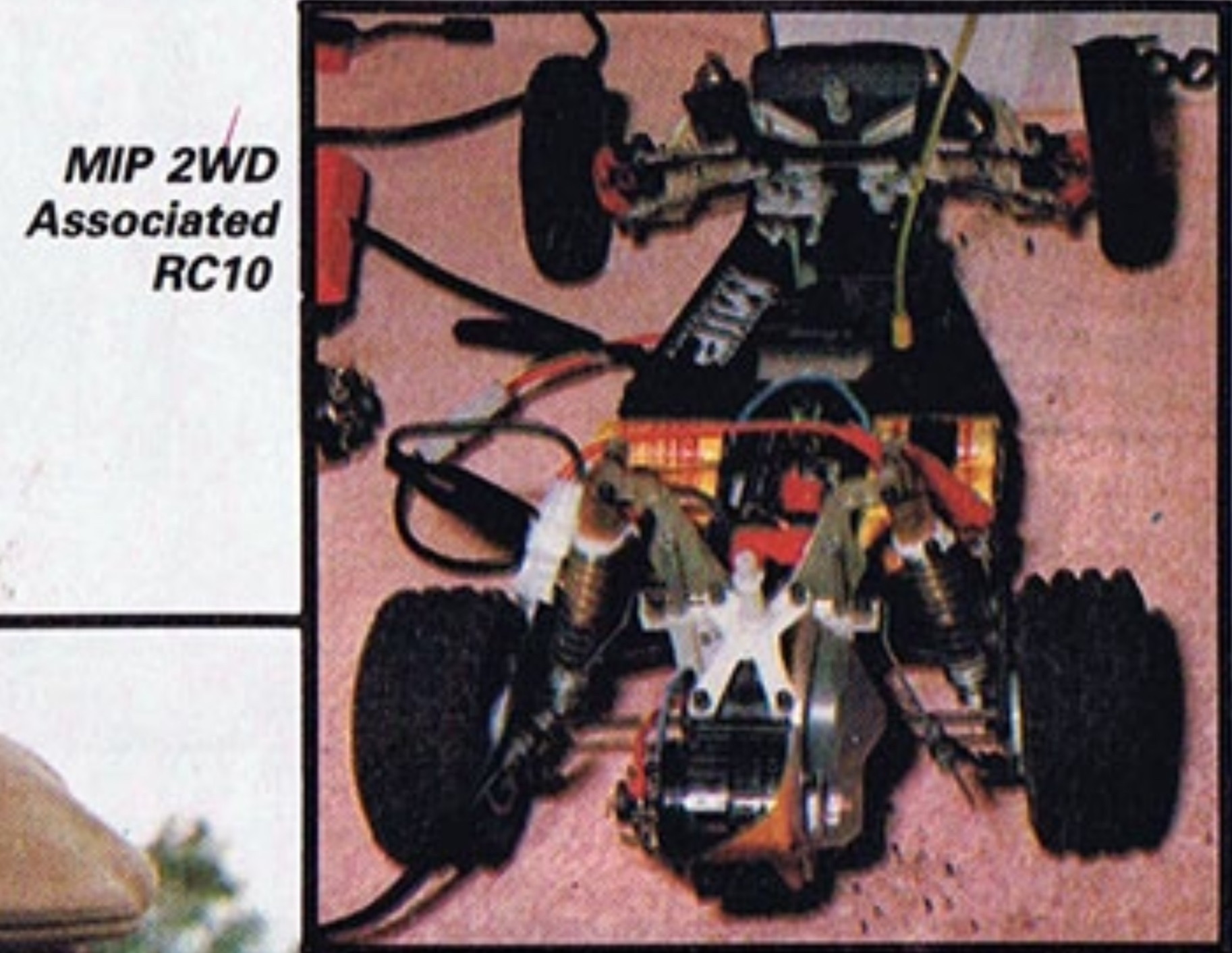

I have been doing a lot more searching for inspiration and finally found some images of the 1987 world event ( thanks to dirt-burners).
I found a blurry photo of what I think is mike christensens’s MIP RC10 that was 4th which looks very special and so I am going to try and make a replica of that car for the up coming vintage race.
From looking at the photo I think the car has the following parts on it but I want to check with the rc10 community to see if I am on the right path.
saddle pack chassis (composite craft I believe)
Rc10 front end using short arms
RC10 steering System
Custom carbon front shock tower
black caster blocks.
Special red steering knuckles that appears to widen the car.
Novak Speed controller in between saddle
Black (carbon parts were listed as an option) parts for the IRS-10 system but a fibre glass shock tower.
Black MIP 3 gear gear box - this is better shown in the photo of Moore’s 1987 car (But it had inline batteries rather than saddles).
This photo also shows that they were using the option house rear tires, Mike ran proline fronts while mr MIP ran tamiya (fax?)
Cutdown white gearbox brace
Narrow rear chassis guard attached to the cut down motor plate
Custom rear sway bar
Turned down body mounts
I have no idea of the body shell or paint scheme - if anyone has any ideas they would be gratefully received.

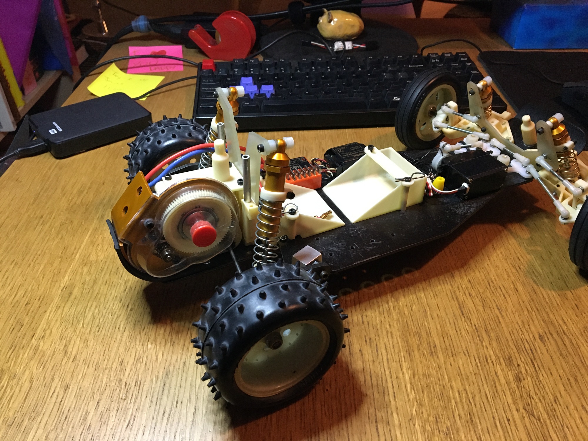

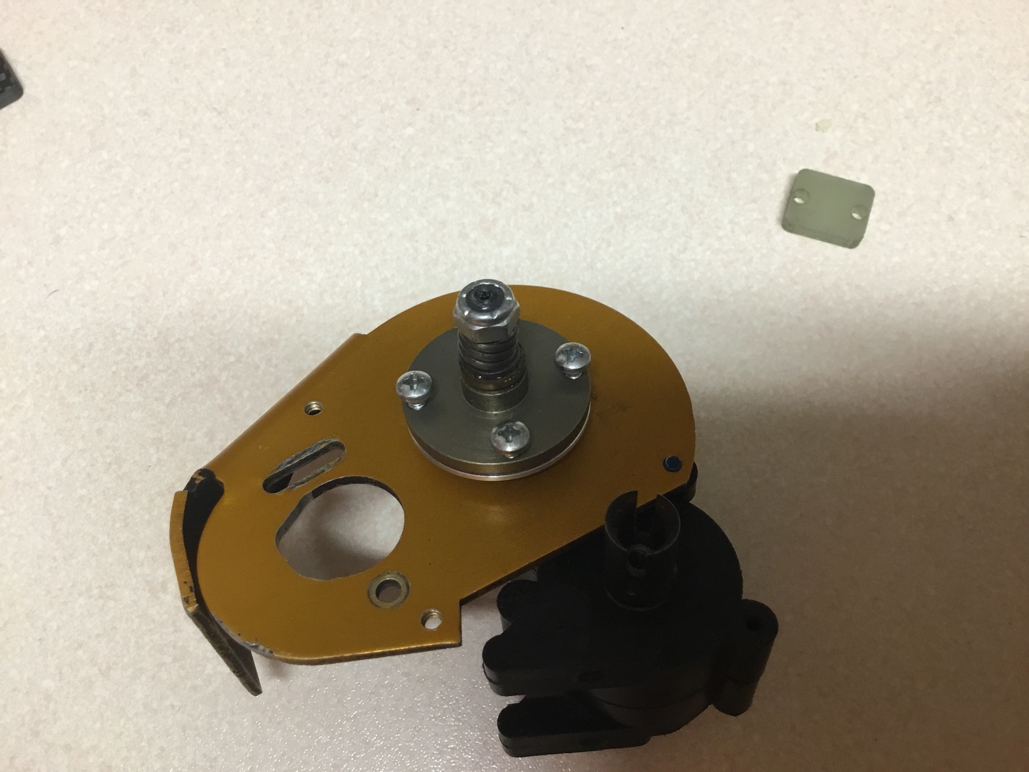

So I have started the compiling of all the parts for the build.
The 3 gear box looks okay - it has had a life racing but still seems free. In my youth I painted some of the motor plate flat black (I am not sure why) so I will have to remove that and give it a proper cut. I had also used some factory team blue screws to hold it together and install an A&L power clutch on it (whIch I i think I will leave on as I can’t find the original spur mount).

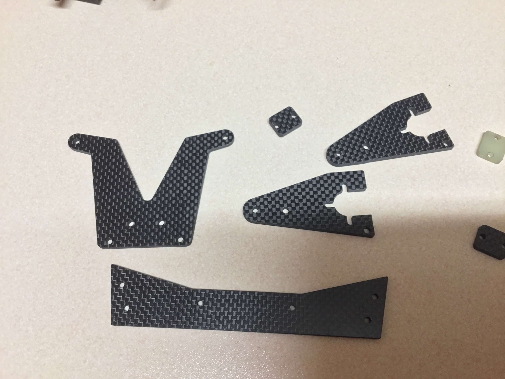

I have had the parts of the IRS made in carbon fibre (same thickness) including the rear shock tower which won’t be put on this car.
All I need for the rear end is a set of axles - I would like to use a set of universals (I remember the dogbones coming out when I ran it once and looking for ages to find the bits (spring was never found). As the photos of the car show them running with kyosho rims on the back, I am wondering if a hex was fitted to the stand associated axles or whether the bearing housing was modified to hold metric bearings to allow for kyosho axles to be run.
The chassis is looking a bit worse for wear as it was my race car for a few years. It was run with a stealth and with a 6 gear in a mid mount configuration for velodrome racing (Tried It on a track like that once - didn’t like it - who would have thought) and had a steering screw pull through so had been repaired which epoxy. But I think it can be saved.

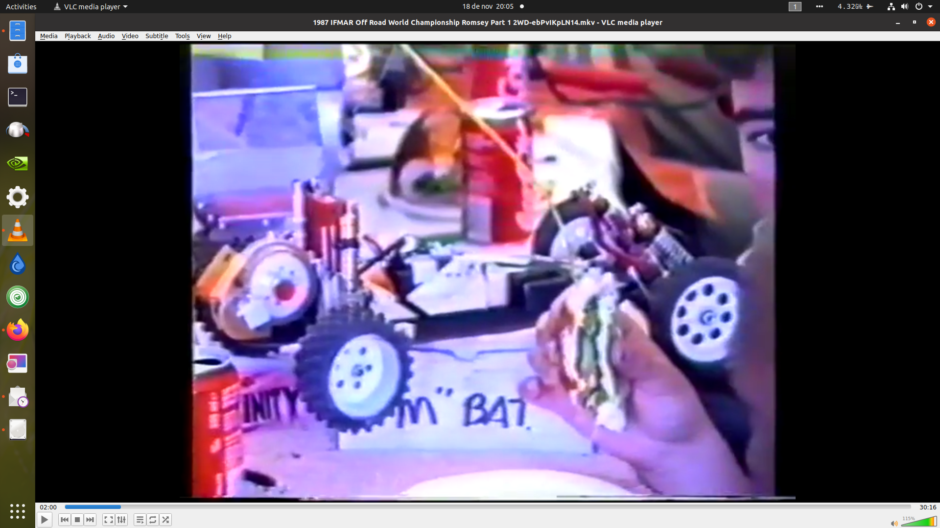

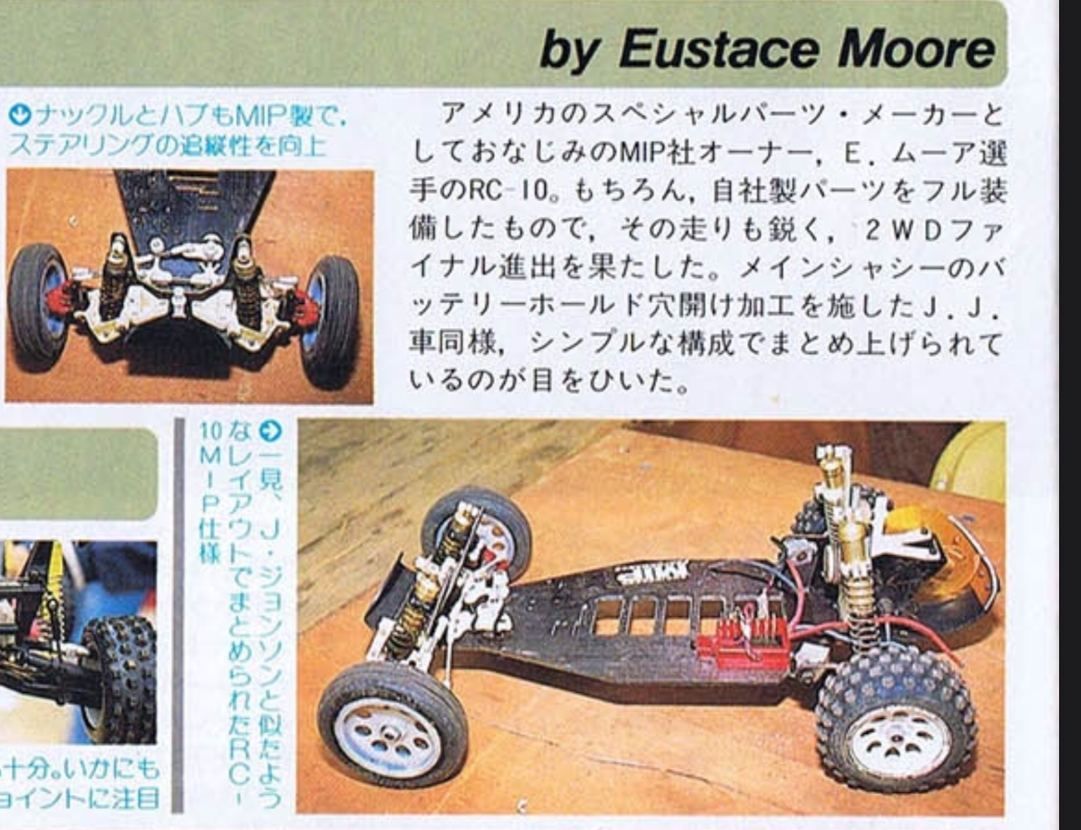

I think that both cars that you posted photos off are in fact Eustace Moores car, or a spare car just that in one he is trying a saddle pack config. The only thing I cant explain is the sticker jumping sides.
I think this is Mike Christiensens car from that race.

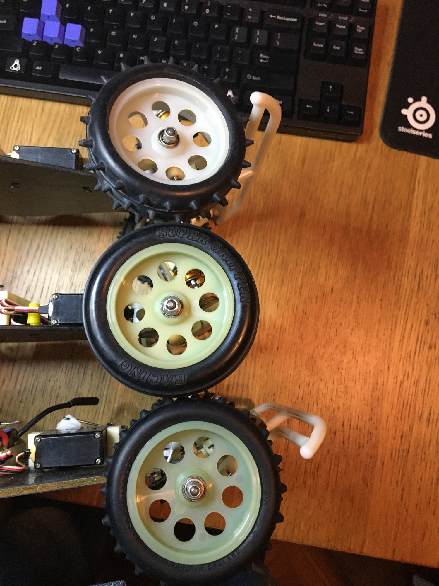

I think the front wheels are CRP 4111 fox front wheels. They where available in white and various shades of green tint.
Here on Eustace Moore’s car.
jwscab
Posts: 6580
Location: Chalfont, PA
Been thanked: 505 times
Re: Information request re modified RC10s that made “big” finals
Post by jwscab »
Possibly and probably. Looking close it looks like there is no outer bearing in place either.
