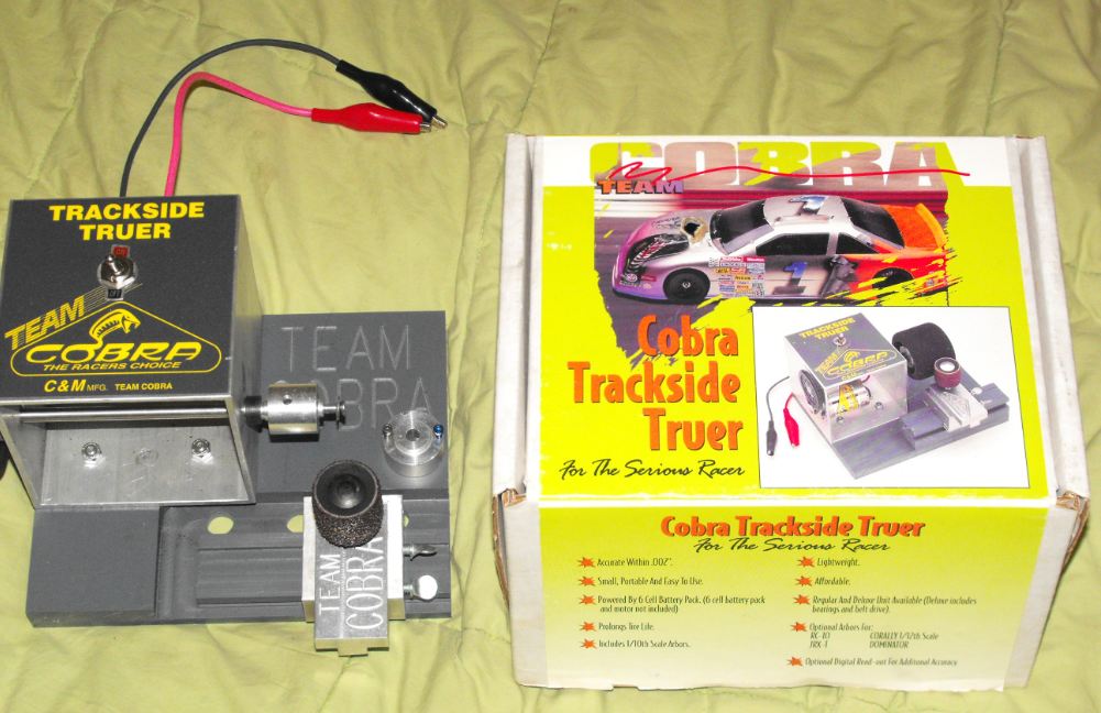

I bought one of these sometime within the past 2-3 years ( :roll: ) and never had time to use it. I'm now gearing up to mount and true a plethora of foam tires for pan cars, gear box cars and 1/14 - 1/18 scale oval racers, so I'm trying to set this thing up. I'm not new to lathes or truing RC tires, but this thing came with about 5 different arbors for various wheels, and I have no idea what each may or may not be for. I realize that it will be impossible to tell what they are for without photos, so I'll try to remember to upload some soon. But in the meantime, does anyone have experience with this truer, or better yet, have a scan/photo of the manual? Thanks for sharing any knowledge!
Here's a Google pic for attention, until I upload more.
Matt

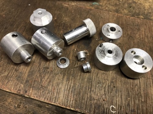

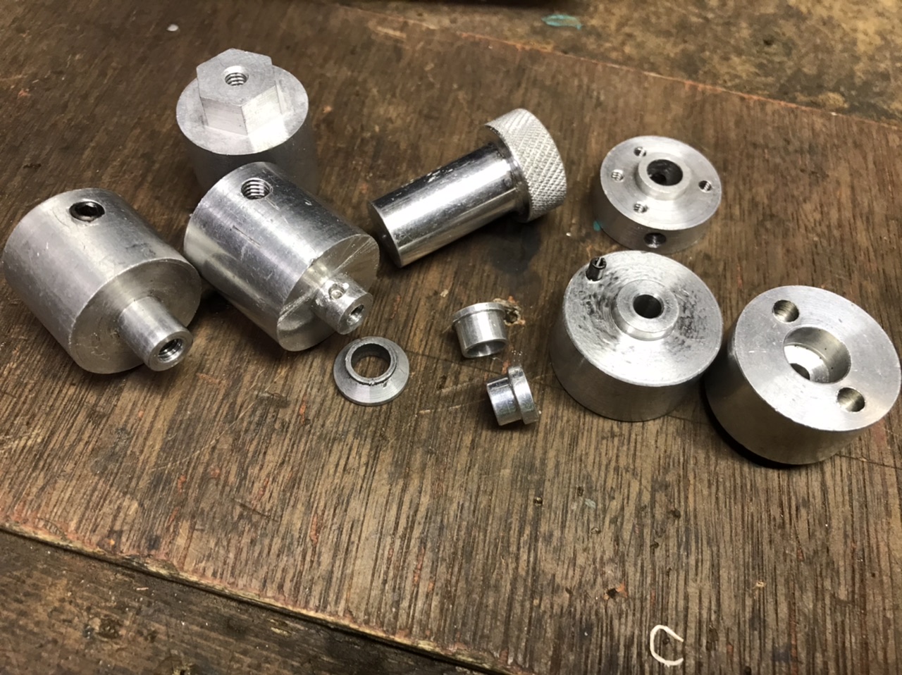

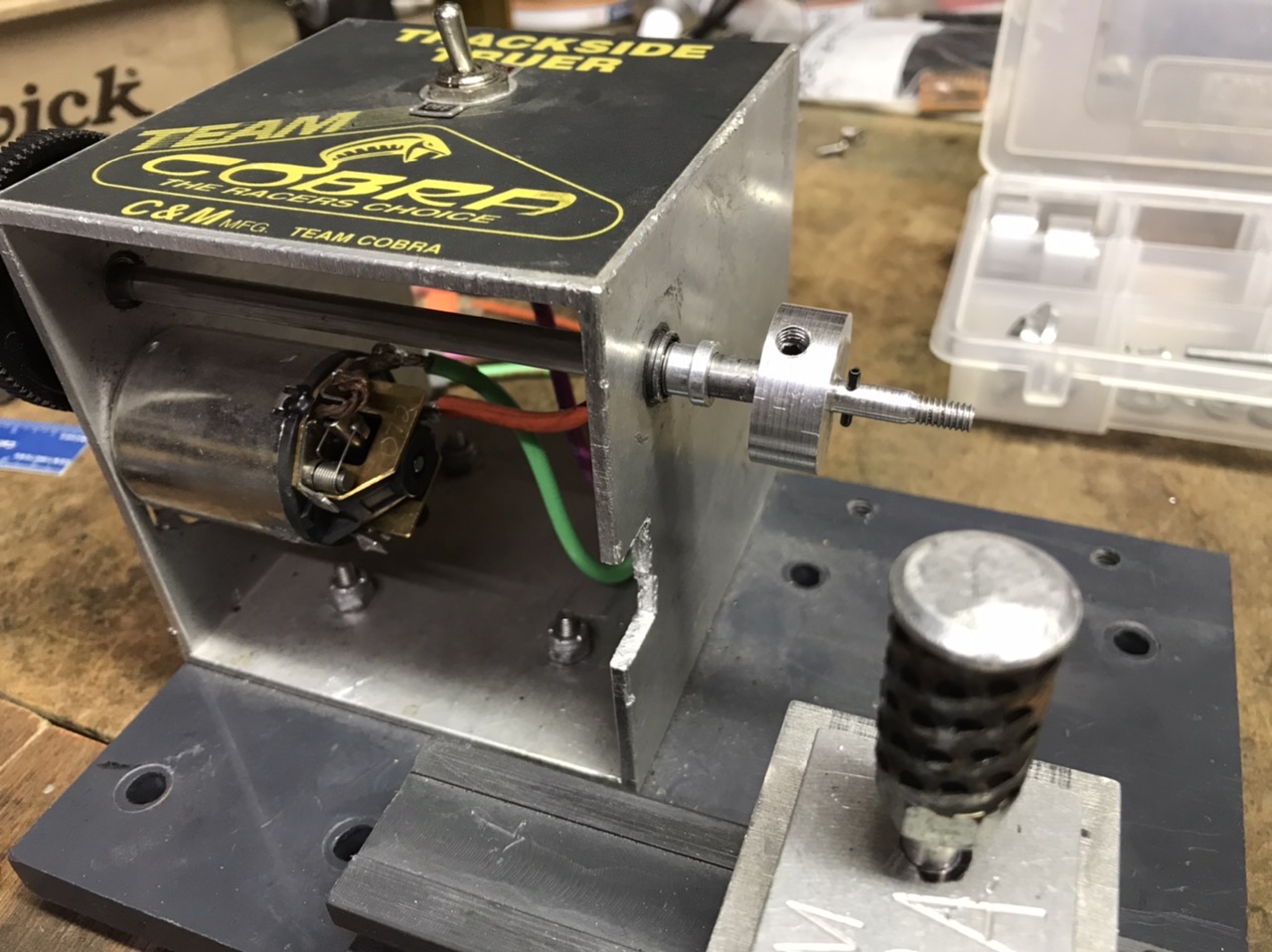

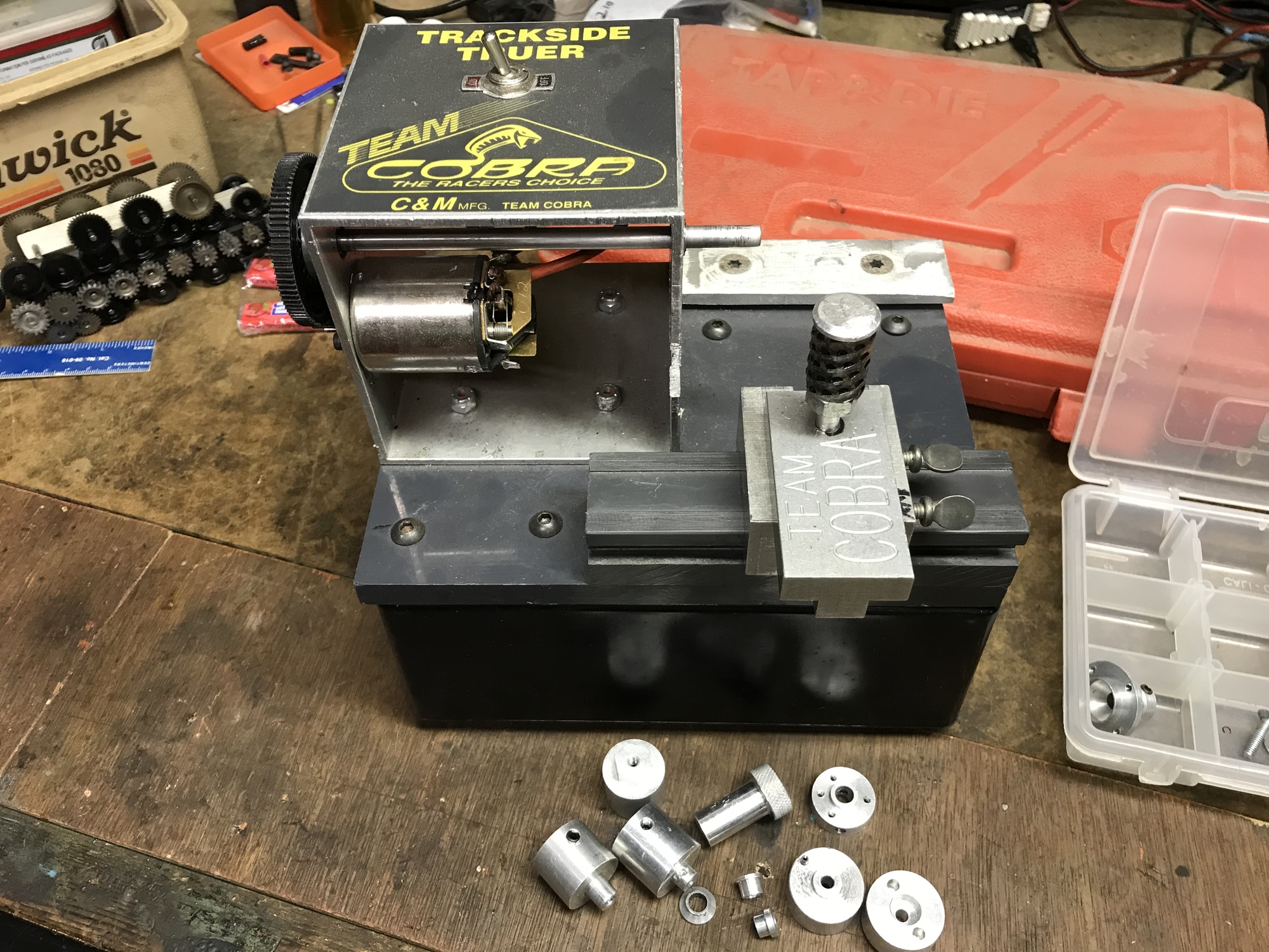

Here are actual photos of mine, along with all the arbors. I’m guessing they’re just for various wheels, I just can’t figure out what wheels may fit some of them. Many tires that I’ll be needing to true are on pin drive rear wheels. The only way I see to attach them is to just tightly screw them to any of the threaded arbors. Am I missing anything?
Matt

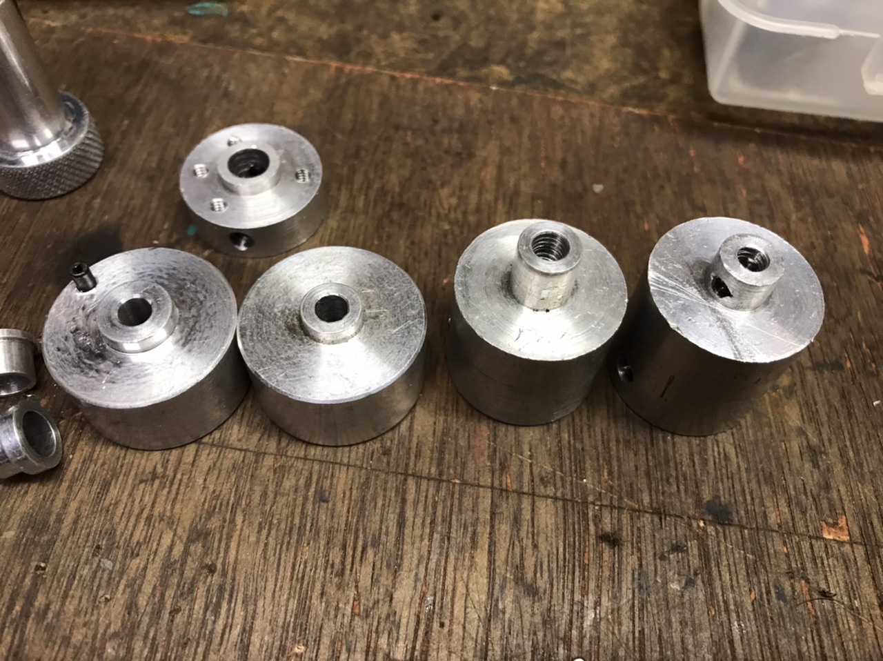

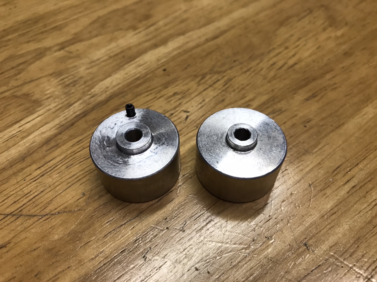

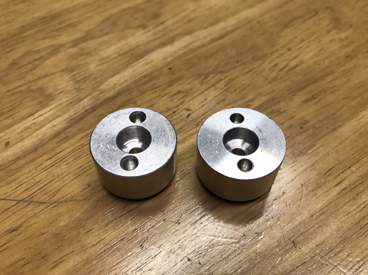

These are the two arbors/adapters that I just can’t figure out. They are the same, except that one has a roll pin and the little "hubs" protruding out the one side are different diameters. Anyone have any ideas what these are for and how to use them?

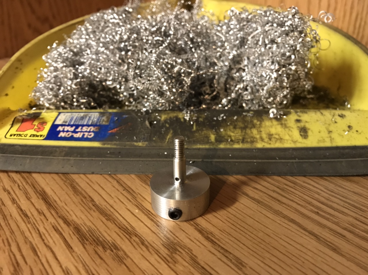

I also started on my pin drive, rear wheel arbor last night.
Matt

If I were a betting man, my guess would be 1/12 and 1/10 front for the one without a pin, and the other for 1/12 rears. The diameter of the hubs would be 5/16 for a front 1/12 and 1/10 wheel, and 1/4” for rear 1/12

On my Cobra tire truers, I always use arbors with pins for both front and rear pan car tires. The pins can be placed against the inside "spokes" of front wheels and into the mounting screw holes of rear wheels. The pins prevent the arbors from slipping inside the wheels (thereby preventing damage to the wheels' bearing holes and hubcentricity).

That makes sense. Thanks for the info. I think that the two opposing, partial depth holes on each of those arbors was throwing me off. I assumed that they were for function, such as for clearance over top of screw heads. But maybe they are just for weight reduction/aesthetics.

matt1ptkn wrote: Tue Oct 06, 2020 9:21 am That makes sense. Thanks for the info. I think that the two opposing, partial depth holes on each of those arbors was throwing me off. I assumed that they were for function, such as for clearance over top of screw heads. But maybe they are just for weight reduction/aesthetics.
The holes in those arbors are for function. At least they are on the Cobra Tire Lathe, anyway.

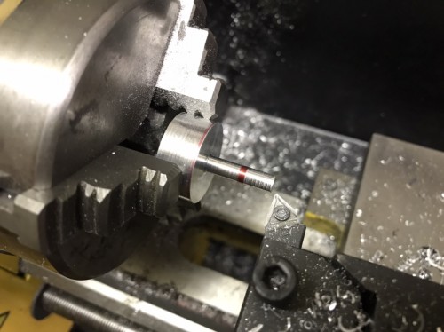

I don’t have any knowledge about the tire lathe. :oops: But after a little turning, I did nearly finish my pin drive arbor. :mrgreen:
