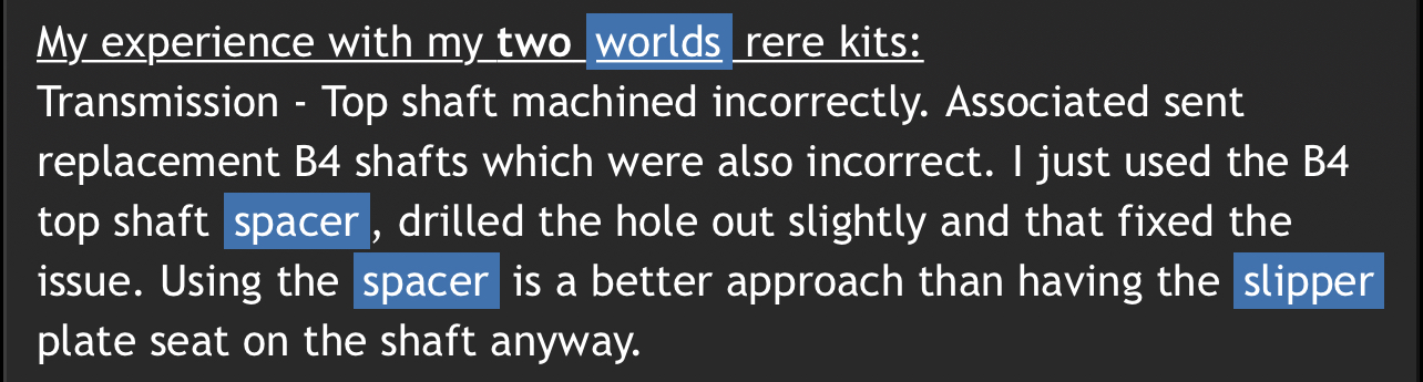

When assembling the Stealth transmission, I'm now noticing the inner "slipper hub" (#7485) on the spur gear is rubbing the aluminum motor plate. Soon as I slide the slipper hub onto the top shaft, the slipper hub pretty much rests tight against the aluminum motor plate. I've disassembled/reassembled the transmission multiple times now and everything looks fine inside.
I'm assuming the there should be a gap between the slipper hub and plate, right?

Uh oh, that's going to be a fun one. Might get in touch with Associated about that one. There was a bad batch of top shafts, which you could make work if there is no option, but people are asking $40 for those things on ebay as they are hard to come by now.

Another option is to use the b4 spacer and that will require drilling out the case to clear it, then the slipper backplate is setting against the spacer (which is better) instead of relying on the flat spots. Part number is 9602 and they seem to still be around

Will likely do the B4 spacer. So I assume the drilling is just enlarging the top shaft hole from the outside so the spacer can fit between the case and the backplate?

You are enlarging the hole so the spacer can fit between the bearing and the hub. Just want to make sure it doesn’t rub is all. I use a tapered reamer or a stepped drill bit

I don't believe the b4 spacer is long enough to actually fix the problem. It fits inside the case on a b4 to shim the top shaft. Not to support the slipper hub. Be better off buying 3/16 i.d. tubing and cutting it the length you need.

This would be a better idea as it can be tuned, but I’ve seen a few people recommend that the b4 spacer be used. Essentially you are flipping the position of the bearing but the thickness of the stack of components is the same of set side by side.
