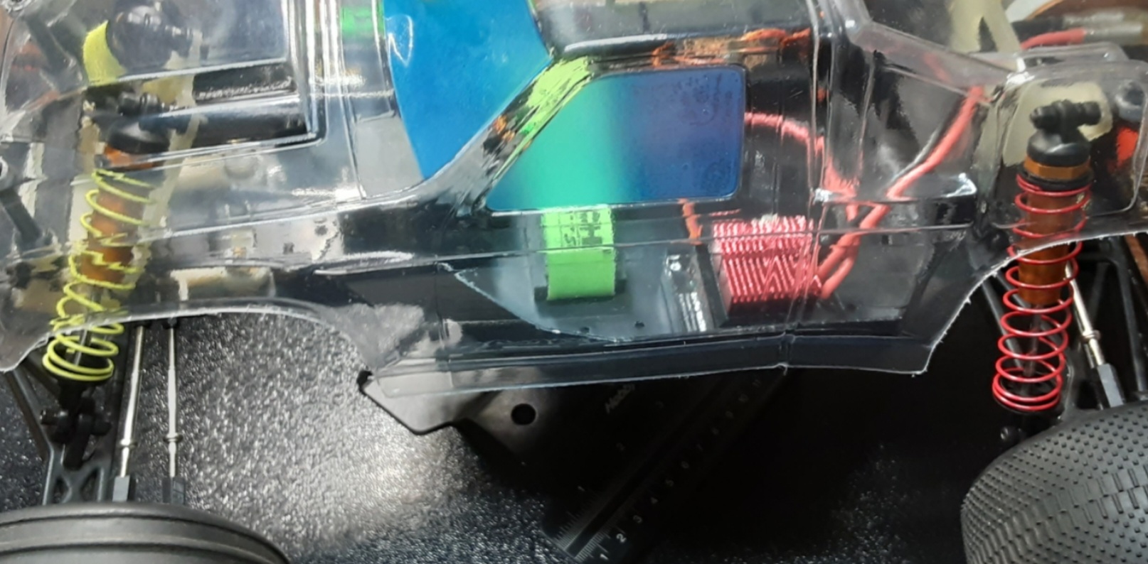

This is mostly Traxxas parts on AE bodies. The front springs are Duratrax but the rear springs, locators, and cups are Traxxas.

juicedcoupe wrote: Sun May 15, 2022 5:31 am This is mostly Traxxas parts on AE bodies. The front springs are Duratrax but the rear springs, locators, and cups are Traxxas. Screenshot_20220515-042808_Samsung Internet.jpg
Thanks. That helps since the associated parts are hard to find at original prices.
