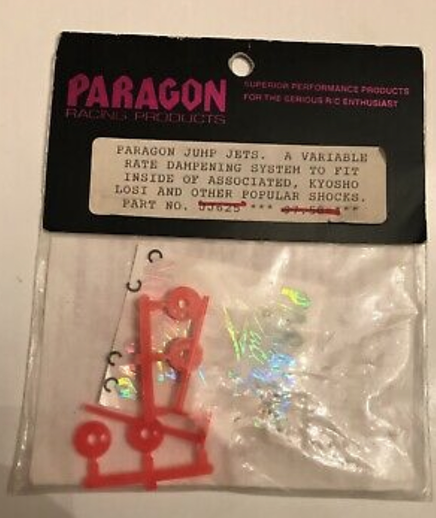

Ok, Thanks guys. I found these in a few shocks. Obviously aftermarket. Anyone know what these are?

Re: Shocks, pistons, and oil. Oh my.
I don't know, but I have a set of the pink ones.
Posts: 12335
Been thanked: 3917 times
Looks like rpm two stage shock pistons.

GoMachV wrote: Wed Mar 03, 2021 3:29 pm Looks like rpm two stage shock pistons.
The blue ones look like RPM but the pink ones look different. Is the pin tapered, and does it fully seat when the shock compresses?
Posts: 3535
Has thanked: 268 times
Been thanked: 2094 times
Faux4x4 wrote: Wed Mar 03, 2021 4:47 pm
Yes, and yes.
Post by jwscab »
Jump jets! Those were known as jump jets.
Posts: 12335
Yup, jump jets. I didn’t even notice those pink ones.

Post by K-TOWN-KITT »
Of course this guy has a new set in the pack. 8)
Just a stock pic. I actually don’t have those
There's a set on Ebay for $20.
I have two sets, and don't particularly like them. I don't know, maybe if I spent more time with them.
I get the idea in theory just not in the application. I would think it would get jammed, float around, or break in the shock. Got to love the early ideas and mods. Are the RPM pistons worth trying out? Better for a buggy or truck.
