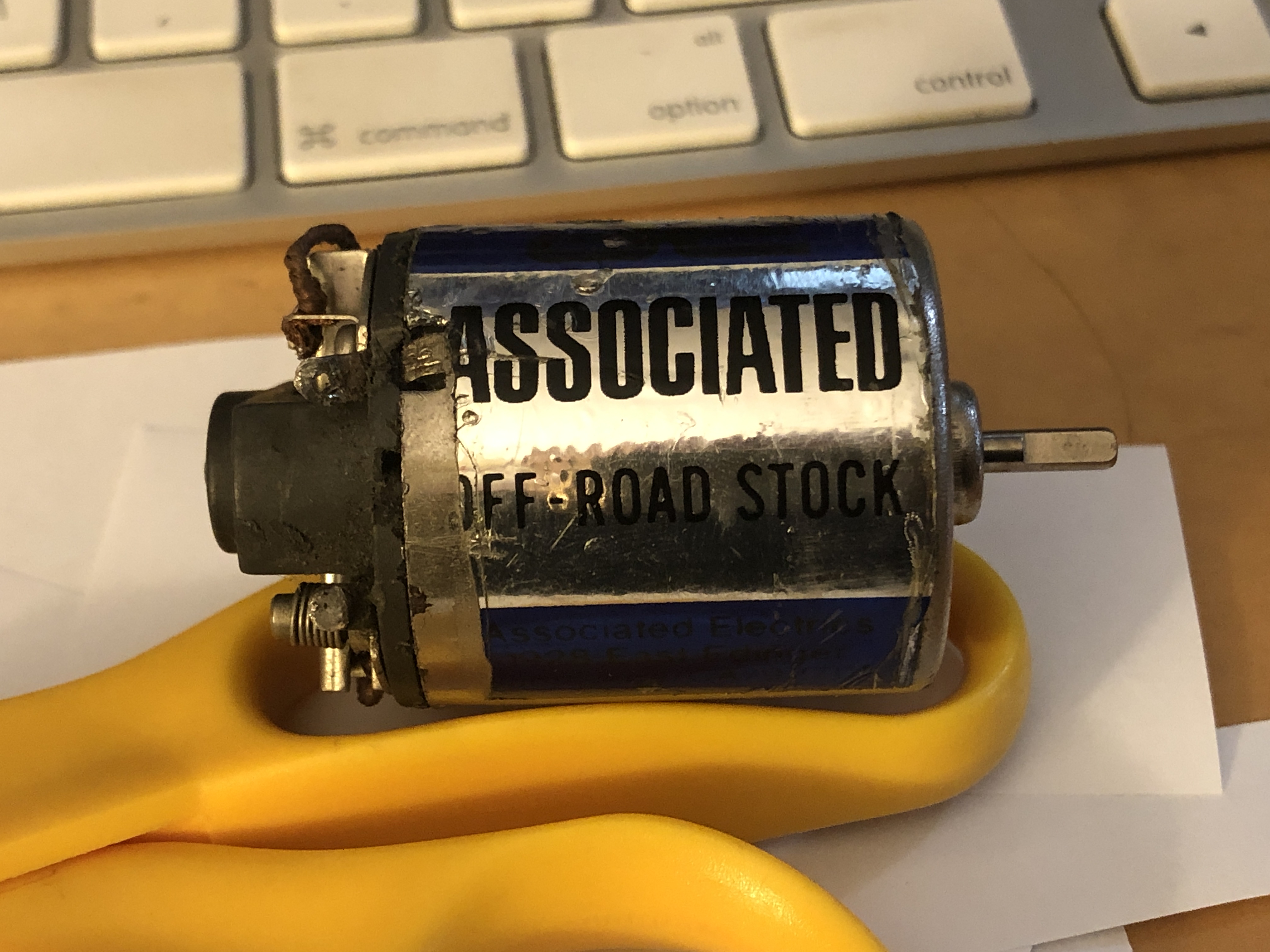

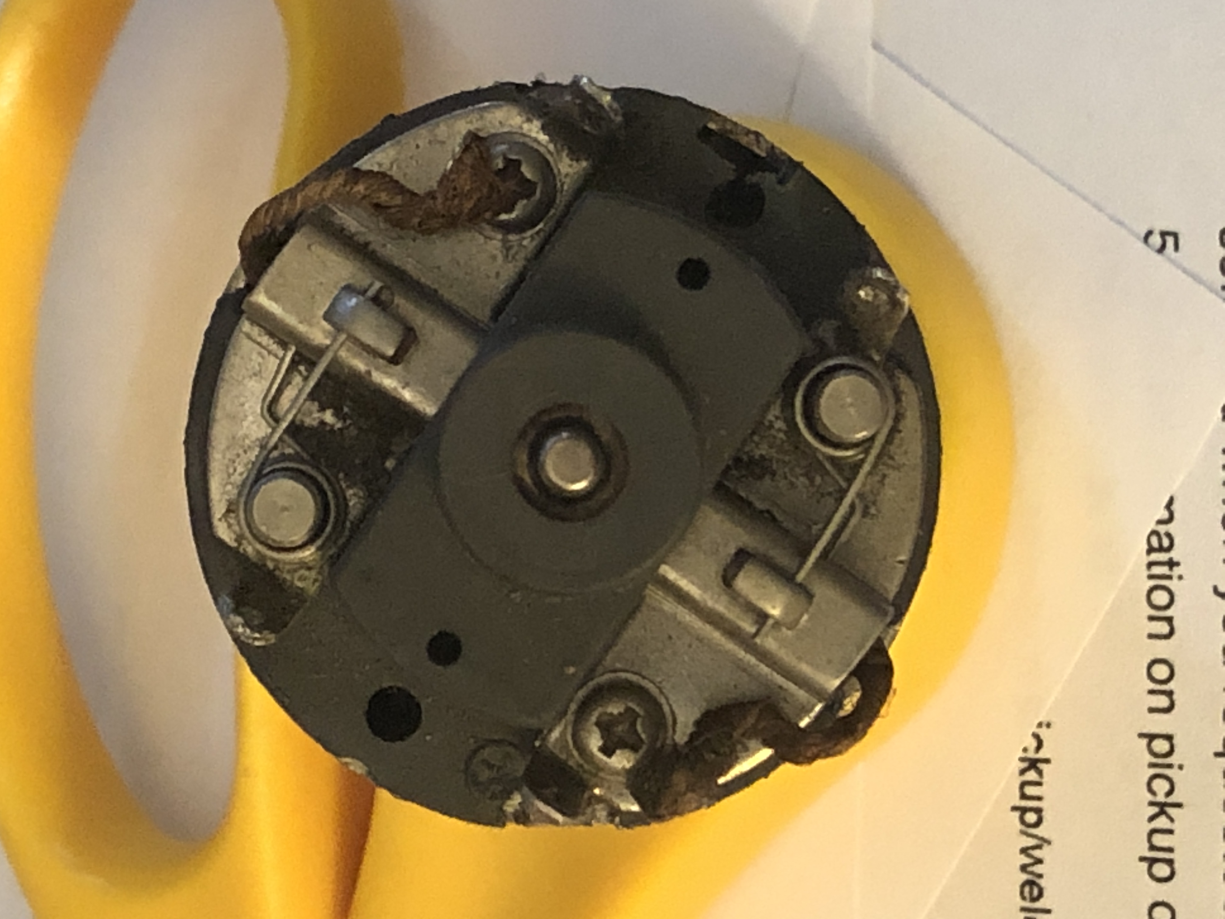

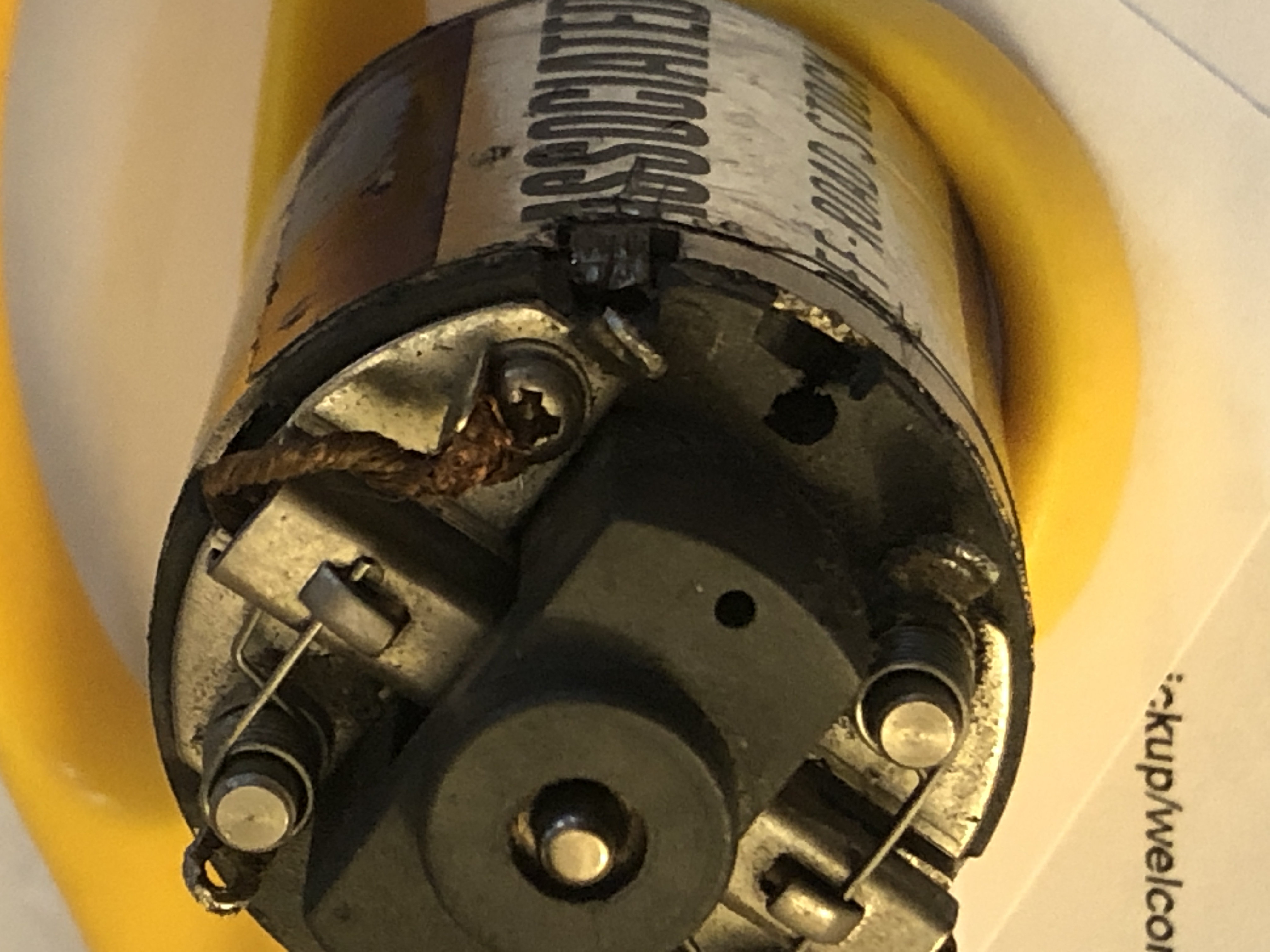

I received a stock Associated Off-Road Stock Motor (Edinger label) in a misc lot of rc parts recently. the motor has been opened by previous owner and the end bell modified with new slots cut for the can tabs to be reattached with significantly advanced timing. to my eye it looks like the timing is at 50+ degrees -- see the pictures below. In the 2nd and 3rd images below, the motor mounting screw holes in the can are at 3 and 9 o'clock, and the can crimp tabs are at 12 and 6 o'clock (just under the solder tabs where the brush leads are attached). You can see how far the brushes are advanced. I didn't notice this when originally bench testing, except that the motor's RPM was higher than expected.
Have you seen motors modified this way and what are the effects? I understood this was much father then is recommended for even a stock motor. I assume the motor is at high risk over overheating with longer run times and higher gearing. any other concerns? it seems to be in decent running condition
Should I leave it alone? not sure i would run it, but the label is damaged so not sure i would keep it for a shelf build either. Any suggestions or thoughts welcome.

in looking around online I found one forum thread where stock motors timed to 45-47 degrees was discussed, so it appears this isn't completely unheard of, though it wasn't clear if there was a known consequence or risk. My understanding is still that it's pretty extreme for a motor, even a 27 turn stock... Definitely interested in any other experience with this!

Those motors with lots of timing were designed for short duration races, in fairly low load vehicles. They ran very hot and were rough on brushes and comms.
The tabs are already loosened on the can. Assuming that it isn't already trashed, I'd take it apart, freshen it up, and put it back to factory timing.
