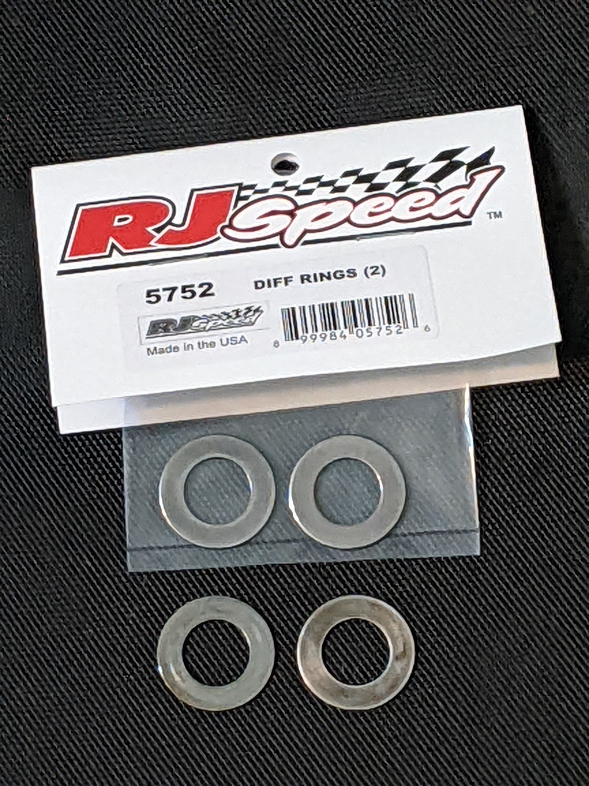

I ordered a pair of RJ Speed 5752 diff rings since they were only $2.99 a set. They fit as direct replacements for my RC12L diff rings which I think takes 6579 rings.

6625, same as the 10L and six gear.Frankentruck wrote: ↑Wed Dec 01, 2021 6:52 pm I ordered a pair of RJ Speed 5752 diff rings since they were only $2.99 a set. They fit as direct replacements for my RC12L diff rings which I think takes 6579 rings.

I just started refurbishing a 2.25 gearbox and the diff rings are crumbling apart, shedding steel slivers from the edges. Time to try these McMaster Carr rings.

Those aren't the same as Associated #6579 Diff Rings. They won't work on the Stealth Transmission. I think those are for the 6 gear Transmission.Frankentruck wrote: ↑Wed Dec 01, 2021 6:52 pm I ordered a pair of RJ Speed 5752 diff rings since they were only $2.99 a set. They fit as direct replacements for my RC12L diff rings which I think takes 6579 rings.
