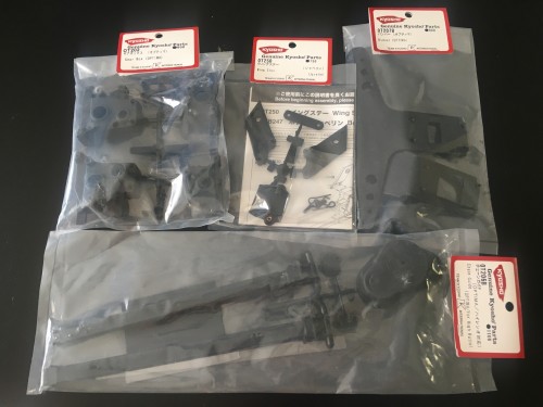

Hey guys, I have an original 80s javelin that I'm rebuilding to be a runner. I got this in the late 80s and I don't think I was able to drive it that much until the MSC shorted out. Went into storage after that. I've read that the original gears are made of cheese so I'm looking for advice on what to do to make it more reliable. Don't want it to blow up on the first run. I'm trying not to spend too much money on this
The plan is to run it with a silver can at first maybe move to a 17T brushed motor if it's too slow. I have a Tekin FX ESC and 2s lipo. Depending on how it does, maybe move to a BL system 13.5 or lower in the future. Which option would be enough for the motors listed above? Thanks!

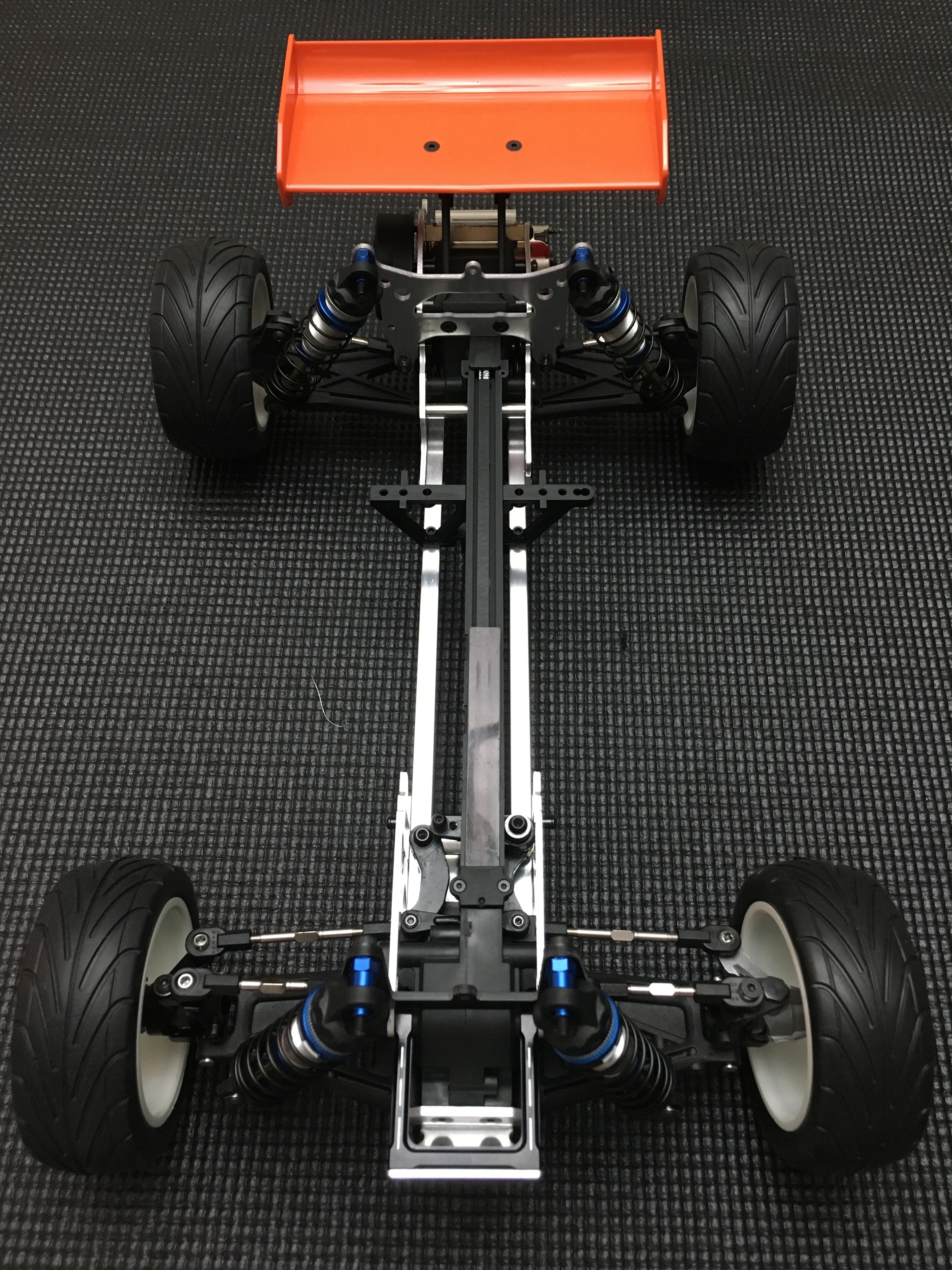

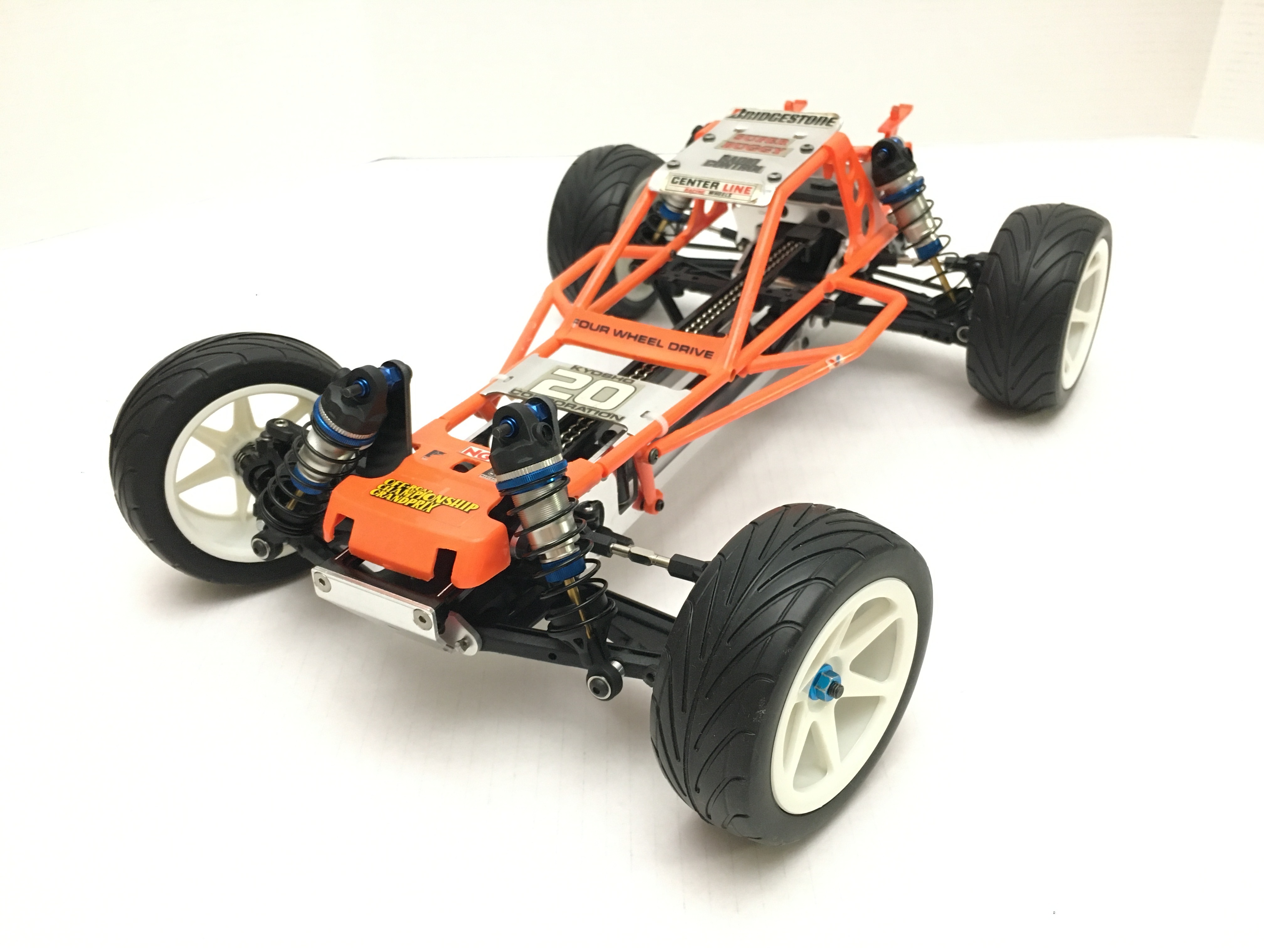

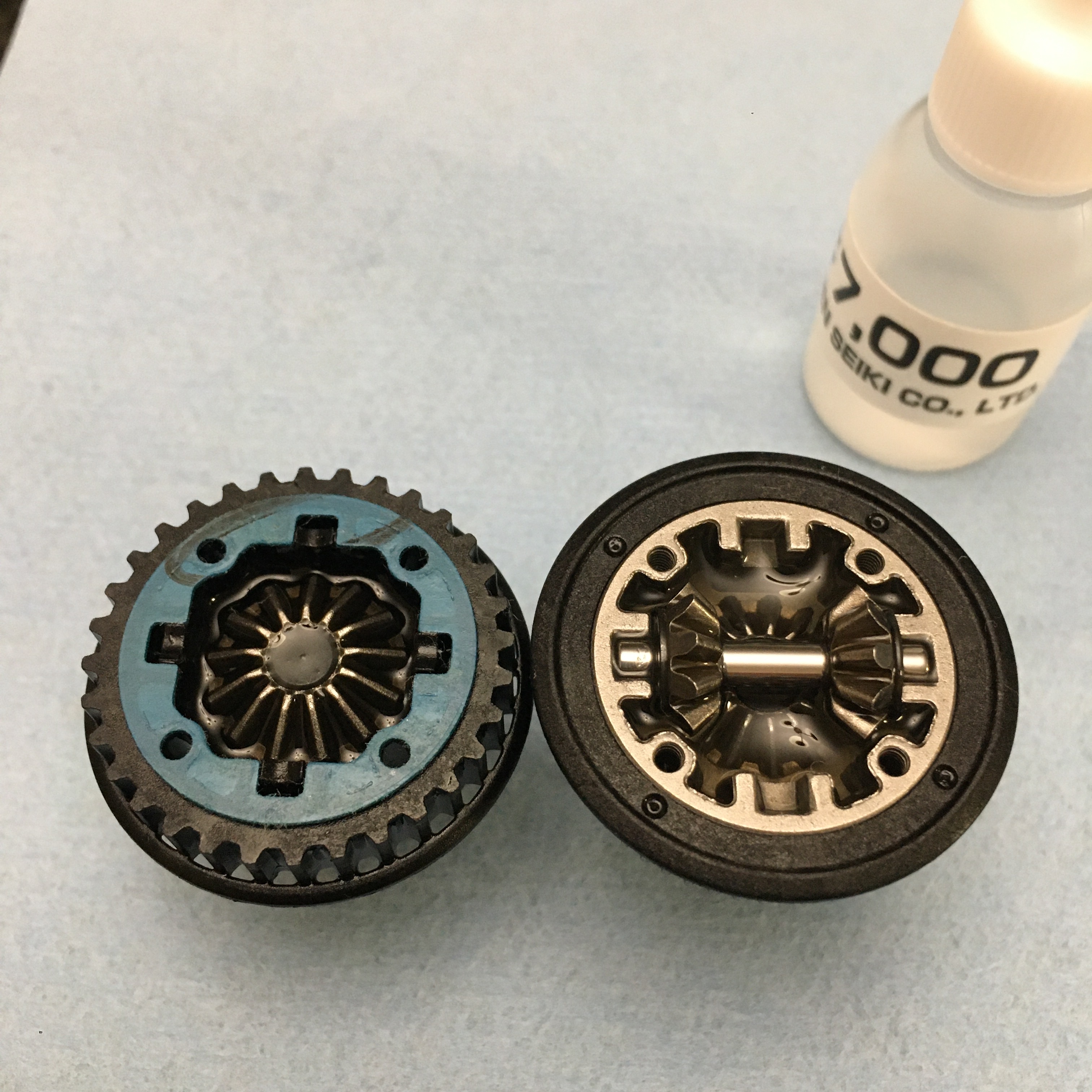

Here's the most recent picture of my Javelin. Just threw it together to see if the parts all fit. As you can see, there are rere parts on it already

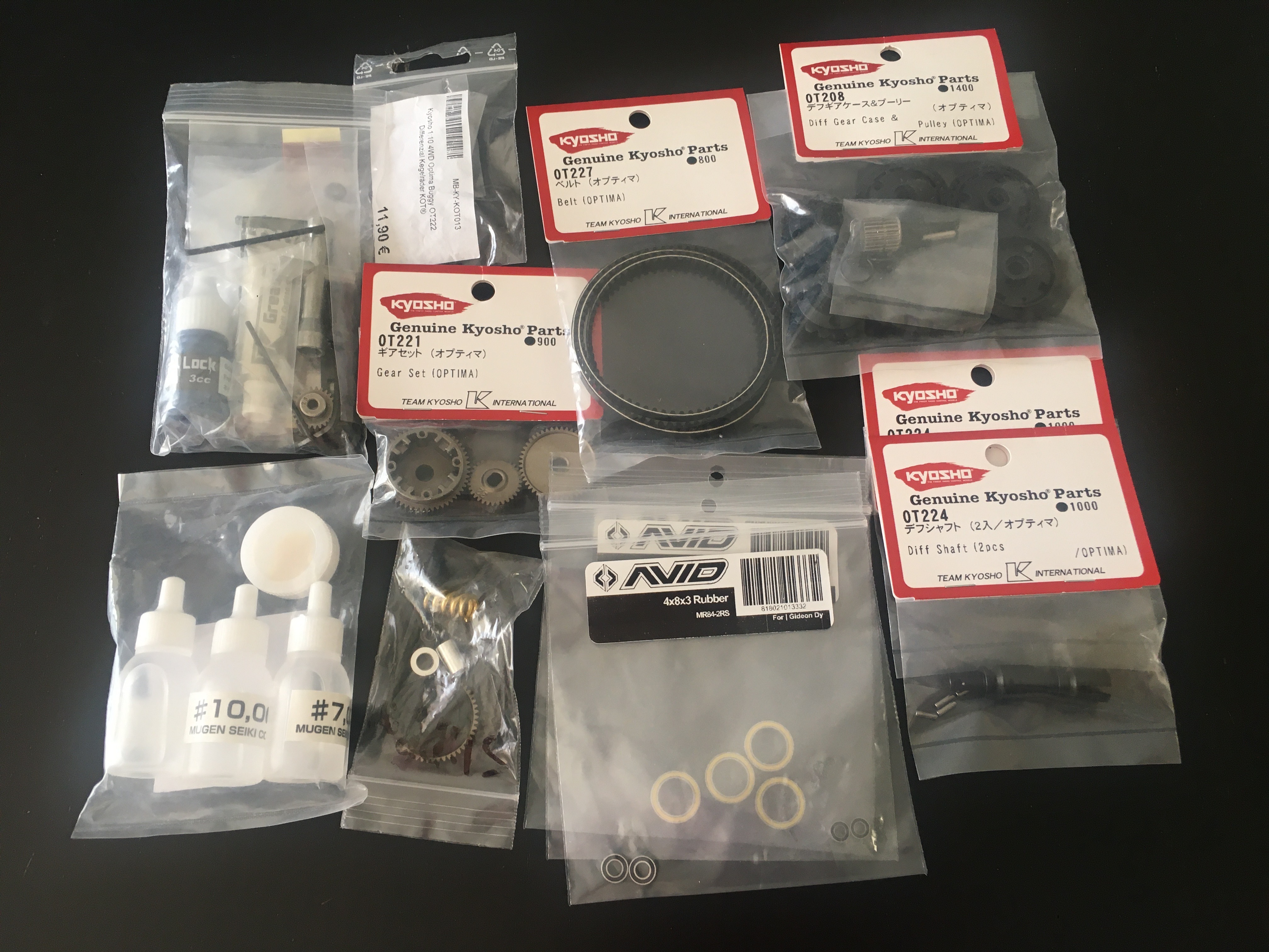

I really didn't want to go the rere route but it seems to make the most sense. And I think I have to do it soon because some parts are already out of stock and I'm not sure if it will ever be restocked.
I saw that you've already done this conversion your Javelin runner post. Car looks great by the way. Was there anything you reused from the original drivetrain, like the front diff?
Here's a list that I've compiled. Does it look right? I think it's just missing some bearings and the slipper discs/pads.

Thanks!XLR8 wrote: ↑Wed Jan 19, 2022 4:25 pm I agree with Dadio.

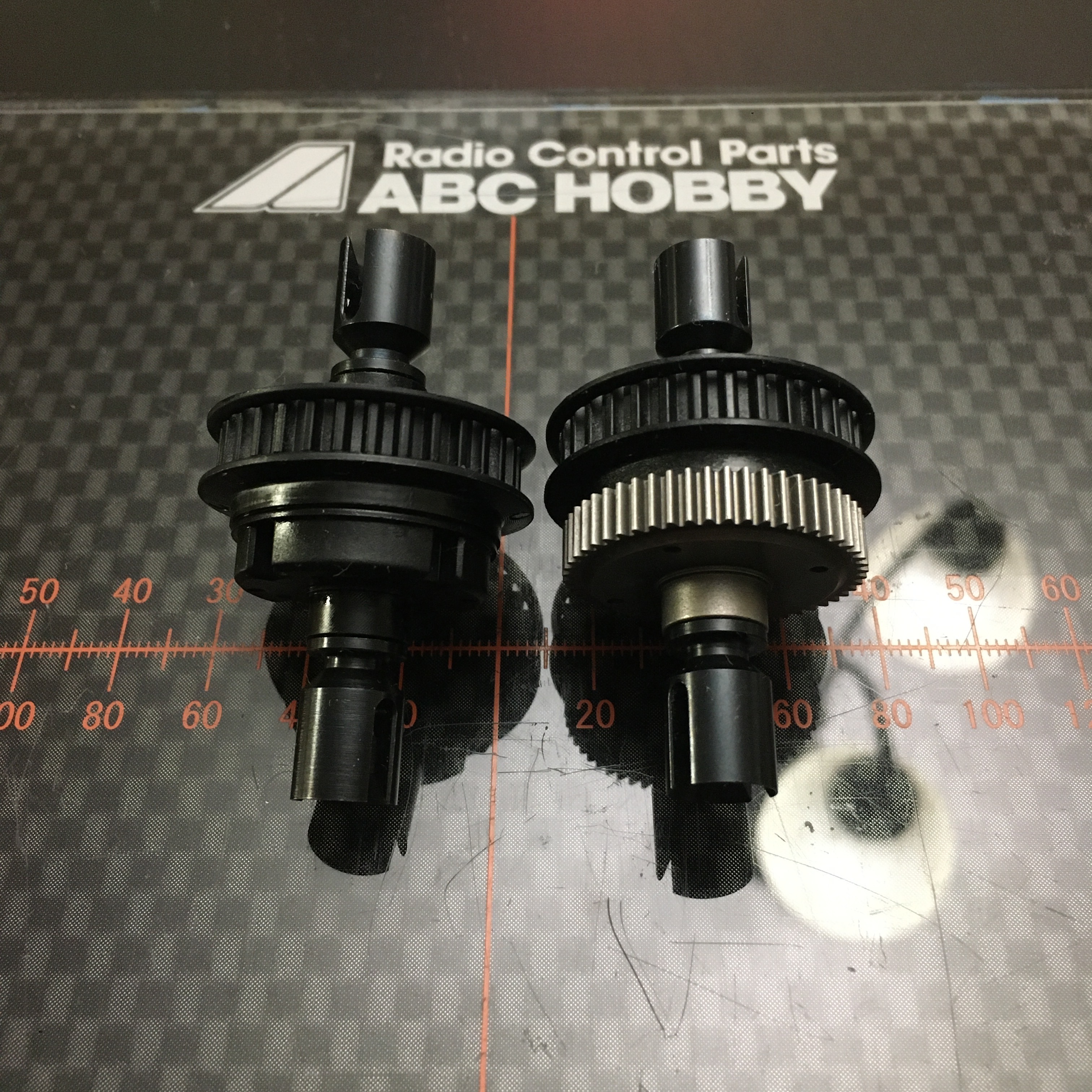

It's been a long while since I've had my car apart so I really don't recall many of the details.
For the front diff, if you run the chain, then you can continue to run the car's original front diff assembly - the specs for the chain is the same. If you switch to belt drive however, the front diff assembly and cases must be changed. I seem to recall that the rere's belt pulley won't fit the vintage diff case because the screw locations were changed. Anyway, I just looked at my car (belt drive) and it definitely has modern drive cups so that means the entire front drive assembly is modern.
For the rear assembly, every part inside the transmission and the trans cases have been changed and those parts won't interface with vintage parts.
The motor plate, spur gear spindle and gear cover are essentially unchanged so you won't need those.
That's about as much as I can recall.
Your parts list is missing a belt -- if you intend to go that direction.

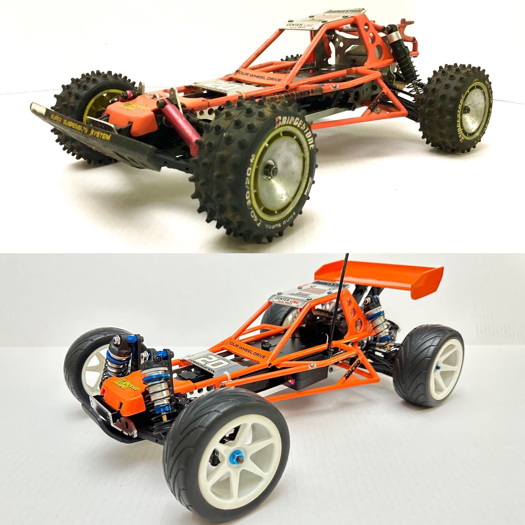

Finally finished the car late last year. Not much is left from the original car, could probably build another one at this point . Just wanted to update this thread to show the finished product.
