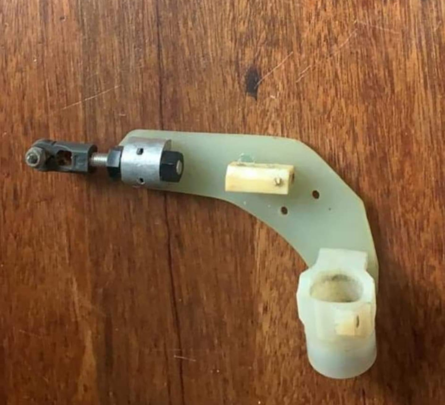

The trailing arms are super thick curved fibreglass affairs with pivot point fittings exactly as per the mag picture; they are the exact same items after all. Super, super cool. To top it off I have added a one-off set of gold Brimod shocks (I have never seen another set in this colour previously).

Are you missing a link on your build or is it hidden behind the slider shaft in the pic?

Yes, there are a few links and bits and pieces not yet on the build. Small details now though i think. I have been trying to work that link out from the photo.... i can see the holes where it joins at either end but to me it looks just like all-thread with large ball joints at both ends then perhaps as strengthening tube/sleeve over the all-thread itself. Easy enough to do.
