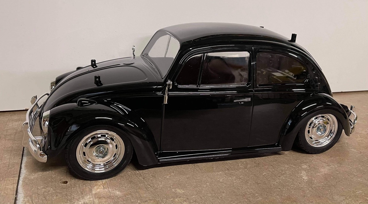

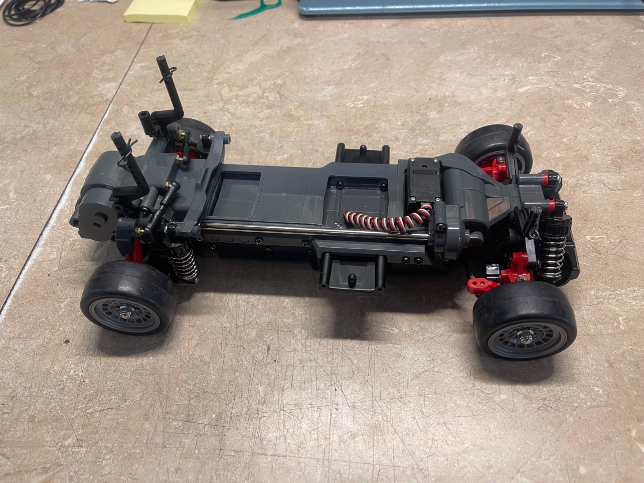

I have a MF-01 VW which is 4wd M style chassis (smaller). It was a more fun build with more interesting design and adjustability. It was bought as a rally but I lowered it into an onroad setup.
