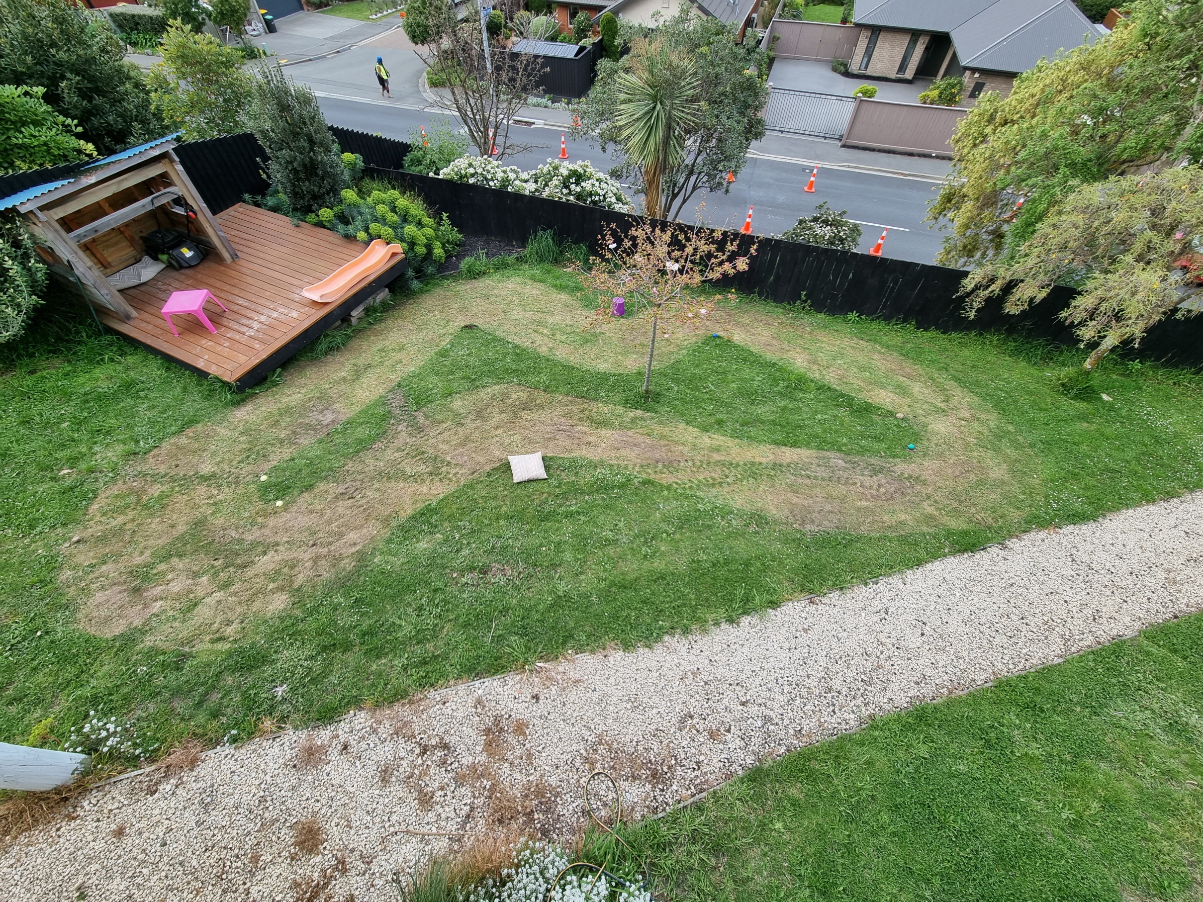

Got the car running, but need a couple more changes before I take it out of my garden and into a club + on to the interweb via YouTube.
What pinion are you racing people using for racing with a 27t brushed motor? 16tooth 32dp?
My Meteor test track is the only place that's heard its scream for over 2 decades.

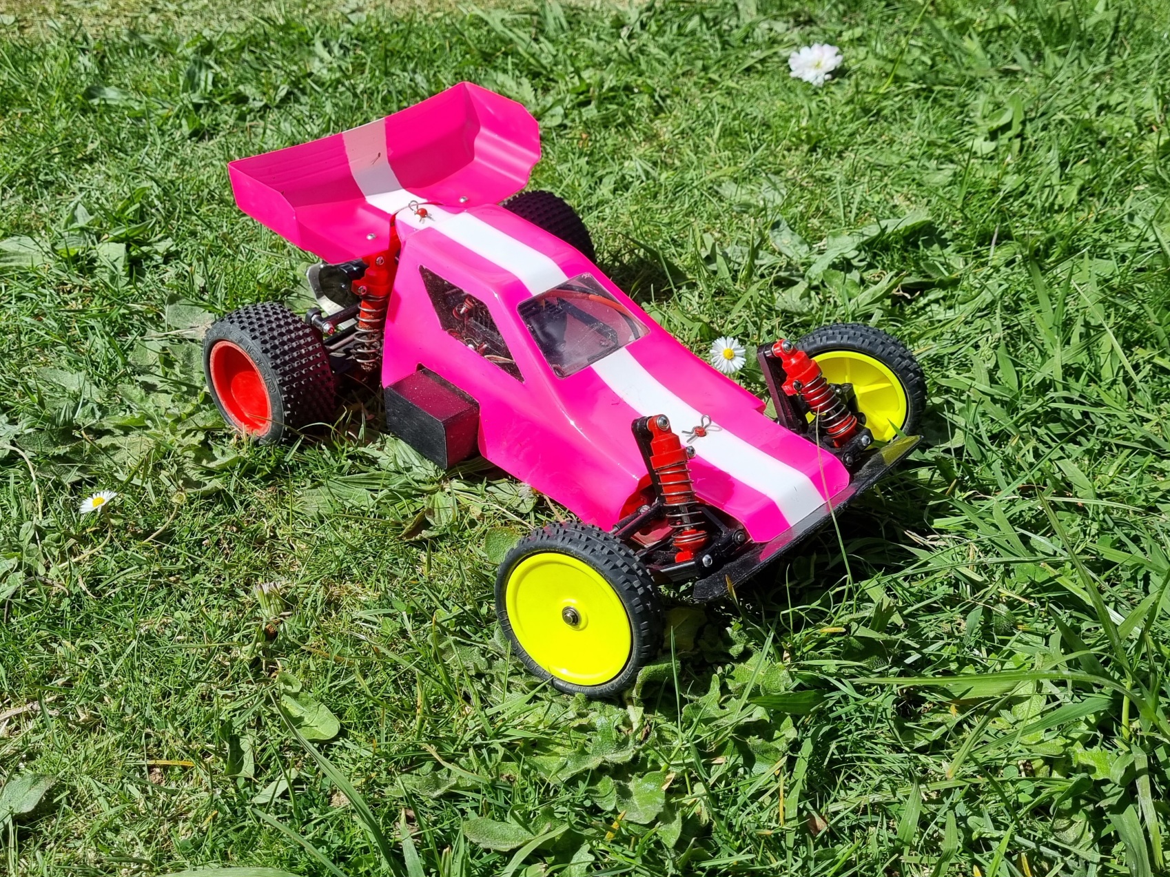

Christchurch, I will need to figure out what pinion to use to get that drive ratio. The 12 tooth pinion is way too slow & I've been told 16t is the normal racing choice with brushed motors.
Painted the shell yesterday and took it for a wee drive today, need to glue the tyres on and make sure everything is still tight, then it just needs a bit of set up and the shocks resealed

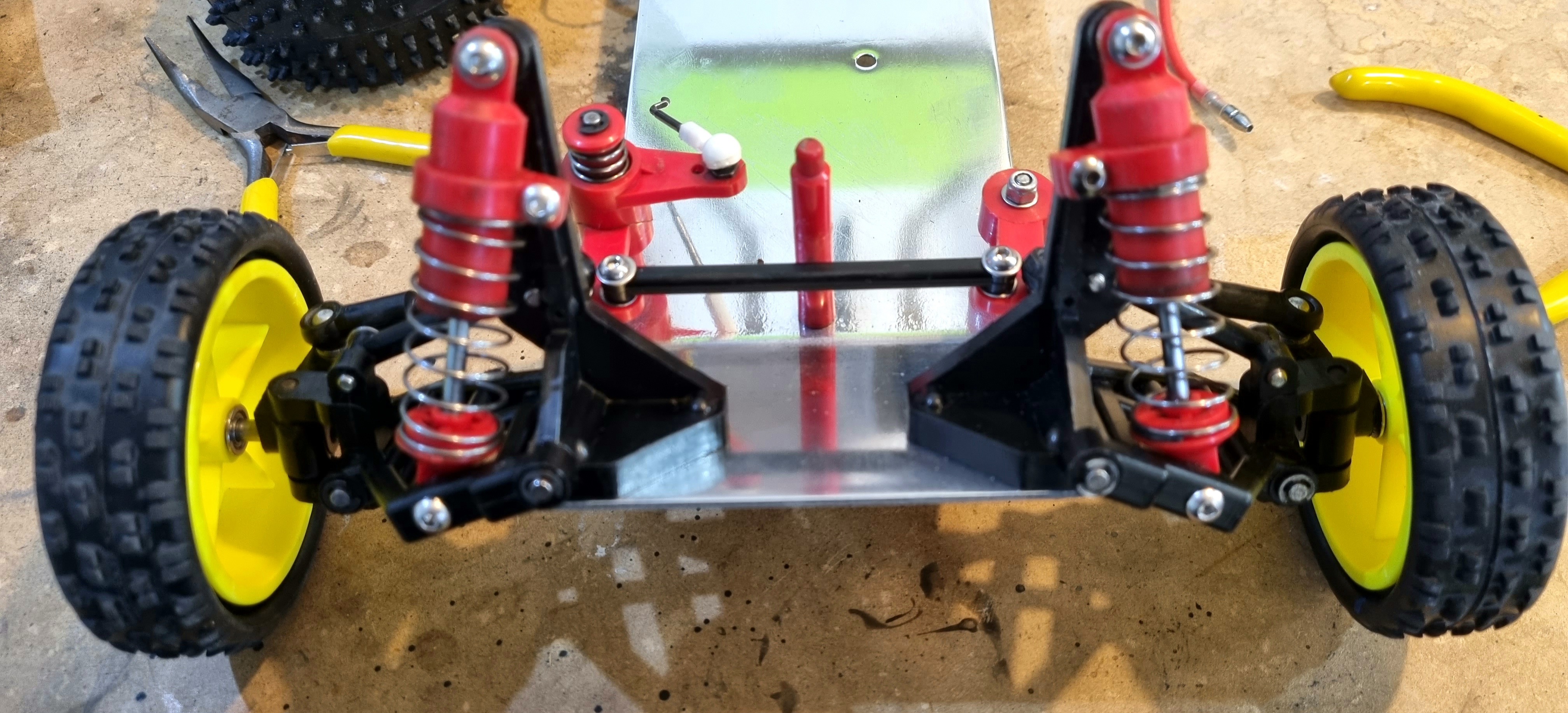

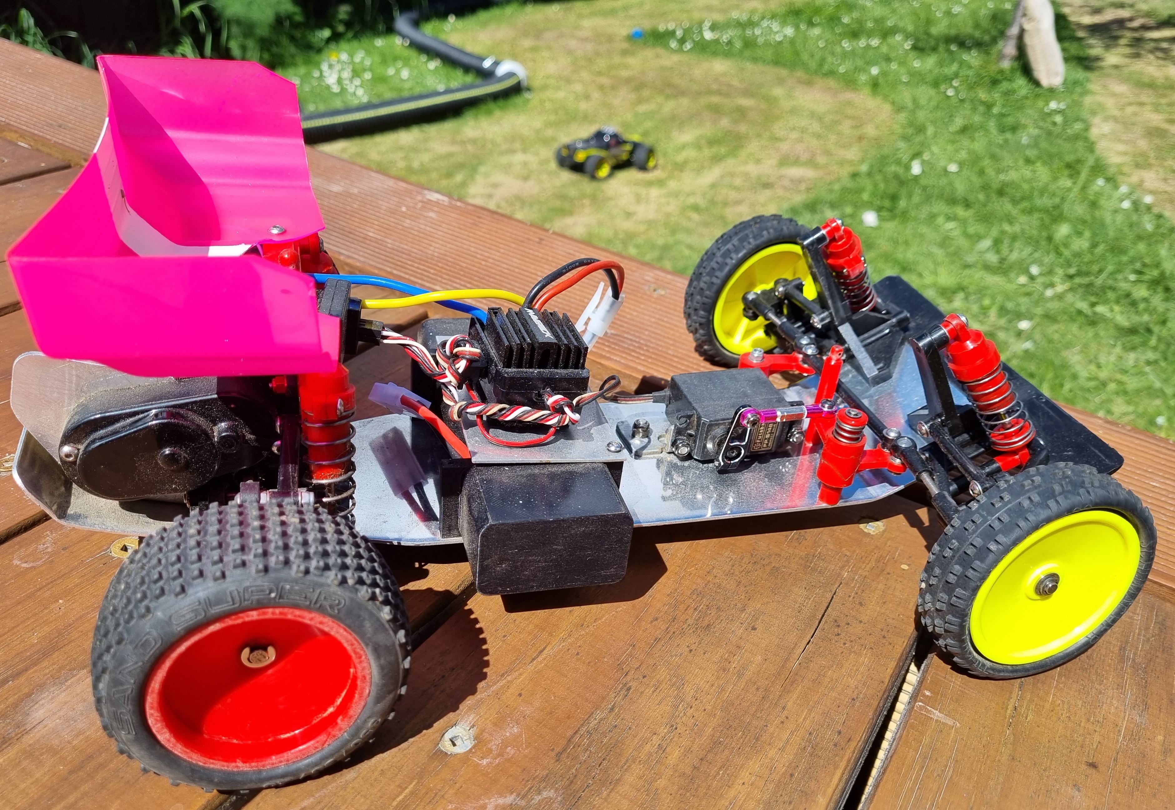

Progress
Got the 16t pinion in the car, hopefully it won't melt the gearbox with the extra heat syncs I have added, also got new springs on the rear, new servo horn, new servo rod (filed down to length) and a new Futaba 3pv + t-fhss reciver (my flysky was malfunctioning because the wheel has been turned too hard by my 4 year old son when he was driving my LC Racing embt.... he is driving his WL toys 144002 in the background of the pic).
Going to order a new shock tower, rear wishbones, bearing rear hubs + c hubs & steering arms from Additive RC (sadly the gearbox casing isn't ready yet).
Next jobs are... fitting all the schumacher dog bones and ball joints I just bought, putting the OG rear springs on the front, rebuilding the front shocks with new plumbers tape and some new o-rings from my RC10B6.1 shock rebuild kit (I have never run the car), fitting the new mardave front wishbones I have, trying the 15t pinion, swapping out the OG Futaba FP-S148 servo for something better and not "sloppy", locate some gearbox parts with bearings (the ones Mardave have sold out of).
A pic of my car with the shell off.

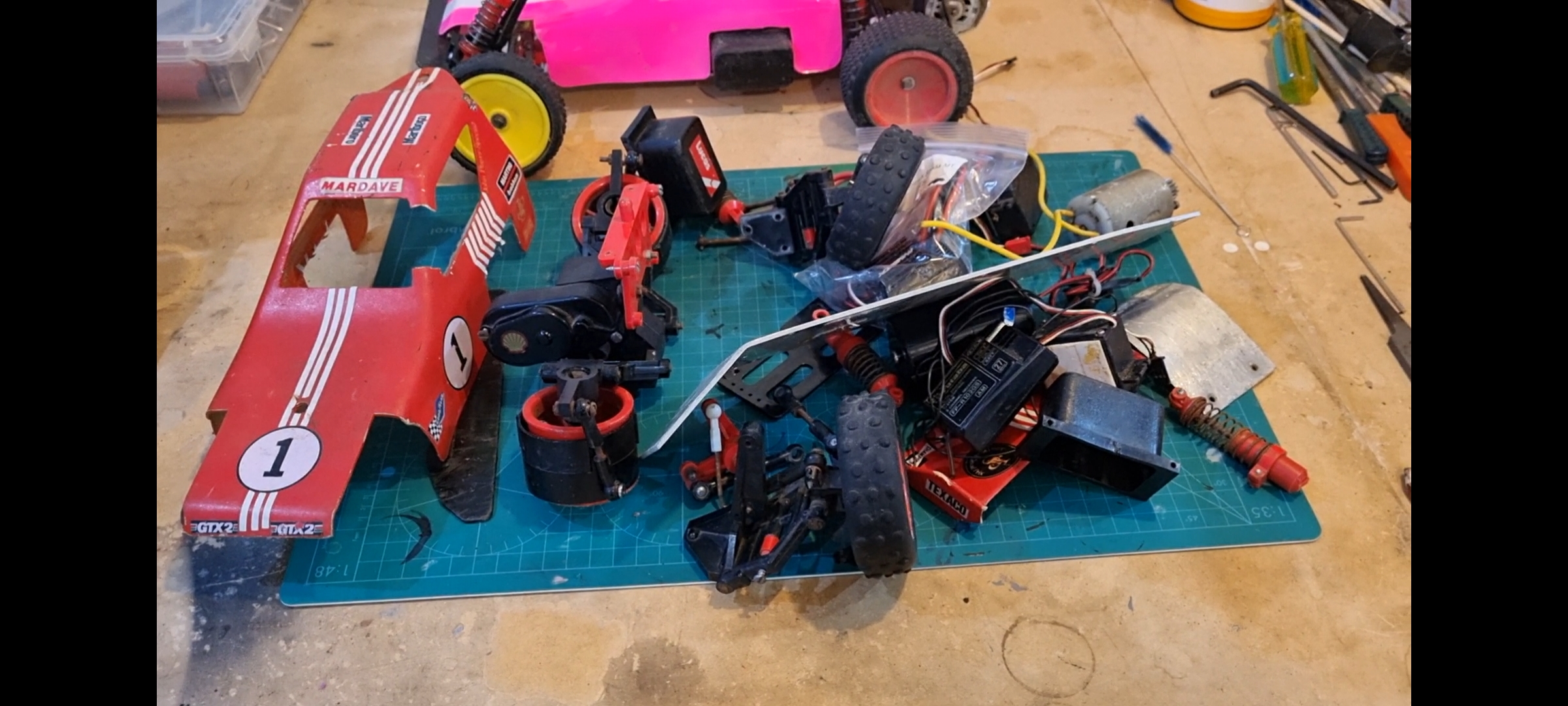

Pulled it all to bits now.
got the 4x8x3 bearings ready for the gearbox, the ball raced idler gear, a 16t 32dp pinion and a spare 20 mins every few days to start the build.
