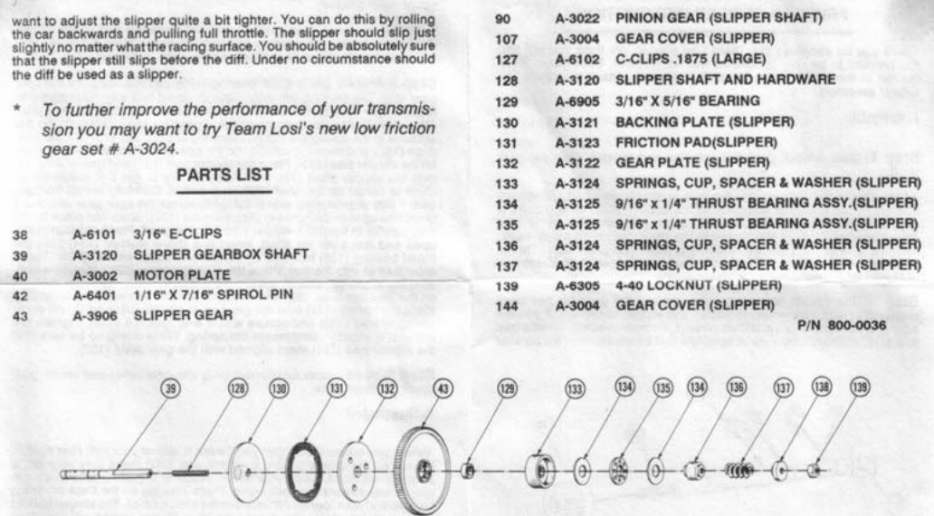

Re: Losi JRXT - Looking for Information on my "New" Truck
So can I simply remove the hydra drive unity and just run the slipper or would I need to get some additional parts to make that happen?BattleTrak wrote: ↑Sat Nov 11, 2023 11:39 pm That is not a JRXT...it’s a LXT. It has some nice upgrades..Tecnacraft titanium turnbuckles, Litesink, A&L/Factory Works Steering arms and RPM gear cover and tall chassis brace. The transmission is the Retrofit with slipper and Hydradrive. I wouldn’t recommend trying to get this to run 70mph..you will be breaking parts that are getting expensive & hard to find..and its just not designed for that. Brushless would be ok but keep it reasonable and I would remove the Hydradrive because it’ll probably melt down...just use the slipper. Check out the Losi section here and Vintagelosi.com for more info.
http://vintagelosi.com/LXT.html
Also…Uploading pics would be nicer than making us go watch your videos.
- ChocoTaco73
- Posts: 112
- Joined: Wed Jan 26, 2022 6:53 pm
- Location: Las Vegas, NV
- Has thanked: 57 times
- Been thanked: 101 times
You'll need 133 and 136 then it'll all go back together minus the hydradrive.
James - Losi fanatic
- Posts: 162
- Joined: Thu Jan 22, 2015 2:54 pm
- Location: Middletown, Delaware
- Has thanked: 34 times
- Been thanked: 17 times
Thank you! It has the same part number A-3124 for 133 and 136. So this looks like everything? https://www.ebay.com/itm/335088521339?chn=ps&mkevt=1&mkcid=28&srsltid=AfmBOopR7fhGpqjLt6A83szrL_Kq3iIkbrdA9m3pw9VZRIjTERPlV-NYj5MChocoTaco73 wrote: ↑Mon Nov 13, 2023 10:11 pm You'll need 133 and 136 then it'll all go back together minus the hydradrive.
- ChocoTaco73
- Posts: 112
Yep, looks like you'll need the longer spring as well then you should be good to go.Snaab9-2 wrote: ↑Mon Nov 13, 2023 10:59 pm Thank you! It has the same part number A-3124 for 133 and 136. So this looks like everything? https://www.ebay.com/itm/335088521339?chn=ps&mkevt=1&mkcid=28&srsltid=AfmBOopR7fhGpqjLt6A83szrL_Kq3iIkbrdA9m3pw9VZRIjTERPlV-NYj5M
