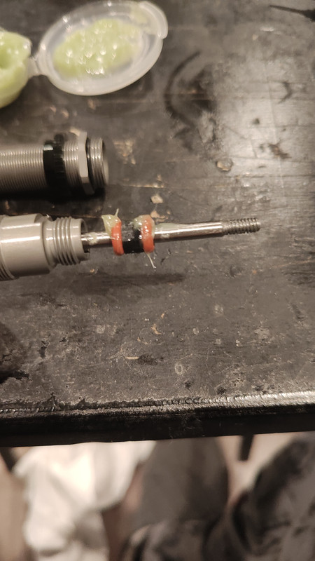

Im building this as if AE created a Rere Team Car. To help with that feel IM using Rere World Shocks NOS
A little green slime to keeo the leaks away
The shocks are assembled like any other modern shock.
Looking good!!!!
