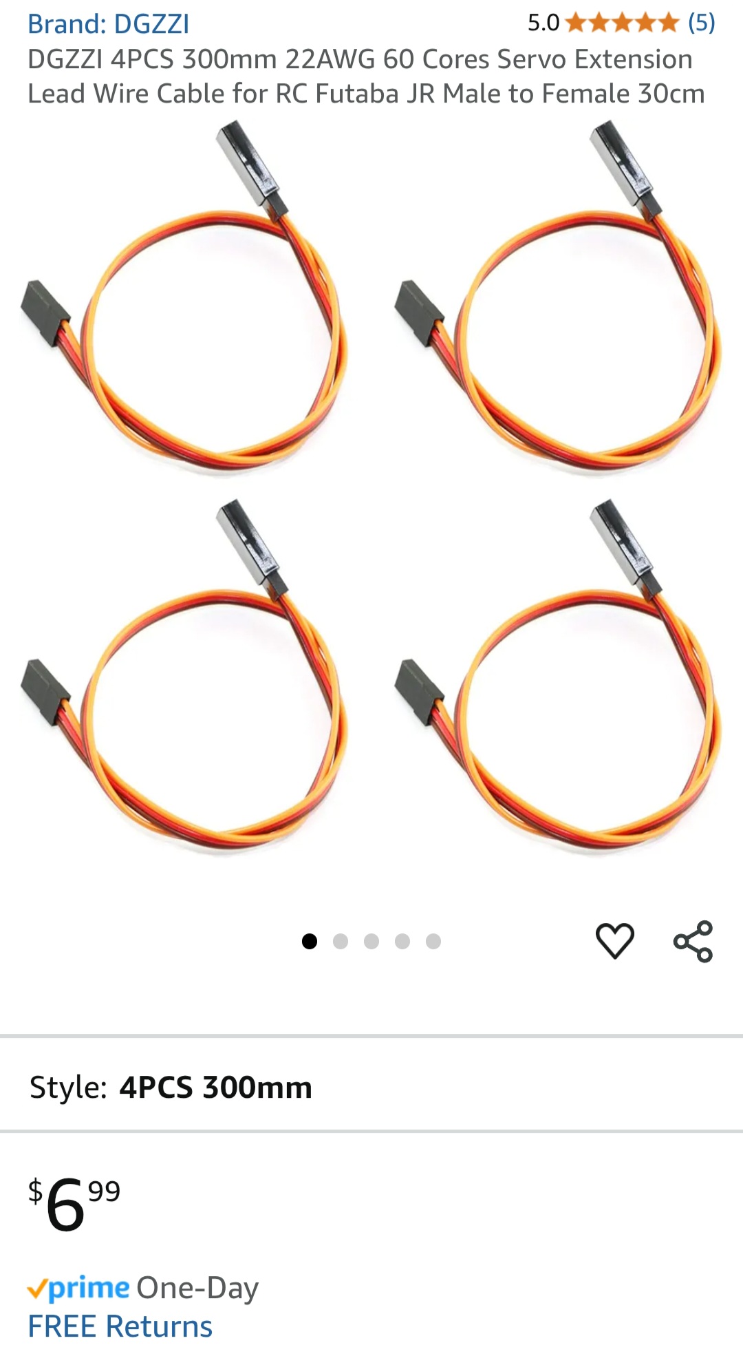

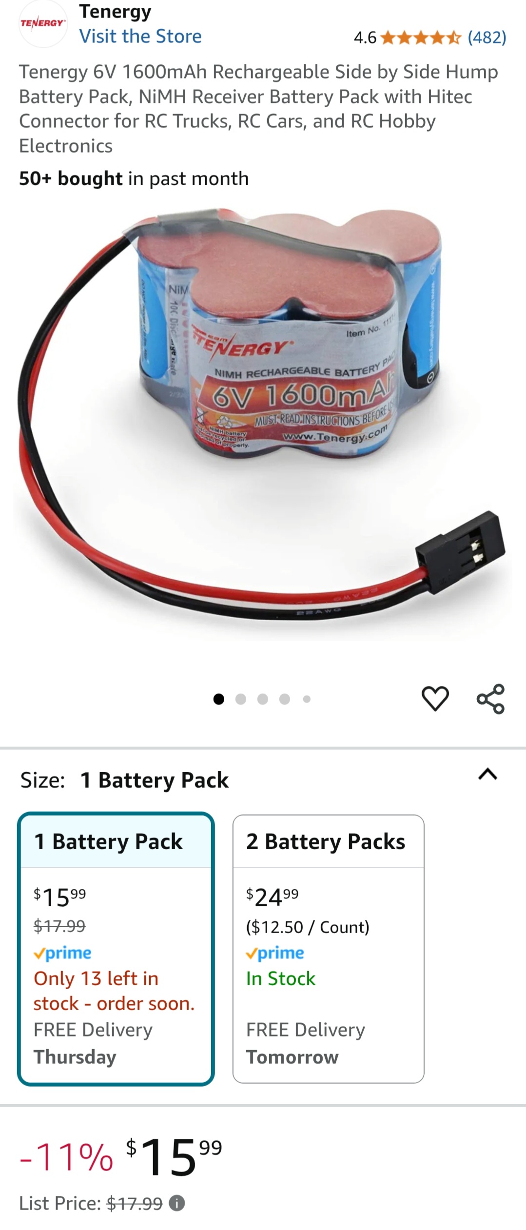

Those are notorious for causing problems. The spring loaded contacts can be a problem when you fasten the unit down. I would highly recommend using a proper receiver pack. These 6v rechargable packs are cheap and work well.
Also don't use a switch. Just an extension. Plug it in to use it, unplug when done. Switches are a common source of runaway. These are the ones I use.

GoMachV wrote: Tue Mar 25, 2025 3:26 pm Those are notorious for causing problems. The spring loaded contacts can be a problem when you fasten the unit down. I would highly recommend using a proper receiver pack. These 6v rechargable packs are cheap and work well.

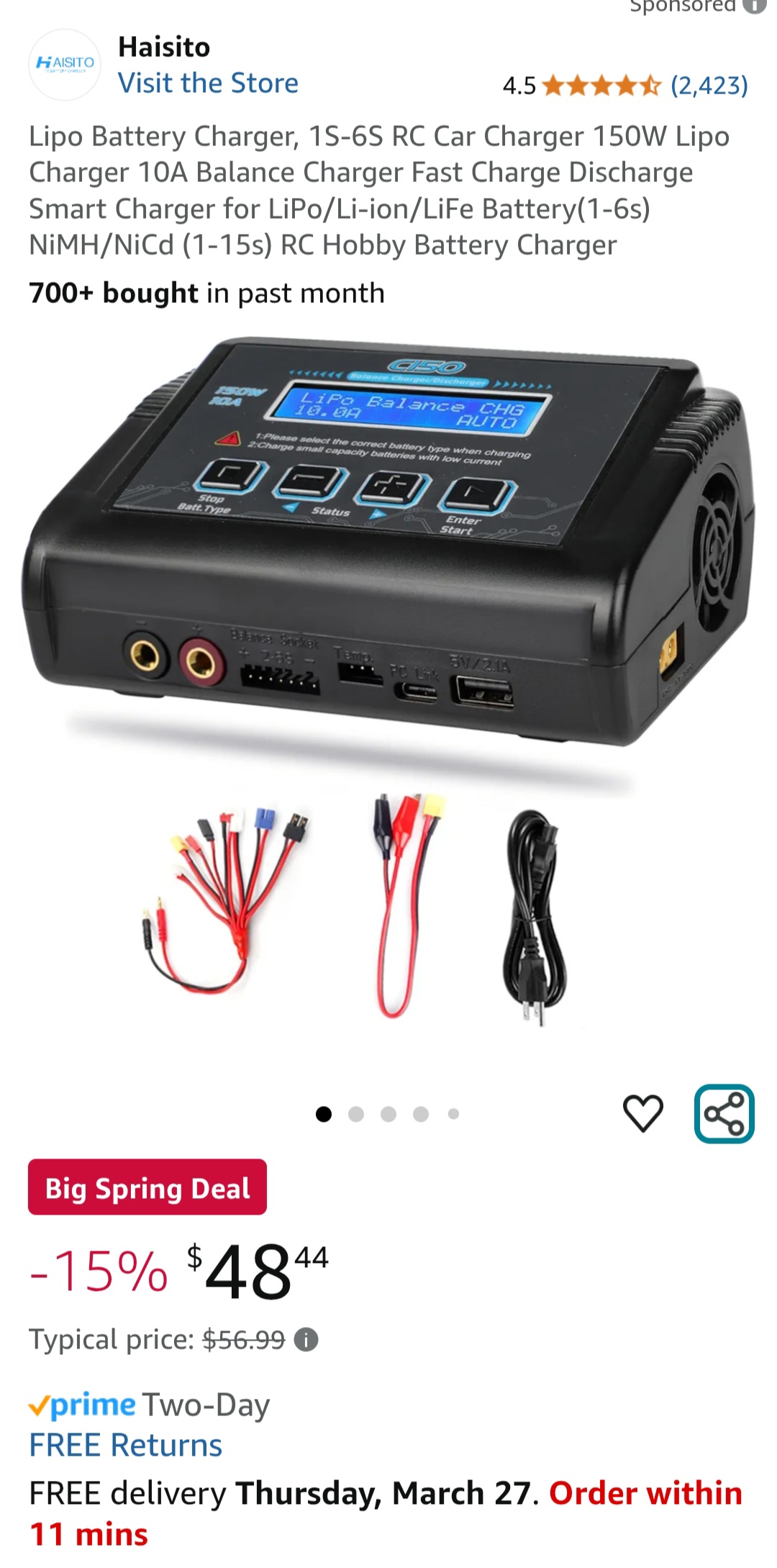

Gotcha. Thank you for the recommendation. What do I use to charge the battery pack? All I have is a Traxxas charger right now for lipos. It has the Traxxas plugs on it of course.
Posts: 12335
Been thanked: 3917 times
Re: Current Radio For 90s RC10GT
Pretty much any charger other than Traxxas will do almost all batteries, something like this.... And yes it's ac/dc
