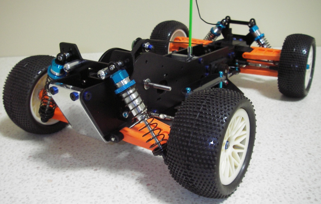

Re: AYK BOOST BUILD

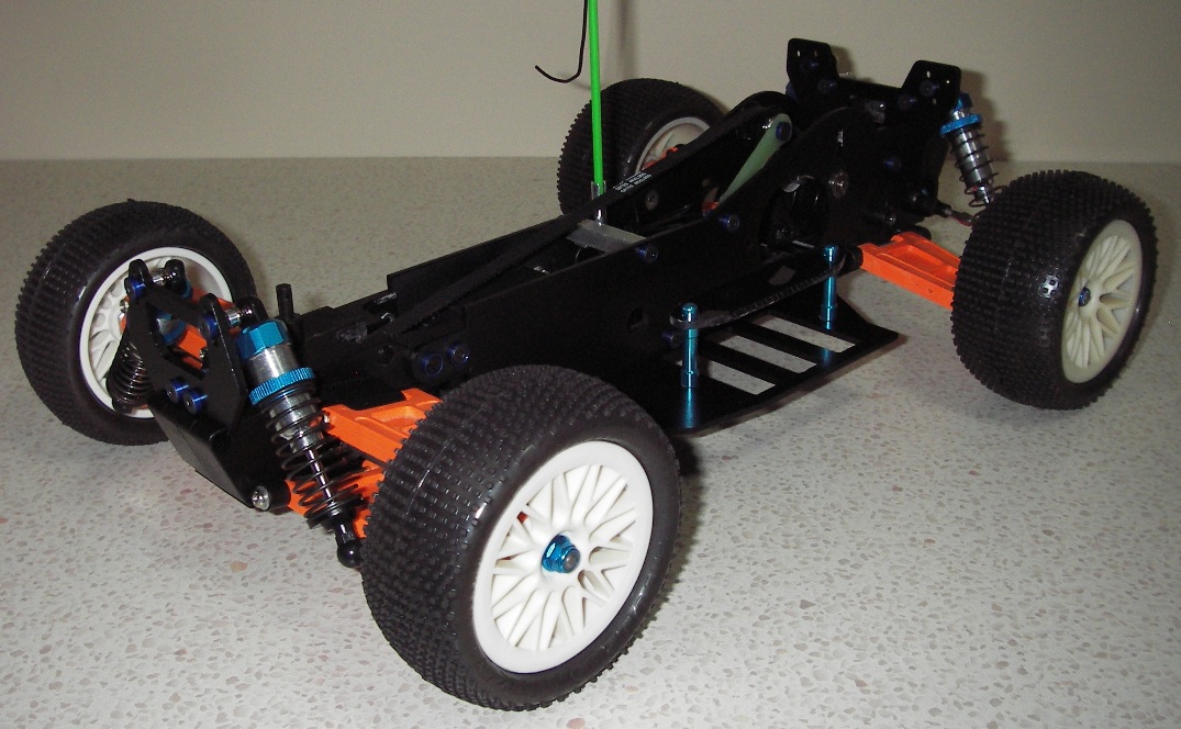

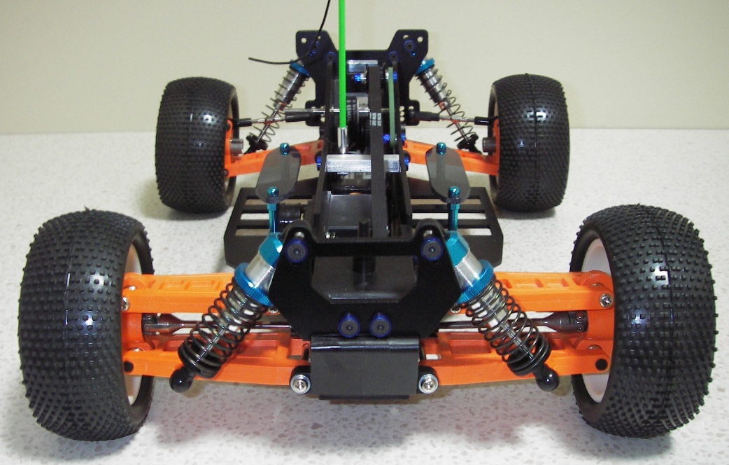

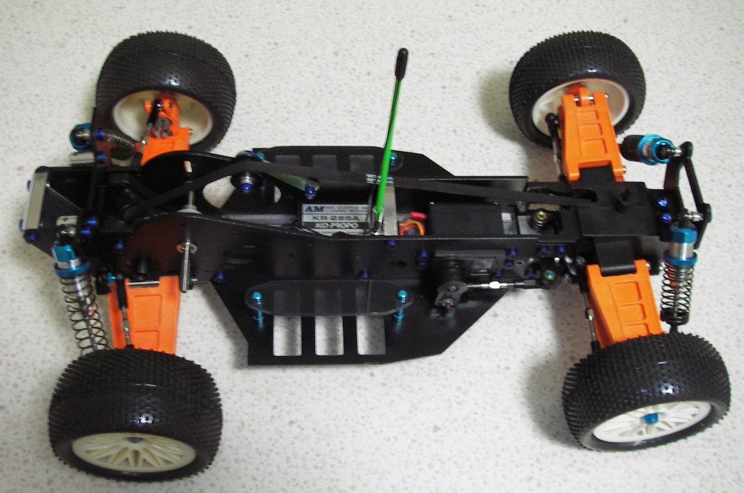

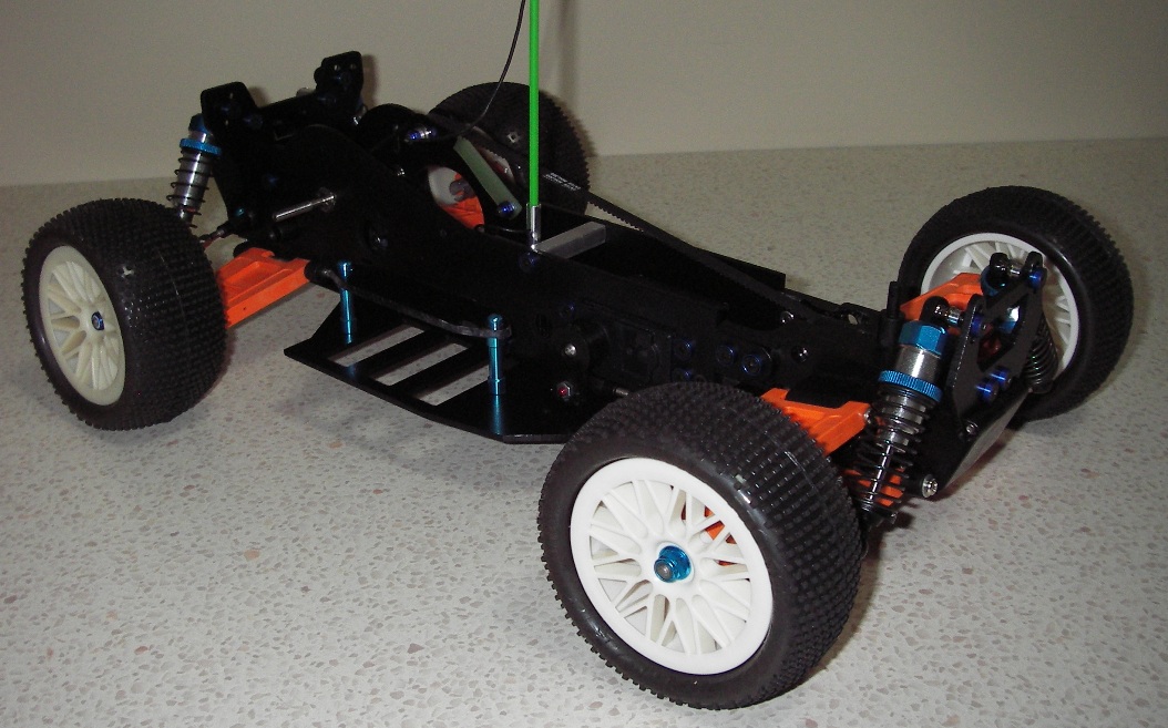

hi guys
Heres some more pictures of the build, need to order another drive belt, the first on was too short, the next one was too long, hopefully 3rd time lucky, other than that, the build is coming along well, also waiting on my RC10 slipper set up to come from the bay, Tony (Dirt oval) helped with the lay shaft, he is also sending me a motor heak sink, Alex (Incredible Serious) helped with the wheels, i reckon they look great, might give them a coat of flat black paint,
I've got a original uncut Boost body set that i've made a female mould of, now i need to make the male mould and make some repro body sets, hopefully have some bodies in the next couple of months. I'll post some more photos in the coming weeks with the motor and speedy in it and hopefully running.
cheers Bullfrog
cheers Bullfrog

Re: AYK BOOST BUILD
Surely not... the stock ones did not look like those. These are modern...jwscab wrote:hey, what shocks are those? reanodized stock ones?
- jwscab
- Posts: 6580
- Location: Chalfont, PA
- Been thanked: 505 times
Re: AYK BOOST BUILD
yeah, it's hard to see. I know what the stockers look like, and through the springs, it looks like they could be. the tops are hard to tell if they are a hex, smooth, or ridged like the stockers. So I didn't think they were, but it's hard to see. It also looks like the spring adjusters might be threaded, which the stockers definitely were not.
sweet build fo' sho'
are you using the avante CVDs on front and back?
Oh, I also wanted to get info on the pulleys and belt. where did you get them? any specs?
Are you using the one way hubs up front? doesn't look like it, but they might not be on the boost, just the radiant, I don't know they history of the cars that well, as they are so similar it gets confusing.
Re: AYK BOOST BUILD
hi guys,
shocks are 3 Racing, not bad shock for the money paid, seen to work well. Yes i will be using Avante CVD's in the front and rear Avante dog bones, the pullleys and belts were brought from a supplier of mine in Australia, I work for a Bearing wholesalers and i was able to source these from them, they are a wholesaler as well. Pulleys and belts are MXL pitch, they main pulleys are 40 teeth, the drive pulley is 18 teeth, the guild is 20 teeth, belts used are still in process of finding the correct ones, once i work out the drive belt i'll let you know.
I am not running a one way in the front at the moment, i'm trying to work something out for it, hopefully i'll have something soon
cheers Bullfrog
cheers Bullfrog

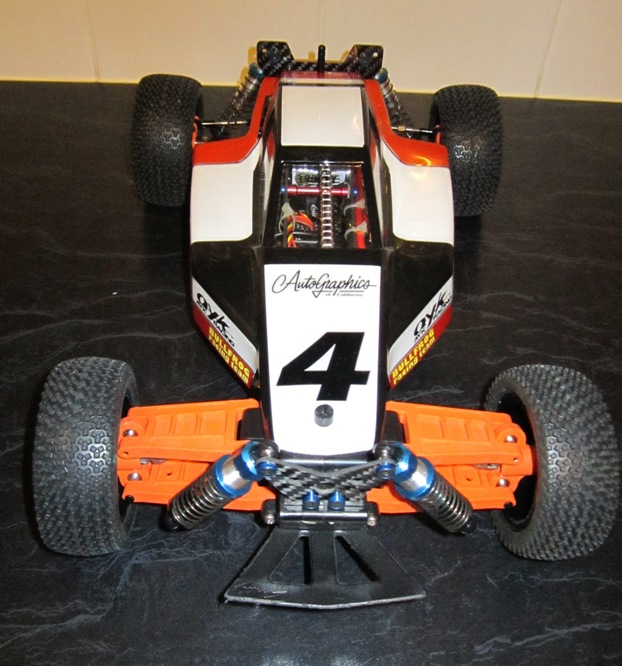

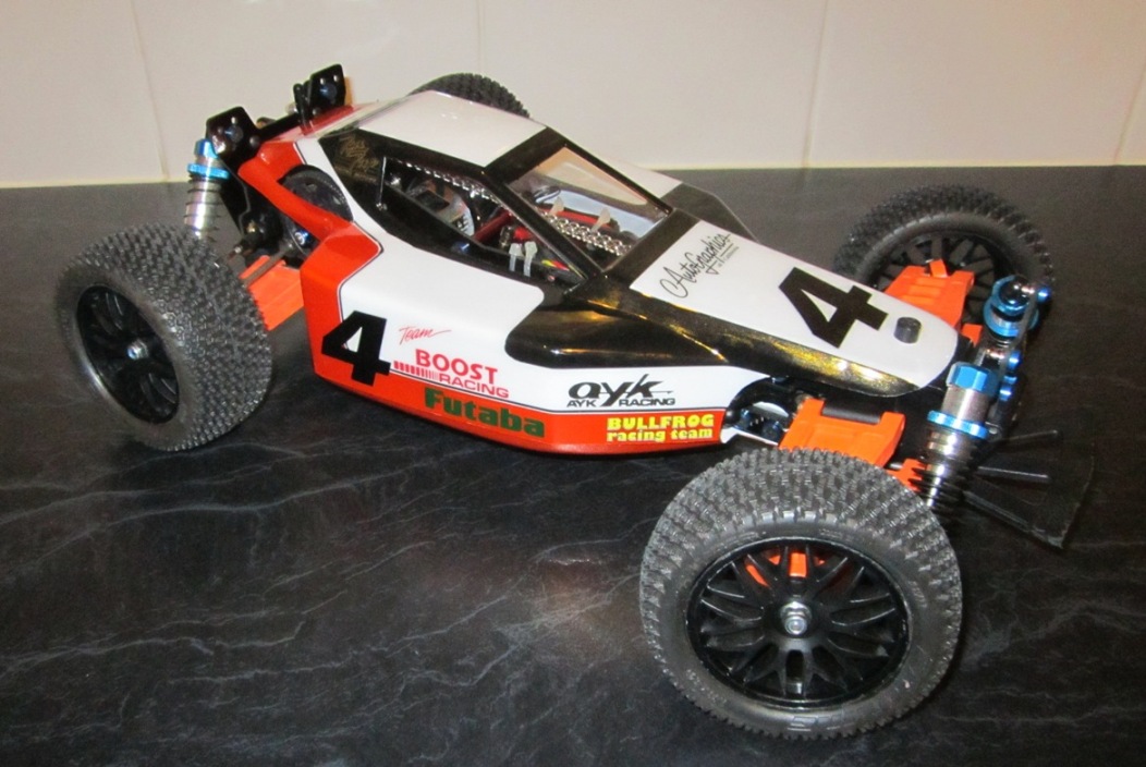

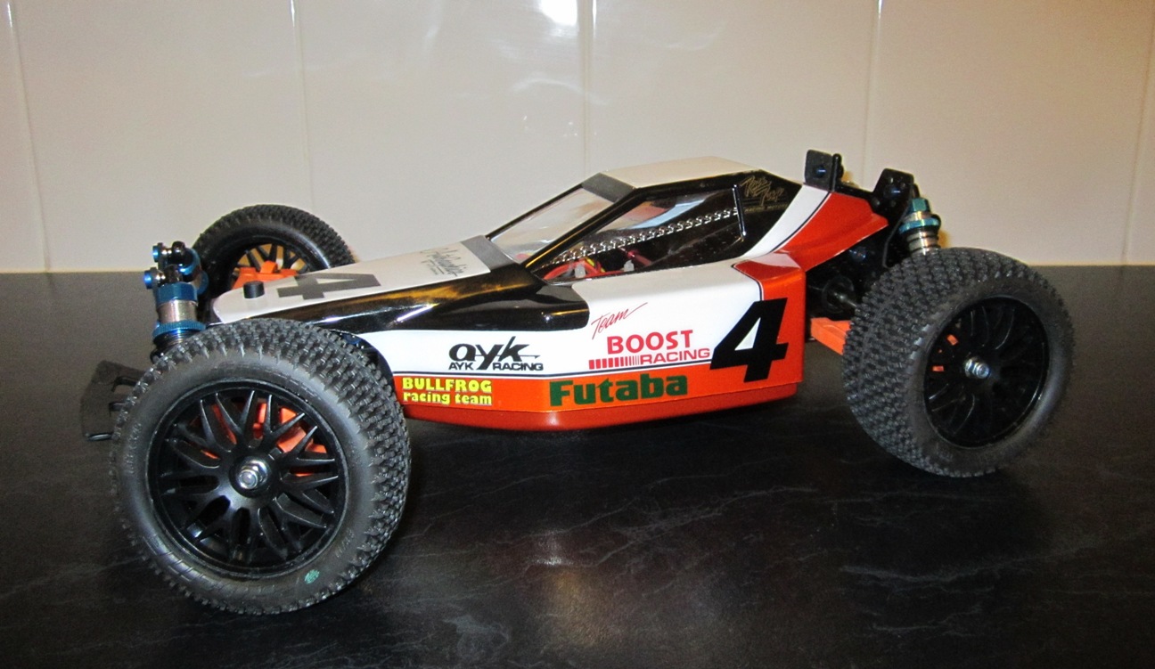

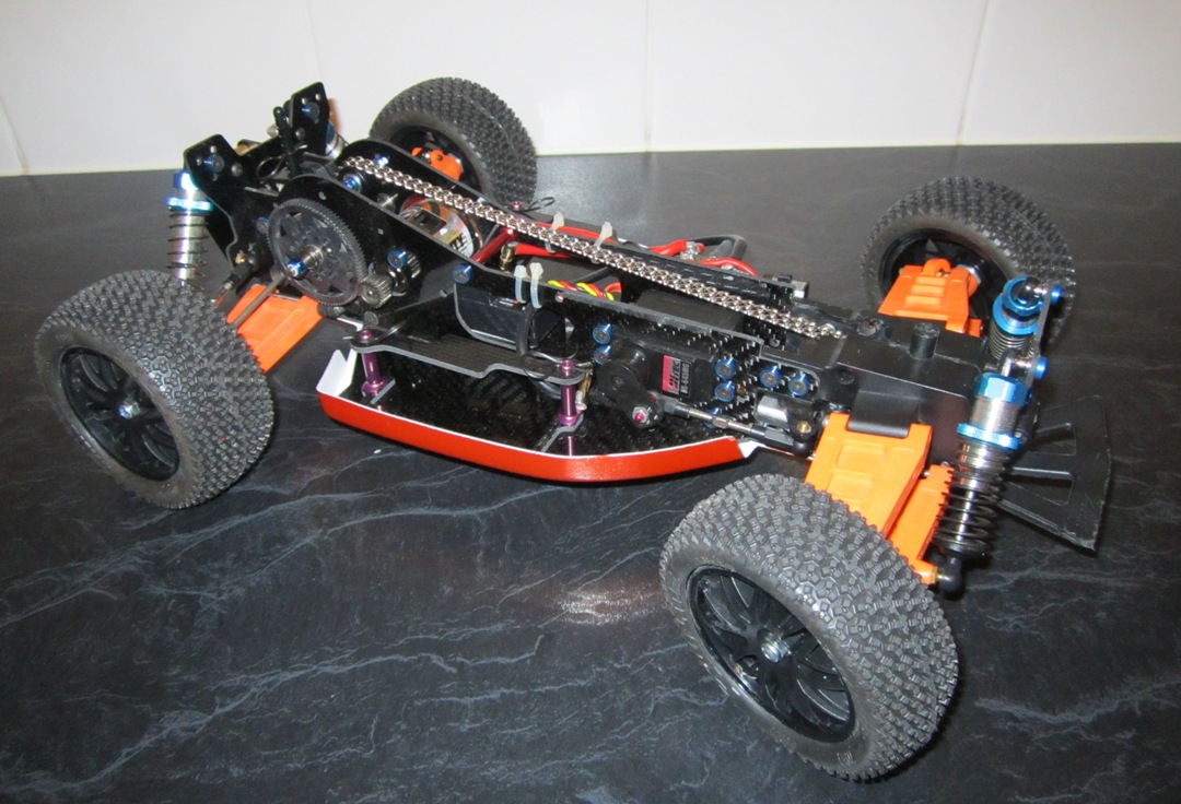

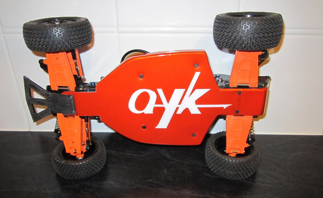

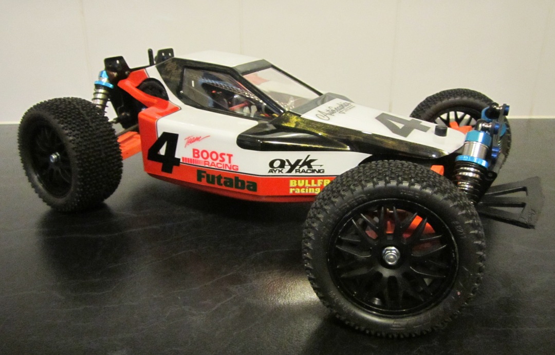

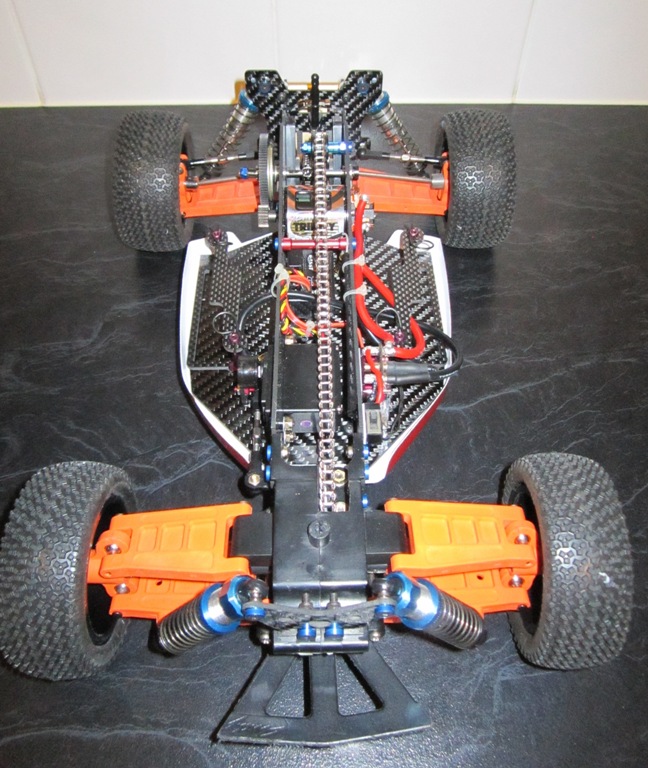

Re: AYK BOOST BUILD
Hi all, this one has been along time coming, finally just about ready, I've changed the whole chassis to carbon fibre, gone back to chain drive, using Kyosho Optima diffs, Avante UJ's and steering, Kyosho Lazer ZX5 rims,ran it a few times, nice and smooth, also Vac formed a bottom tray as well. Need to finish the rear wing, then out to the track.
cheers Bullfrog
cheers Bullfrog

Re: AYK BOOST BUILD
Looking wonderful, but you really need a wing for a runner.
It will render the car far more stable in the straights and does wonders keeping the car from rolling when jumping.
