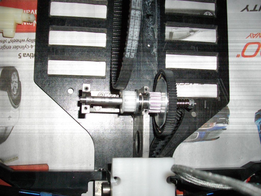

Yeah Jason I machined the pulleys, I still have to make the side things to hold the belt on.

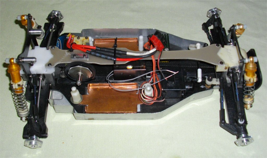

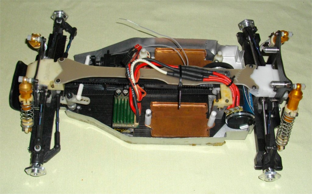

Almost finished the thing, this is the finished centre slipper & pulleys setup, turns out the front belt is so tight with the top brace I don't need to worry about a tensioner

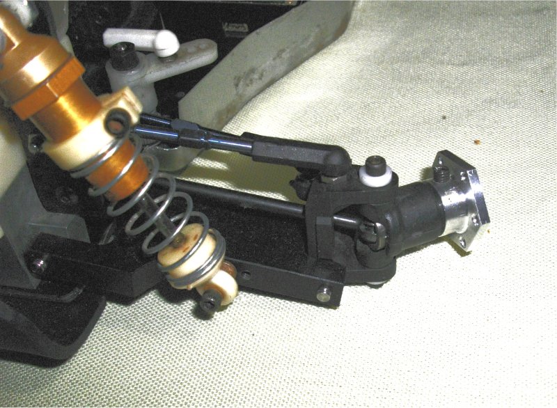

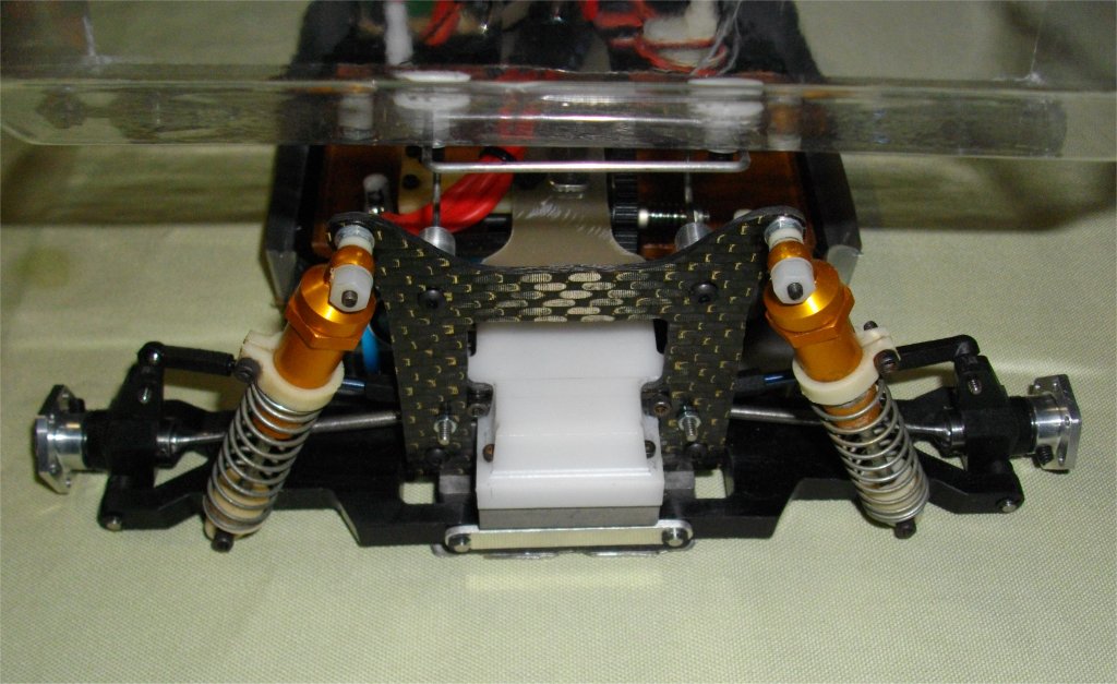

Found that RC10TC3 steering knuckles have exactly the same geometry as the original magnesium ones, but they take imperial bearings. So i'm running 1/4" ID bearings all around with custom CVA axles which go 1/4" through the bearings then step down to 5mm for the wheel adaptors. B44 front driveshafts ended up being the right length for the front, I made some custom driveshafts for the rear. Made new shock towers out of carbon fibre and a top brace out of fibreglass (still have to etch the copper off the other side), rear tower is screwed into the rear bulkhead cap, front tower is braced to the bulkhead cap through the balljoint mounting holes with some angle aluminium. Had some bottom loader 0.71" shocks lying around so I switched to those on the front and made the tower higher to suit. Still have to rebuild the shocks though.
For mounting lipo batteries I bent up these copper trays, was pretty easy to make them. Not sure if I need the extra weight though. For the rest of the electronics it's got a Mamba Max, 5.5t motor, KO Propo digital servo and the Corona receiver which I still have to mount the antennas properly.
I made all four suspension arms from delrin, the front arms are the same as original rear arms without the toe in angle on the outer holes. Rear arms are 870c at the inner end then made longer to suit later offset wheels with 1.5 degrees toe on the arms and 1.5 on the RC10 hub carriers. Found that RC10TC3 steering knuckles have exactly the same geometry as the original magnesium ones, but they take imperial bearings. So i'm running 1/4" ID bearings all around with custom CVA axles which go 1/4" through the bearings then step down to 5mm for the wheel adaptors. B44 front driveshafts ended up being the right length for the front, I made some custom driveshafts for the rear. Made new shock towers out of carbon fibre and a top brace out of fibreglass (still have to etch the copper off the other side), rear tower is screwed into the rear bulkhead cap, front tower is braced to the bulkhead cap through the balljoint mounting holes with some angle aluminium. Had some bottom loader 0.71" shocks lying around so I switched to those on the front and made the tower higher to suit. Still have to rebuild the shocks though.

can you explain a little how you made the double slipper pad work on the original shaft please?
(I don't own a B4 and have no clue on the dimensions of the parts involved)
Re: 870c project
I had to make the shaft from scratch on the lathe, goes 5mm through the bearing then steps down to 3/16", the inner plate & pulley is pinned to the shaft and I milled flats further out on the shaft to take the standard outer B4 plate, from there out it becomes a copy of a B4 shaft.
Re: 870c project
Nah I machined that part aswell. Does the MR4 BX one have the same number of teeth? I didn't know about the MR4 BX setup until after i'd made this one, that would've been easier to use if they're still available. I also wonder if the MR4 BX pulleys would fit the 870C outdrives.

Re: 870c project
The Mr4 BX slipper pulley is almost an exact fit. I have tried it against the yz10 slipper centre shaft and although it dosent fit it would be possible to make a custom centre shaft that would allow you to use the upgraded slipper, you then make the shaft to use either the centre one way or older centre slipper assembly.
I have a spare MR4 BX slipper I could lend to you if you want to try it.

Thanks for the offer seasaw but I should be ok to just use the one i've made already, it won't be too hard to make another if I wear it out. The wide diff pulleys were the worst part to make, with so many more teeth to mill out, if MR4 BX ones could be used instead that would be good.
