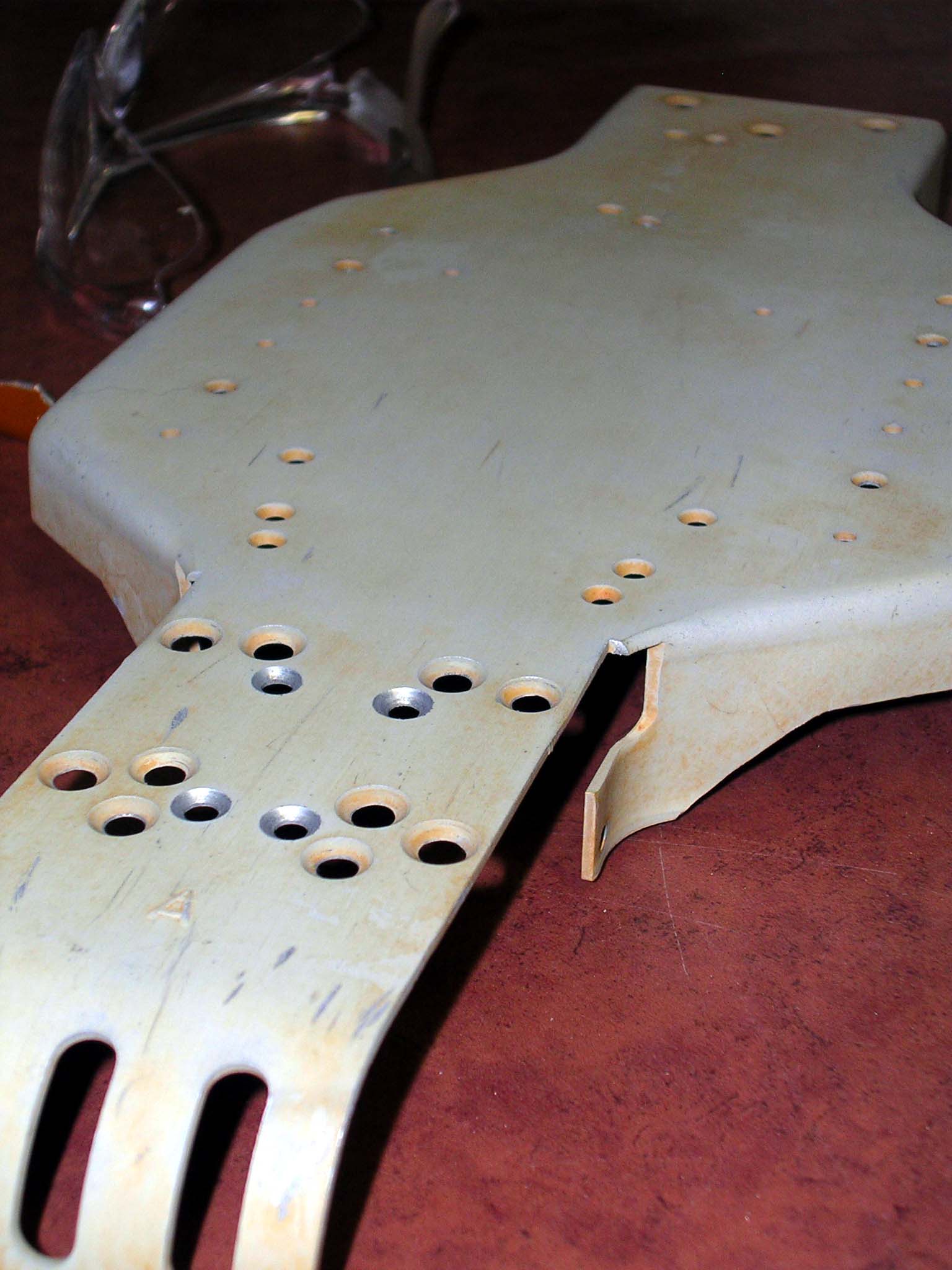

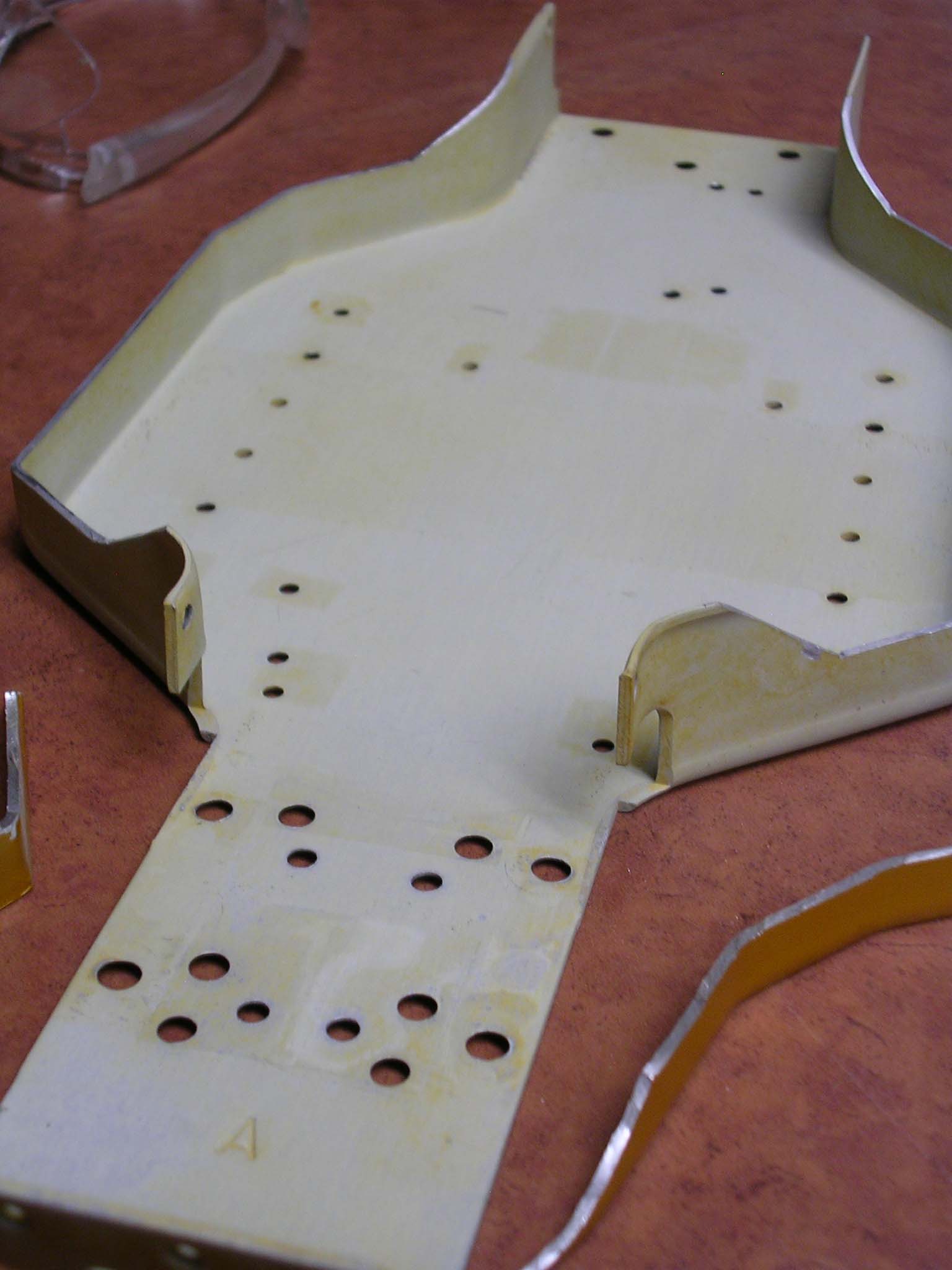

hey flipwils11, I wouldn't just go drilling your chassis without trying other things first. Having said that, I just drilled, cut and removed the anodizing of an A stamped chassis today. They key thing is that you are using the chassis and are going to continue to use it. Weather or not you but four new holes in it to install a stealth trans or continue to scratch up the bottom by driving it, which you are going to do anyway, I don't think makes a difference.
Here mine all cut up and drilled just to make you feel less guilty

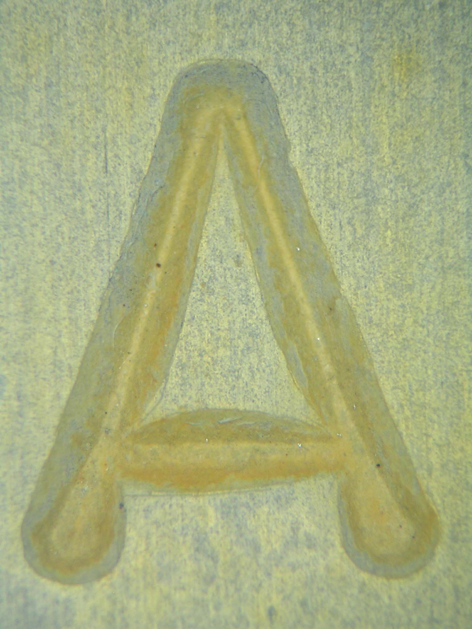

Rod just called me and said that you better put that chassis under your "special" microscope, because that chassis is not fully de-anodized

I don't want to take away from the help flipwils11 wants from this thread, but Reggie you are right. I took a look under the microscope and there is still quite a bit leftCharlie don't surf wrote:Rod just called me and said that you better put that chassis under your "special" microscope, because that chassis is not fully de-anodized
