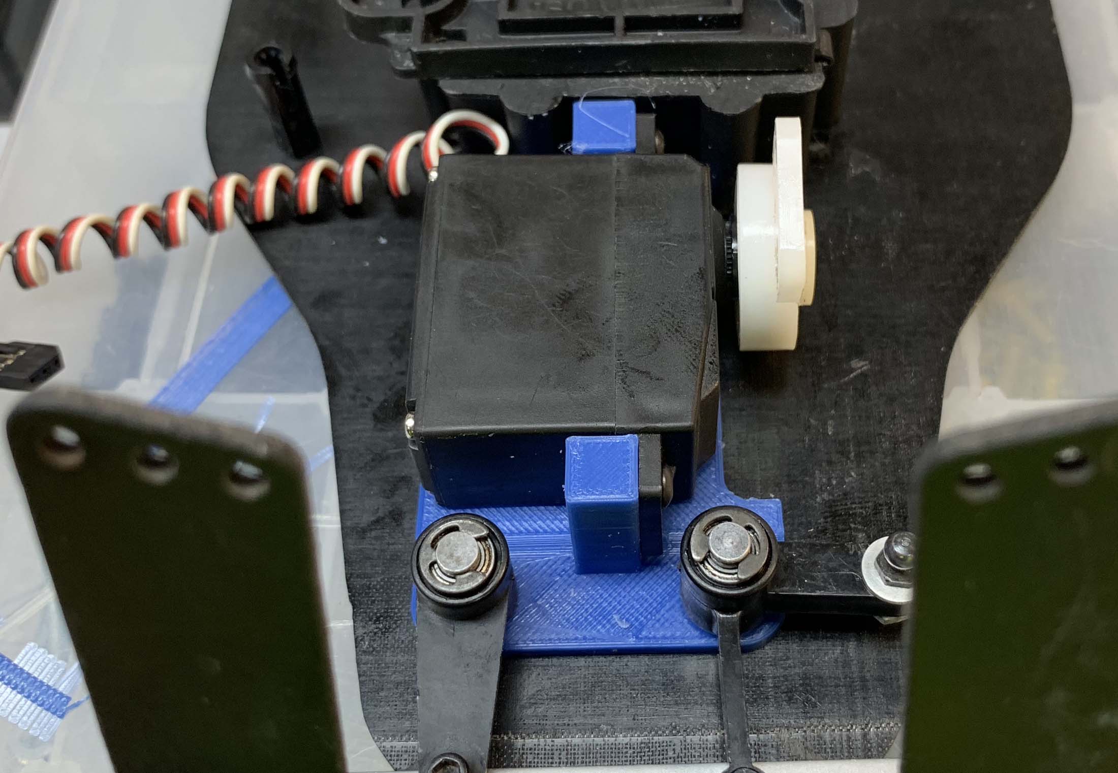

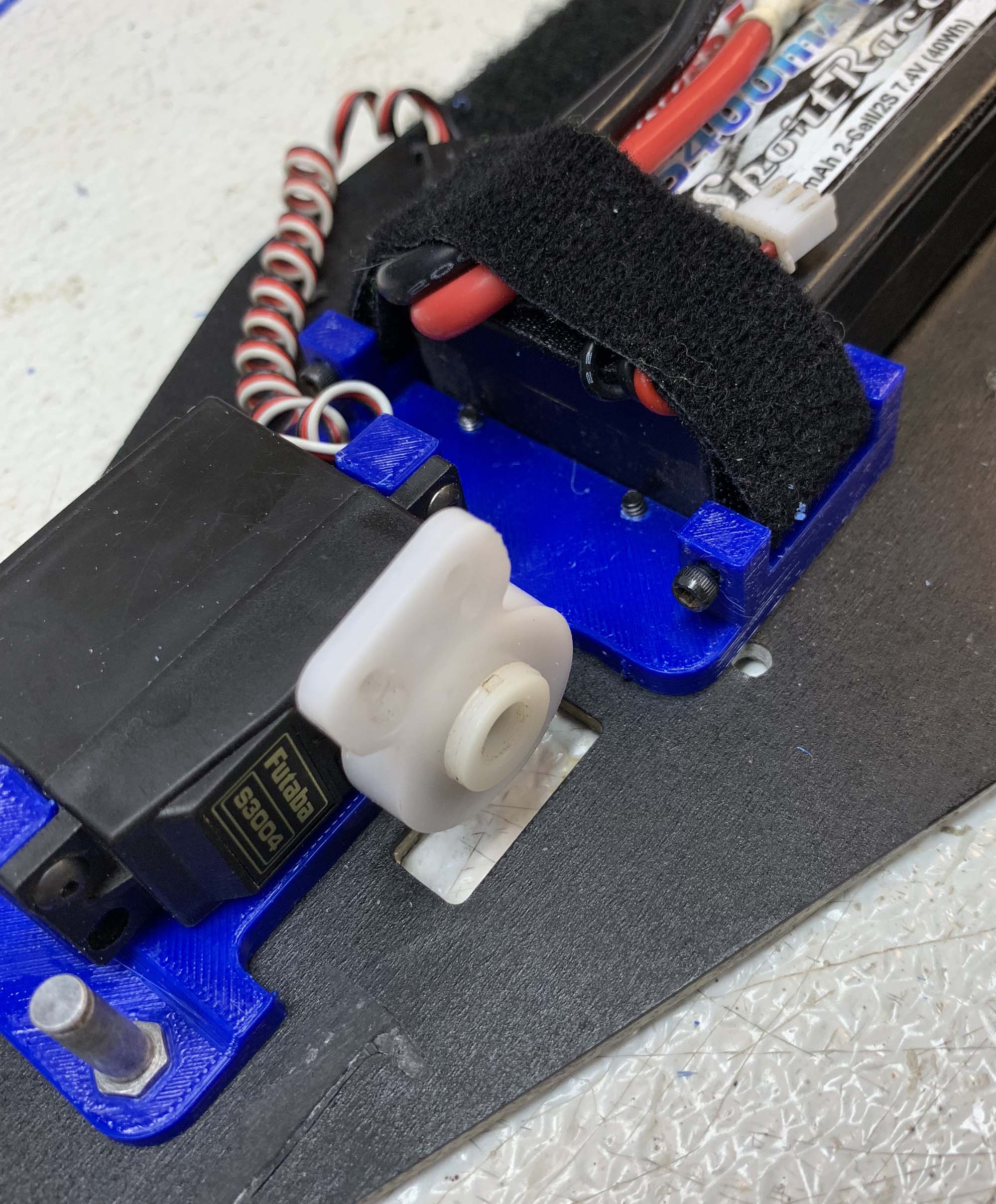

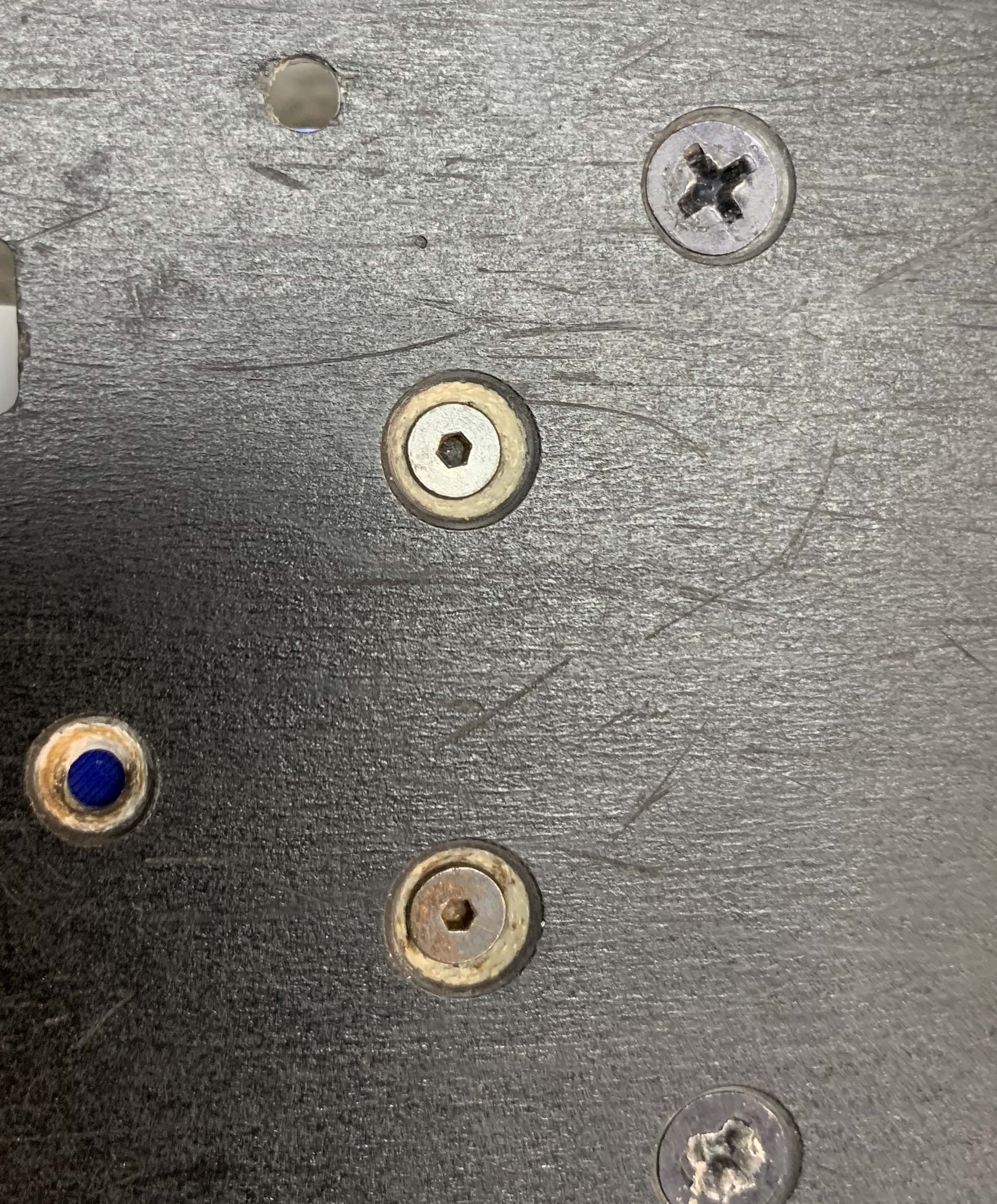

Pet peeve of mine with the old school losi cars is the often random appearance of drilled holes in the chassis, mostly around the steering servo. I decided to give a try at designing a mount to eliminate the need for drilling but that would be stronger than servo tape alone.
This is what I came up with:

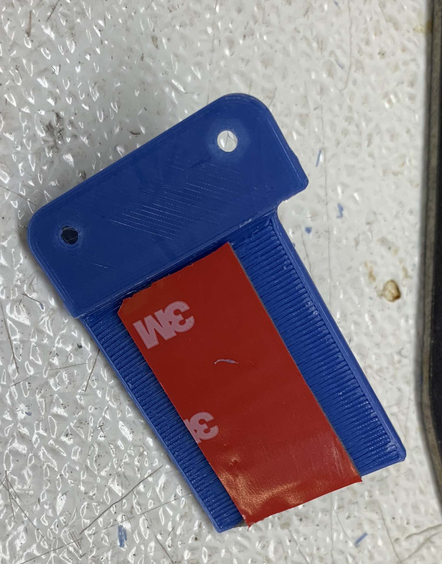

It has a recess on the bottom for servo tape

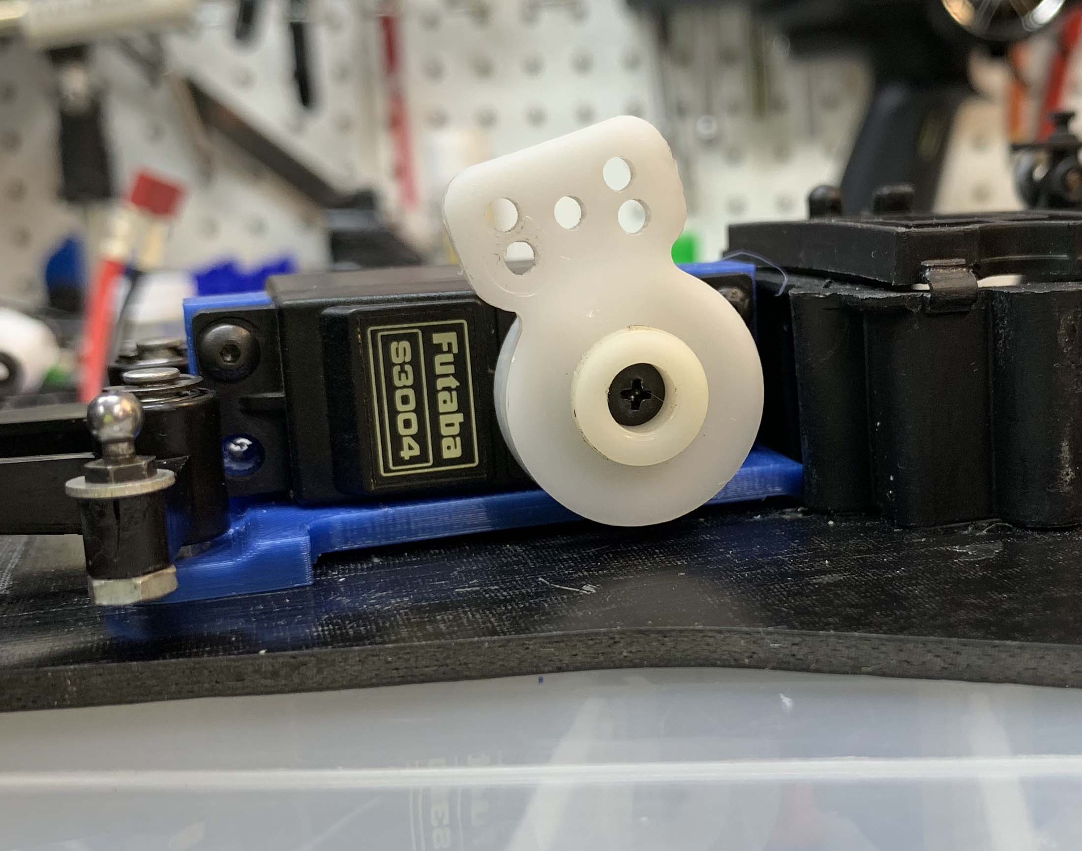

And ties into the steering bellcrank posts. It raises the posts up 1mm which will also help prevent the ballstuds hitting on the chassis and making arc shaped scratches as it goes through its travel
It is raised enough to give clearance for a large servo saver even on chassis without the clearance hole.

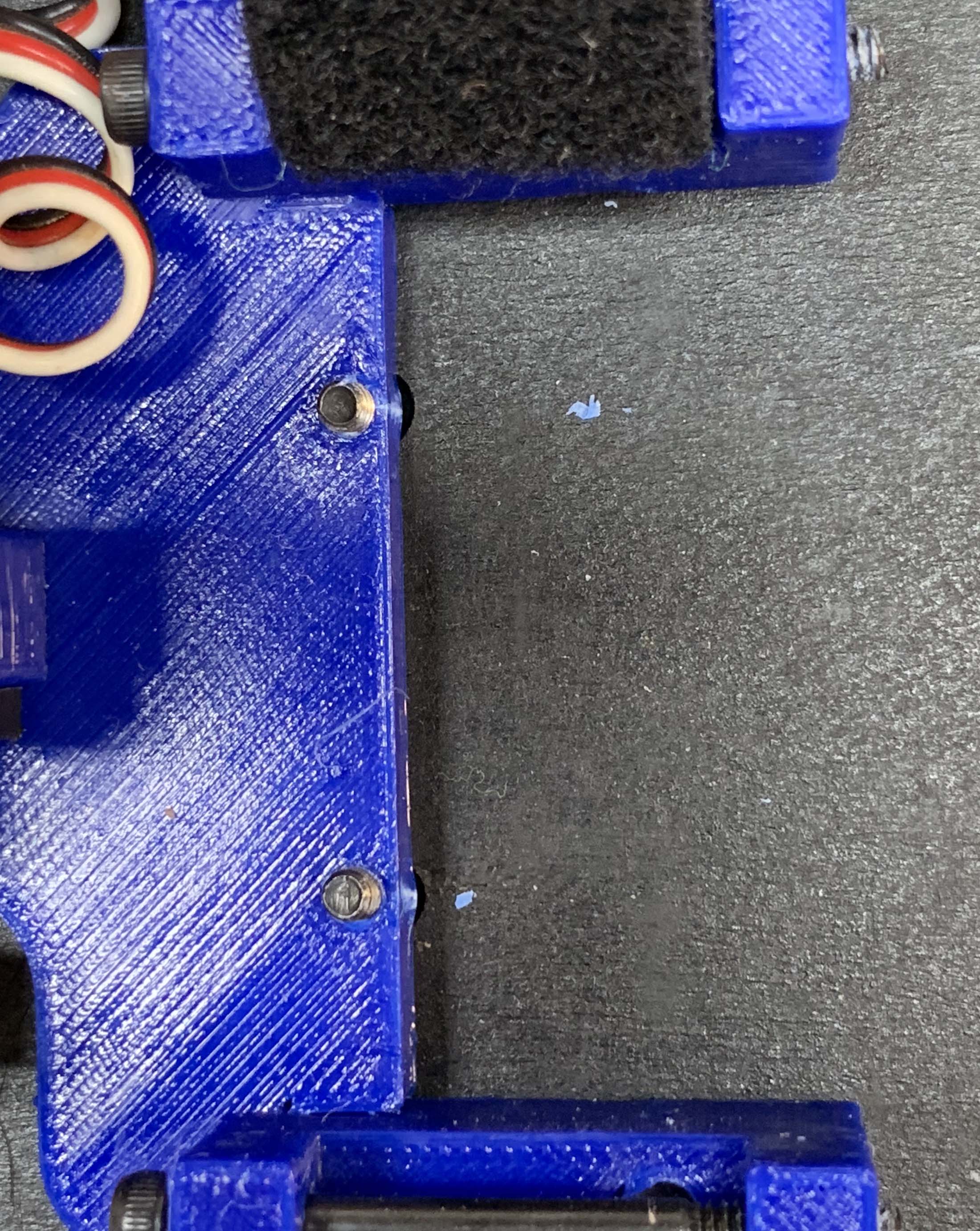

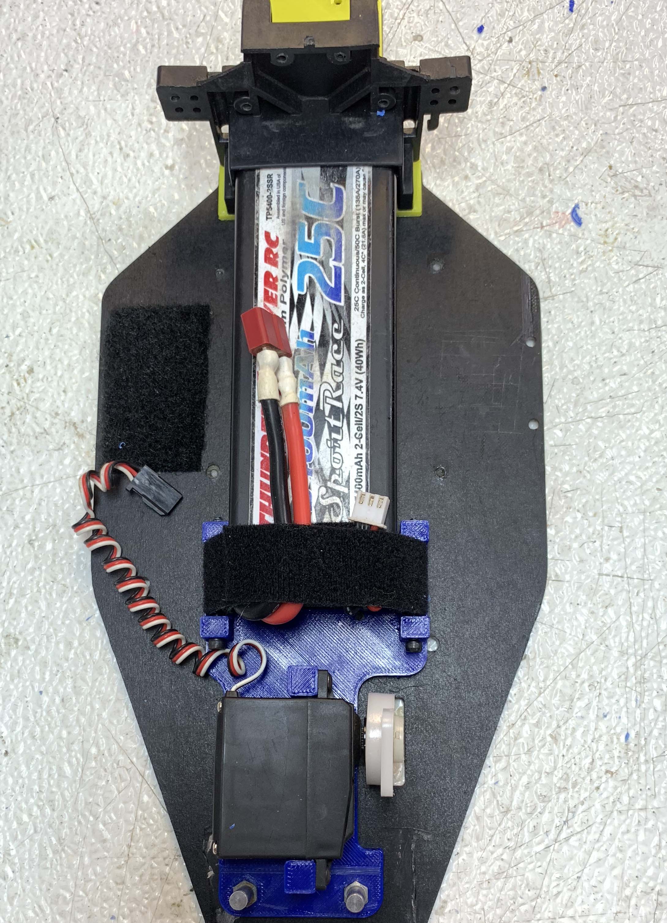

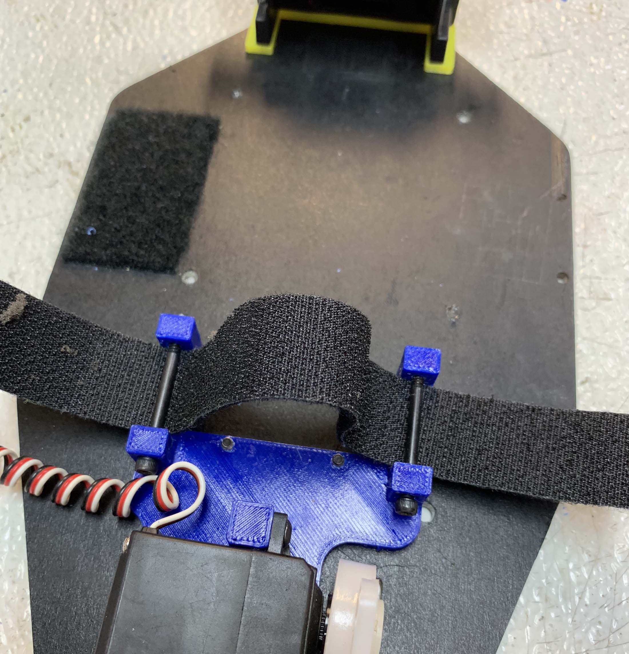

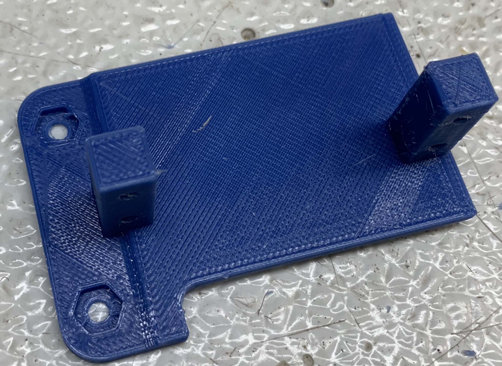

As a followup to that design I extended the mount to the rear and added a couple bosses on each side through which a 1-3/8 transmission screw is used to hold velcro for a battery mount. This gives a little more length to the battery mount area and extra height for modern batteries. It also ties the servo mount into the battery box screws so no need for servo tape and it uses all stock screw locations. I used 4-40 screws in the inboard/forward 8-32 battery box holes as this gives the extra clearance needed for the longer battery. At the rear of the car is a shim, printed in yellow, that raises the whole rear assembly up to give more height to the battery opening in the bulkhead for todays taller lipo packs.

I have printed in pla, petg and abs. All seem to work well. The taped on version keeps the servo well planted for bench testing. I have not yet had a chance to run any of them for real testing.
