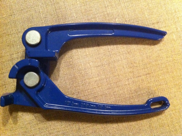

I’m satisfied with outcome of the motor plate, it’s adjustable and sturdy! I have finish the cage and gearbox guard. I made it out of 6mm aluminum pipe and rod. They are screwed together with M2 screws.

My first thought was to weld it together, but I don’t have a hobby room where I can use an open flame. Otherwise is rather easy to weld/sold aluminum.Mr. ED wrote:wow, that's a real nice job you've done. I would never 've imagined you could make such a tidy looking cage without welding.

Re: “Blueprint” Scorpion!
Great job !! How did you bend the pipes? Have you heated it? Usually arise in aluminum cracks or breaks !
