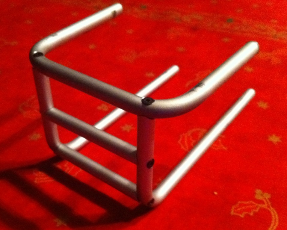

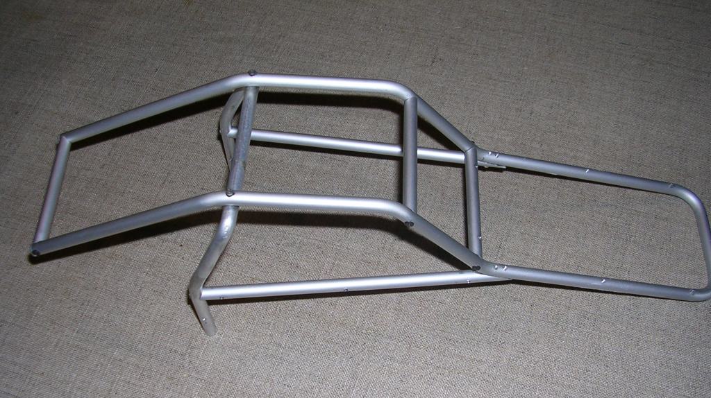

A new year is her, and I have some updates.
Well, my son wasn’t right… I manage to get it right the first time! And I have already started to plan for the second motor plate, and I think I know what I gone use it for… :mrgreen:
I’m satisfied with outcome of the motor plate, it’s adjustable and sturdy! :D
I have finish the cage and gearbox guard. I made it out of 6mm aluminum pipe and rod. They are screwed together with M2 screws.
I have also started to make the nerf bars, but I did a mistake and run out of the 5mm aluminum rod I have chosen for nerf bars. But the supplier open’s up again on Monday after the holydays.

wow, that's a real nice job you've done. I would never 've imagined you could make such a tidy looking cage without welding.
What do you plan using for batterypack? With the moter in front of the rear shocktower you're either going to have to go lateral or with a hump-pack I guess?

nice job are you going to polish the cage ?

Mr. ED wrote:wow, that's a real nice job you've done. I would never 've imagined you could make such a tidy looking cage without welding.
My first thought was to weld it together, but I don’t have a hobby room where I can use an open flame. Otherwise is rather easy to weld/sold aluminum.
About the battery, I think I gone cheat and use a small LiPo S2. Another alternative is to place one C-sub cell on each side of the motor and 4 in front of the motor.

treehugger wrote:nice job are you going to polish the cage ?
Tanks!
No, I don’t gone police the cage; it will be painted red as the original buggy. Nerf bars and the motor guard will be polished I do time I think.

:shock: Great job !! How did you bend the pipes? Have you heated it? Usually arise in aluminum cracks or breaks !
