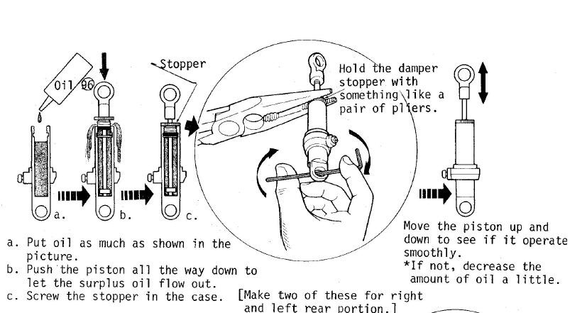

I'm trying to rebuild two red Kyosho shocks from an early Optima. They will be mounted to a CRP front suspension kit on a Tamiya Striker :D . However, after three tries at rebuilding them, I gave up because of two problems:
1) The o-ring seals are shot. The shocks leak terribly. :cry: Can I replace the o-rings by Tamiya o-rings, or did Kyosho use o-rings with different dimensions?
2) How far are you supposed to fill these things with oil? The first two times I tried I couldn't get the cap fully on (could not be screwed down), and the third time I had a shock that had zero rebound while the shock shaft could not slide further than halfway up the shock body... :evil:
Could someone please help and tell me how you are supposed to rebuild these things?

You will find new O-rings at CRP (http://www.teamcrp.net/).
Follow the instructions on the picture! :D
Cheers
Lars

Thank you for the instructions! That will certainly help. :D

I tried rebuilding some Kyosho red shocks that were originally installed on the Marui Galaxy I restored, and I must've had bad O-rings too, as they just leaked. I also found they were picky with the amount of oil needed; a little too much and they wouldn't compress.
Now I have a full set that I'm not using.
