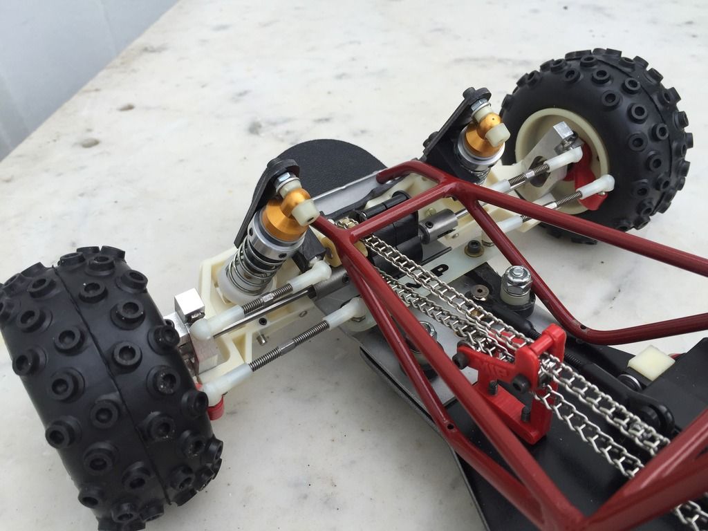

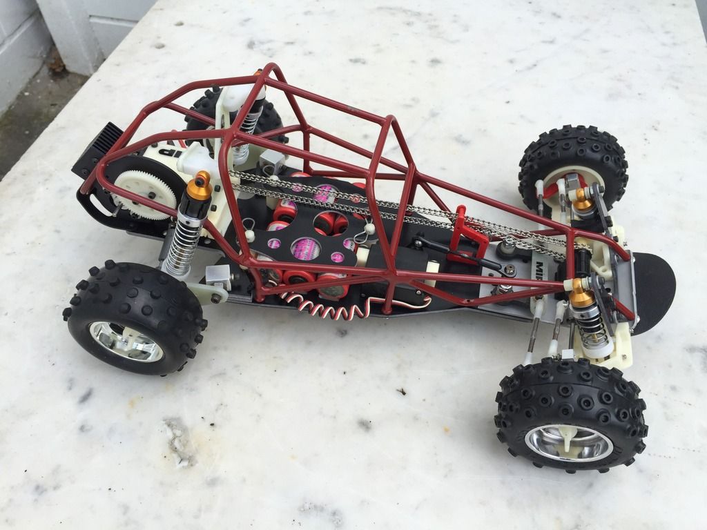

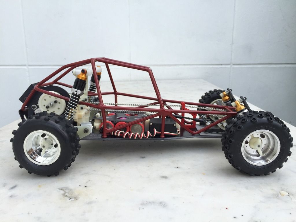

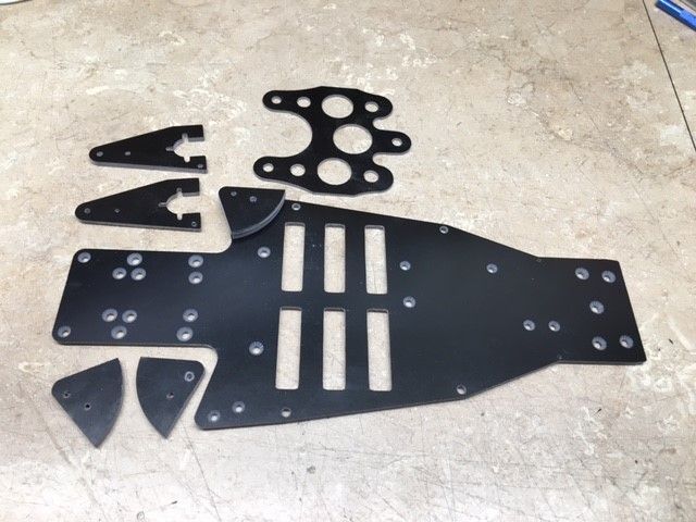

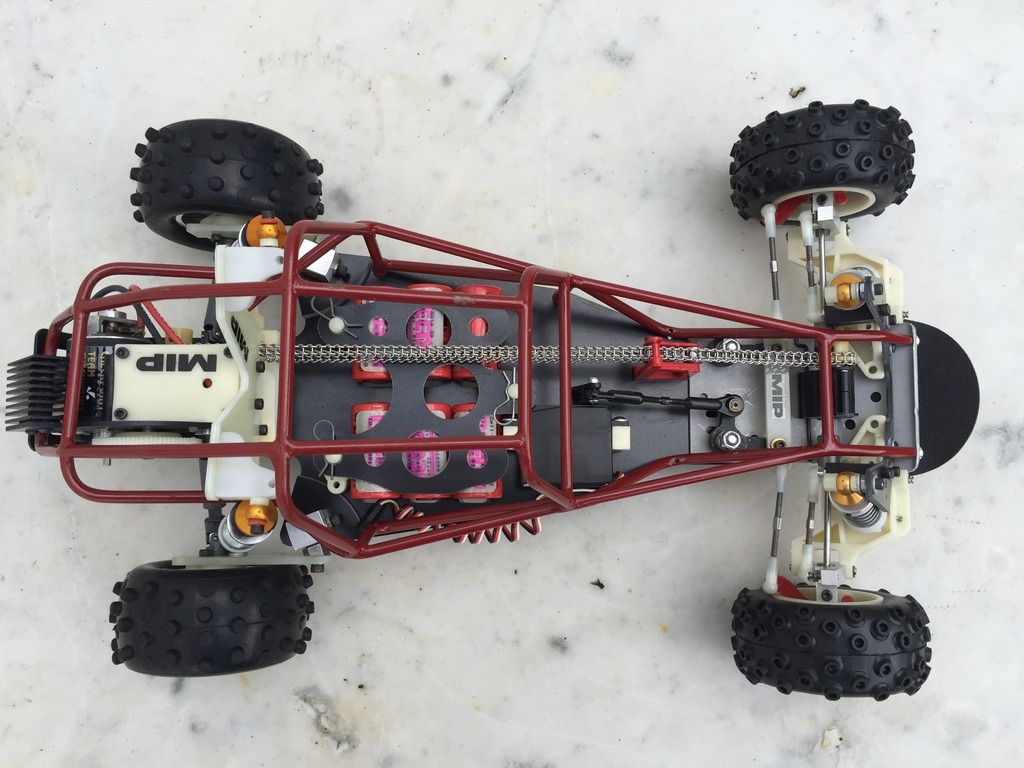

In the meantime, many ideas crossed my mind in terms of chassis possibilities and since I really wanted this build to be feature a tuber chassis, I decided to use the cage of another completed build and use it for this project. Fitting the front gear box along with the chain and the rear trailing arms turned to be a real puzzle in terms of layout and design if using the existing chassis. I hence decided to draw my own chassis and have it cut by Jeff aka Gomachv. I also wanted to include a 2x3 battery layout and get rid of the G10 bar that is supposed to be used to mount the rear trailing arm mounts. Two pieces of black G10 were used on each side to raise the height of the alloy trailing arm mounting blocks and I also designed a battery holder much inspired by the one Masami made for his RC10GX that I now own.
Lost of fitting, adjusting, filing and grinding were necessary to get to the first result you see below and I'm still not done! The next steps include installing a mono shock setup in the front, enhancing the steering setup, replacing the grey nose plate with a black team car one, finding back the rear Losi wheel covers and using Proline Octigrabs on all corners, and eventually fabricating a roof top along with side panels out of lexan. I have ordered alloy parts that should help me to make the inner front camber links more sturdy. I had to be quite creative to flip around the front shock tower
. Anyway this is already presentable and I'm quite happy with how it looks so far.
Thank you Jeff for the awesome work on this:

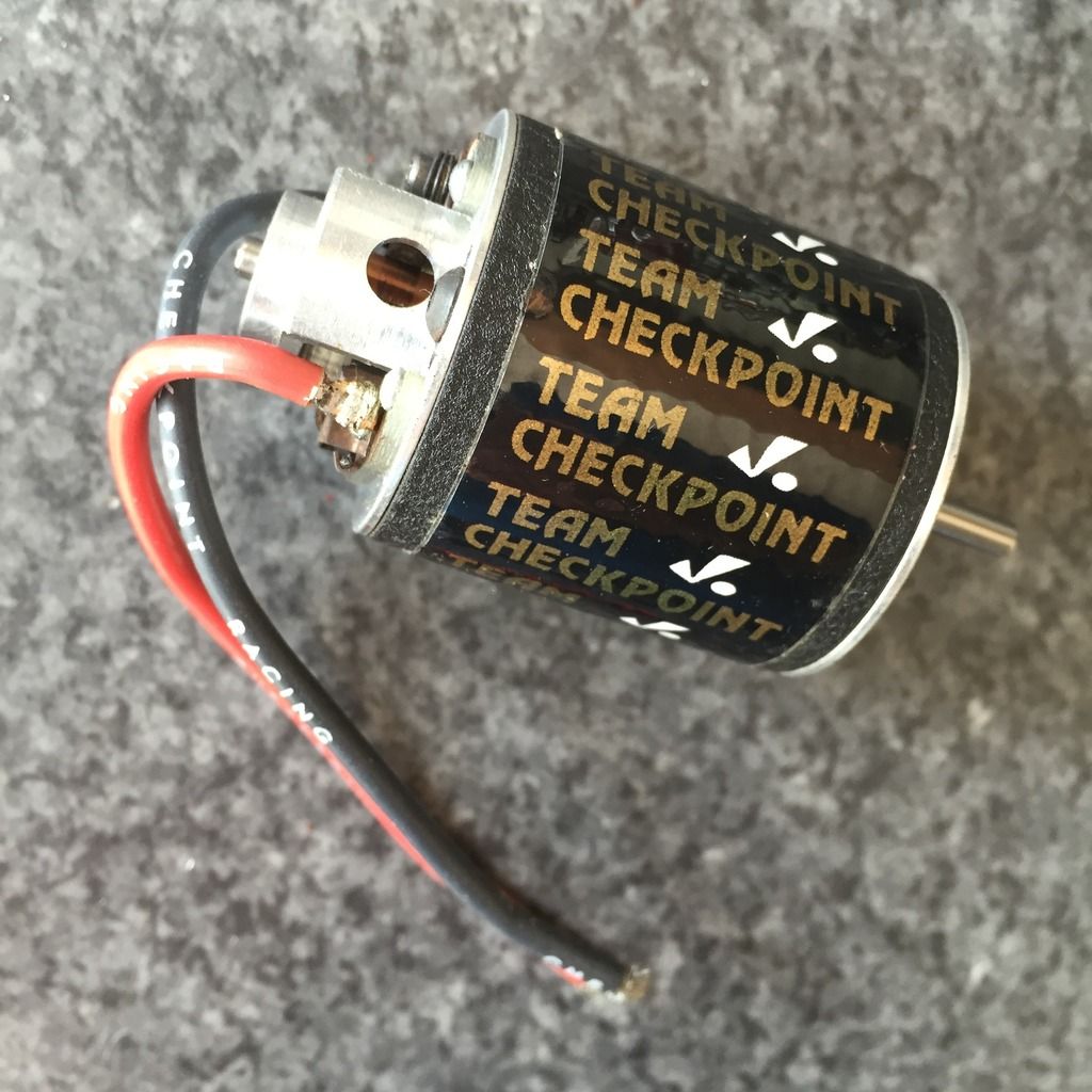

You don't see a NIP Checkpoint so often!
