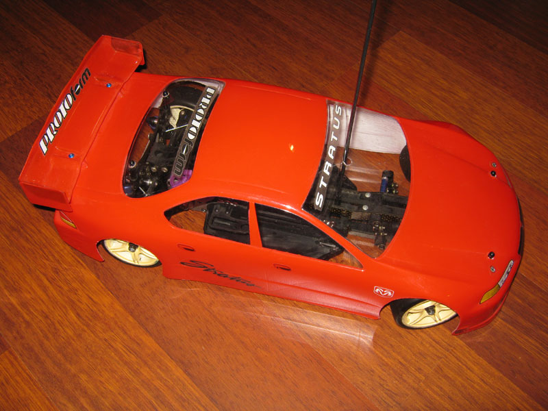

...or Neo Classic Optima Touring Car version, as I prefer to call it.
Kyosho's slogan for this thing is "Beyond the Extreme", and it's exactly that.
Here's how I got it, with a Dodge Stratus body and a Team Atlas 23 Turn motor: The KX-One chassis is unique in that it uses two vertical chassis plates in between which the transmission system is sandwiched. The chassis has zero options installed and is completely stock, but being a Kyosho competition chassis it is still loaded with goodies. Let's have a look.
The front end has loads of carbon, alloy shocks, foam bumper, a swing bar, full turnbuckles, ball bearings, and a front one-way unit. The front one-way is not shot, which is great, as the KX-One's front one-way is notoriously fragile and might break in less than a single run. Note that the steering links don't use the traditional touring car system but are directly connected to the servo: More carbon at the rear, which has very similar equipment as the front. The rear uses a ball diff. Metal motor plate with no fins: It comes with full ball bearings, some titanium screws, and CVD-style universals on all four corners.

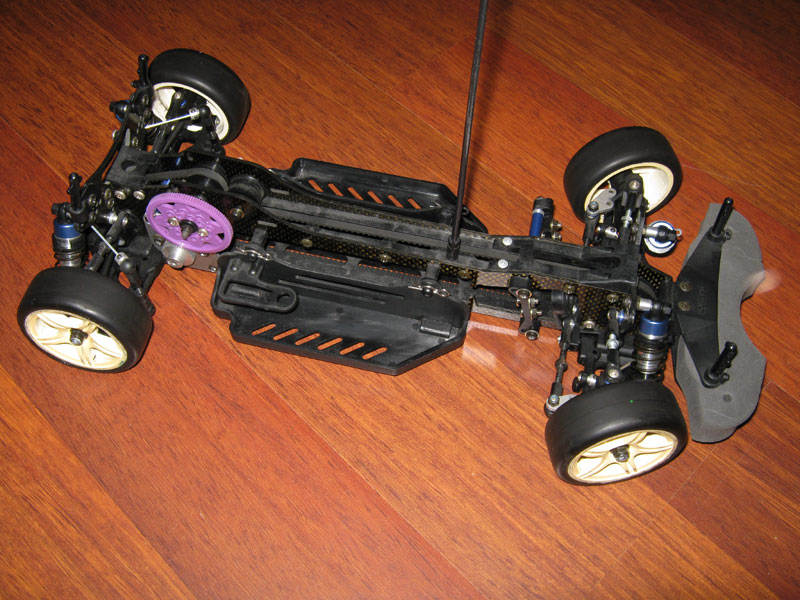

A look at the bottom of the car, with the single belt design having the belt run level with the bottom of the chassis: So where does the battery go in this thing? Well, the two bathtubs on the sides of the chassis can be removed, and the battery fits in the exact centerline of the chassis, in between the bathtubs. The bathtubs don't leave a lot of room for electronics. The steering servo fits into a frame just ahead of the battery location: So yeah, "Beyond the extreme" indeed.
Removing both bathtubs gives the car even more of a classic Optima look: And this is the room that's available for the servo and battery : But obviously I don't think this car is "Extreme" enough yet, so here's the options I sourced for it: The ones I'll use are the blue finned motor plate, alloy suspension holders, one-way front universals, racing battery holder, and the aptly named "Insane Sift (sic) Change" 2-speed option (which cost me about as much as the whole car, spare parts, and other options together ).

That's a pretty cool unit, there! The little half-tubs are kind of odd. I myself was toying around with the logistics trying to mount a battery longitudinally between the Optima's 2 frame-rails, below the radio plate, but gave up on the idea as it would require some major re-engineering...

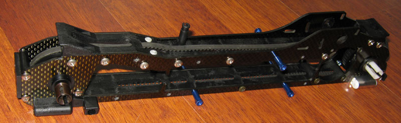

I first took apart the whole car and cleaned all of the parts thoroughly. All parts that could were cleaned in some water with some dishwashing liquid. Since the rear diff was correctly set up and still extremely smooth I didn't bother rebuilding it, I only wiped off the minimal grime. I had one problem: The manual calls for threadlock to be used on part of the CVD-style axles. The previous owner used some kind of extremely sticky thick goopy grease instead that made taking apart the universals a major pain in the behind, and that also had ran into some of the bearings, fusing them to the CVDs in a sticky mess . I had to resort to soaking the CVDs in WD-40 overnight to get them apart. I was extremely happy I had some spares to replace the collars that prevent the CVDs from disassembling themselves while running, as they ended up all scratched up from the pliers I used to wrench them off.
A look at one of the chassis plates: Both chassis plates are the same, and have some extremely scary thin carbon fiber bits near where the motor goes through.
To this chassis plate I bolted the various reinforcement parts, using some spare titanium Kyosho screws I had instead of the steel screws. At this stage I also had to install the suspension mounts, which are screwed into place from the inside of the chassis. I installed the optional alloy mounts at the rear. I also put the spacers for the optional racing battery holder in place: Then I had to add the transmission system and the other chassis plate, which require special four-handed people or some inventive propping up of the already assembled part of the chassis (as I did, lacking two additional hands). Now access to the transmission on this car is about as bad as on the Optima MID; the whole car needs disassembly to reach the transmission. The rear delrin diff outdrives are stock, by the way: Then I installed the blue finned motor plate, 2-speed, and one of the racing battery holder side plates, as well as some other parts: A better look at the rear, showcasing the alloy motor plate and 2-speed: Next: suspension arms.

Hmmm.... a cursory glance at that chassis plate has me thinking "carbon PB Mini Mustang"...diff at front of spine, then servo, then battery, then motor, then diff at rear......
