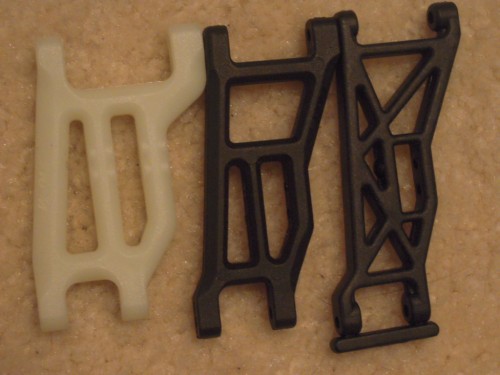

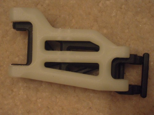

A couple of months back I contacted Dynotech about the length of their B3 carpet arms and was told they measure 2.54" pin to pin....is that the same length as the B2 carpet arms?
- Phin
- Posts: 2818
- Location: NY²
- Has thanked: 87 times
- Been thanked: 248 times
Re: What other front arms will work for an OLD IS NEW build?
To think this out some more without derailing flipwils11 B3 build thread I decided to rez this thread....Charlie don't surf wrote:The RPM B2 carpet arm was 2.54 center to center-Phin wrote:DT sells them as B3 carpet arms, and when I emailed them about the pin to pin length I was told it was 2.54"
RPM Worlds 91', RPM B2 Carpet arm, Stock B2 composite-
So if I wanted to make use of the B2 carpet arms (or more specifically the DT B3 carpet arms) I'd need to use a truck-width noseplate and either narrow up the arm mounts on a 10T bulkhead or find myself an Andy's Pro Race bulkhead. Also since the shock mount holes on the carpet arms seem to be further out on the arms than on the RPM Worlds arms I'm thinking I'd be better off with a front shock tower that's also like the Andy's Pro Race front tower.
That sound about right?
- Charlie don't surf
- Posts: 9284
- Location: USA
- Has thanked: 357 times
- Been thanked: 470 times
Just a heads up on the B2 carpet arms, the width might be close but the lower suspension holes are way further out than the Worlds 91 arms- like 3/4" per side wider-
- Phin
- Posts: 2818
- Location: NY²
Was hoping for that. Never particularly cared for how the front tower and shocks on a RPM World's set up crowded up the front nose of the buggy. With the carpet arms I'd also look to have a custom front tower made like the B3's tower...and for .89 or .71 shocks.Charlie don't surf wrote:Just a heads up on the B2 carpet arms, the width might be close but the lower suspension holes are way further out than the Worlds 91 arms- like 3/4" per side wider-
