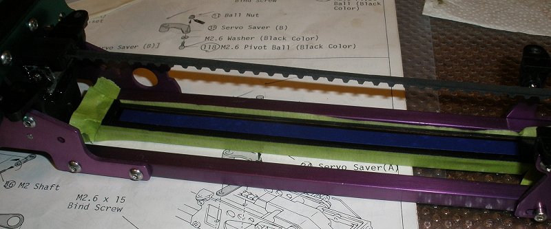

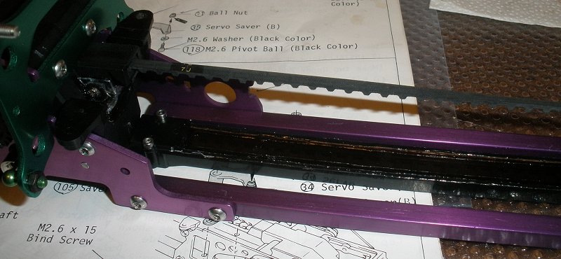

After making a mess in the past trying to seal my Optimas' chain-guides with silicone, I thought I'd share a simple technique I used to do a more tidy job. I simply mask along the outer & inner edges where I'm planning to apply the silicone, and as soon as I've applied the silicone (I use Household Goop), I remove the tape, which results in some nice, clean lines instead of having silicone drooping over the edges, getting everywhere on your car, hands, etc.
