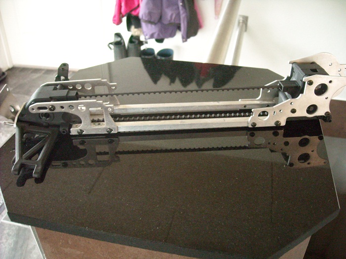

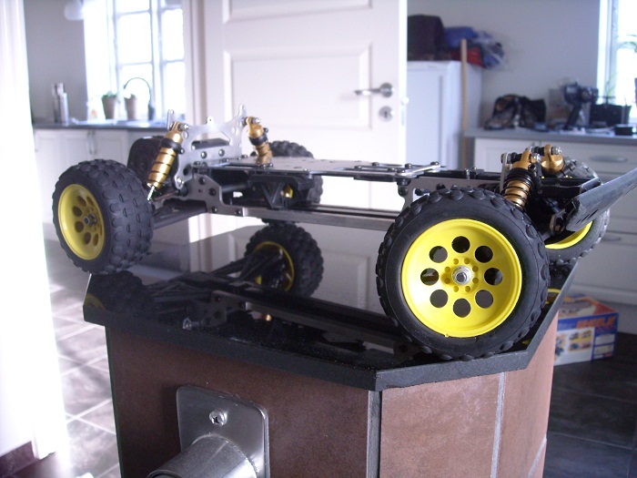

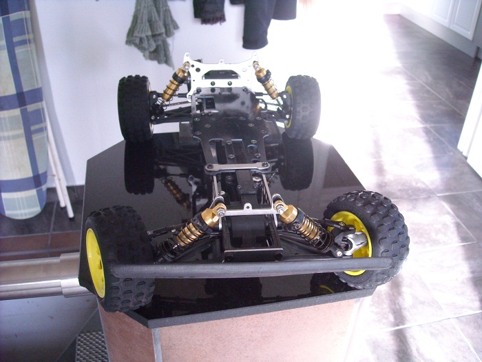

This is my first belt conversion - not much to show, but being my first conversion, I´m a little exited about it. Front diff is from the Mid and the rear diff is partly Mid and partly original Optima.
The belt is from a normal wheel base Mid. And much to my surprice, the length was perfect.

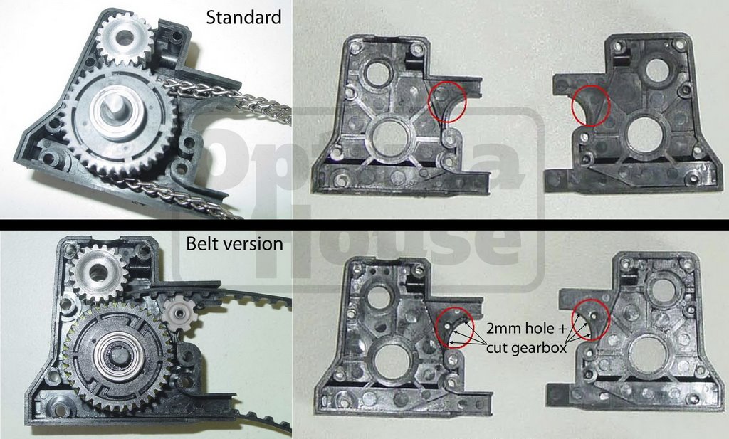

The rear gearbox is different in "real" belt conversion, see pic originally from Optima House:
The missing part from this pic is lexan cover. The "extra" belt pulley does not do much, but maybe it helps the belt to run smoother.
Jirka
Jirka

I think the belt conversion was not so popular. Kyosho's rear motor race cars were already old-fashioned when this kit was released. All die hard racers used mid motor cars that had belt drive (CAT, Mini Mustang and Yokomo) and this was Kyosho's way to buy time before their own mid motor 4wd car was ready to be released.Charlie don't surf wrote:Knowing nothing about Kyoshos, when was this popular or common? Was the car a standard chain driven optima to start, and what's changed? Sorry for the kyo noobness
Jirka
