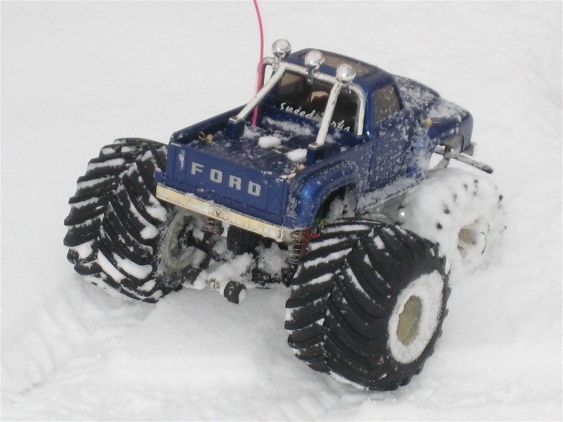

Easiest thing to do would be getting a set of imex jumbo tires and dual rims. Finding them isn't that easy though.
Another thing you can do is to modify a blackfoot rim to fit inside the clod rim, then just glue it and screw it. I did it a couple years ago to a pair to help my old midnight pumpkin get through the snow.

It was common to use a set of marui big bear tires and rims on the blackfoot. They look similar to a clods, just not quite as big.

Be careful of the diff/driveshafts if you do mount them. They're easily damaged! Get a Thorp ball diff/dogbones if you can find one.

I'm pretty sure adapters were made just for this.
As for the Big Bear tires, I remember that was a popular upgrade because the Big Bear tires had more bite, I believe the rubber is softer than the Blackfoot tires.

epoxy that diff if you want it to move for more then a minute or two.
i wouldn't waste a thorpe diff on this, just lock the stocker and get some new frog cvd's.

Bitd I took a pair of tamiya mount foam on road tires and stuck my clod tires right over them. They friction fit just great and ran for almost a whole 1200 mah pack before the splines on the drive shafts became smooth.
I do not recommend clod tires on a vintage Blackfoot.
