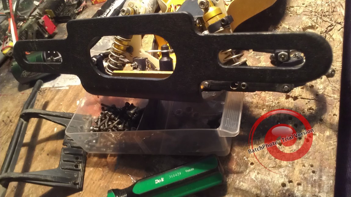

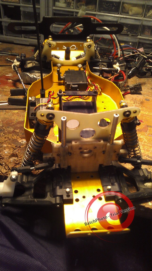

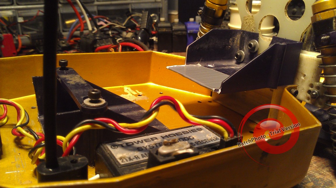

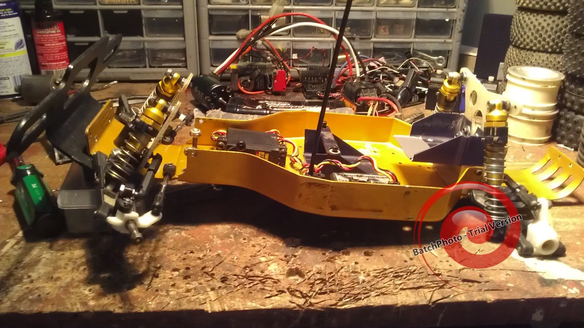

After lots more time and parts, here is what the car currently looks like. The battery cup on the back is for the esc because it was too tall to fit under the body with it's fan. The shocks are just tacked in place, they don't have any oil in them yet.
