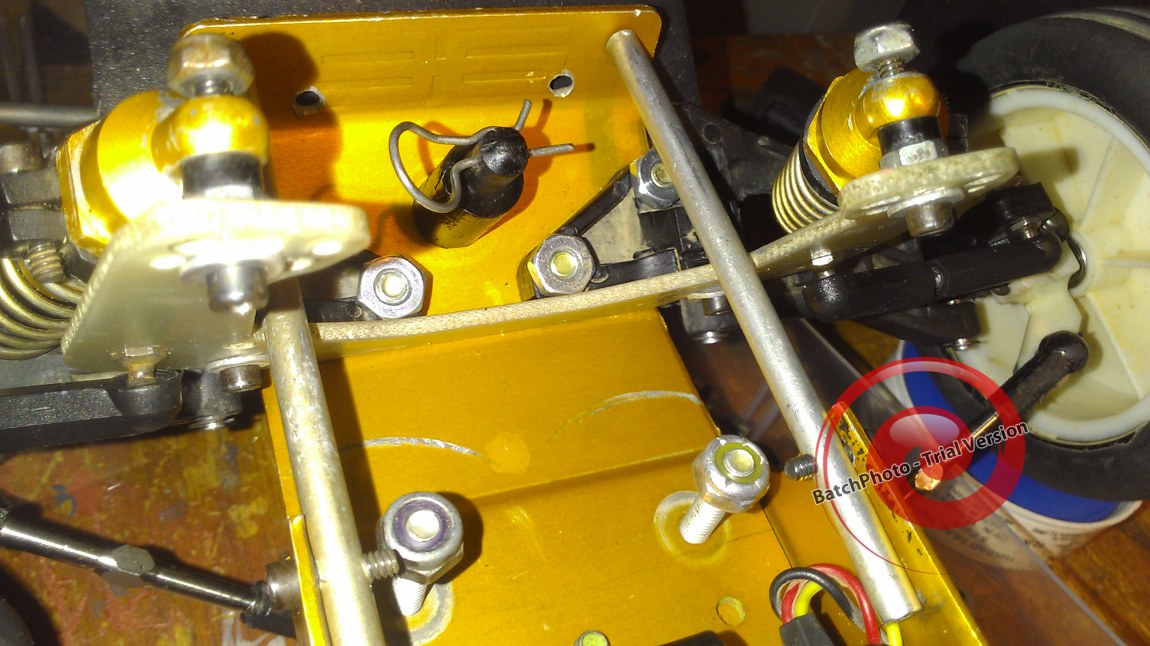

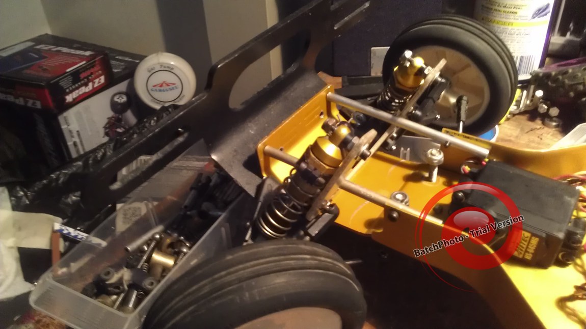

Ok wrong wording with that one. My differential appeared to be correctly assembled at the time so I may have an issue in the front end. After checking the front arms and linkage, i found that both front arms rock back and forth quite a bit when they are attached to the car. the C hubs do the same thing. Could this be causing the problem?

Yes that can DEFINITELY be the problem. I recently had to get rid of a chassis that had the sides milled to save weight. This weakened the chassis enough that it flexed REALLY bad. Caused the car to loop for NO REASON.Dave145 wrote:Ok wrong wording with that one. My differential appeared to be correctly assembled at the time so I may have an issue in the front end. After checking the front arms and linkage, i found that both front arms rock back and forth quite a bit when they are attached to the car. the C hubs do the same thing. Could this be causing the problem?
Re: Dave145's gold pan build.
It appears as if the holes where the king pins go have been drilled one size larger to stop binding or something. Guess ill have to replace those parts too...

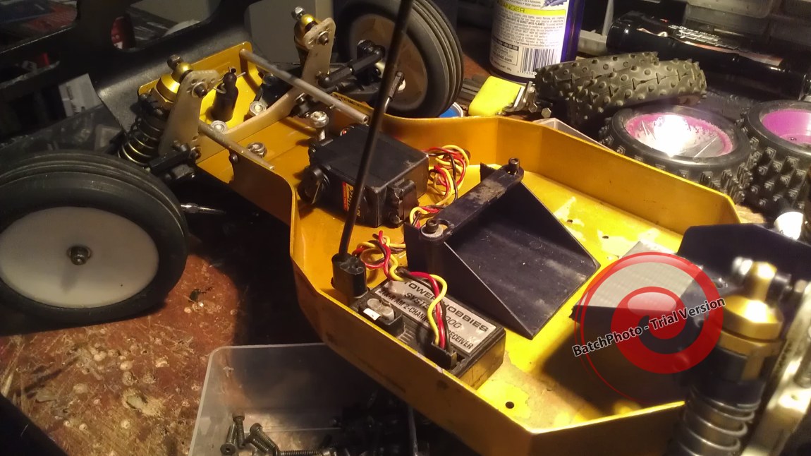

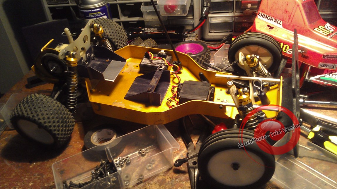

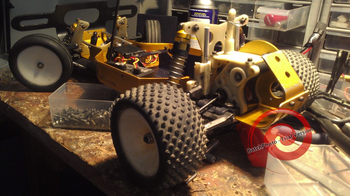

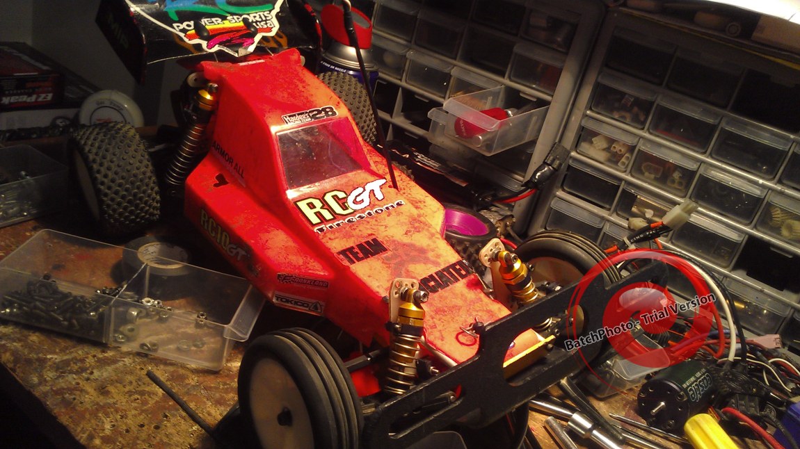

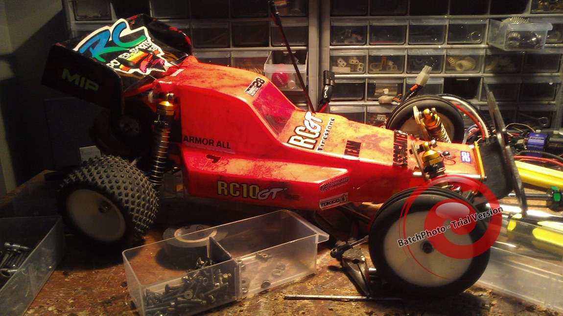

It took plenty of work but here is the car in its current state. It's waiting for some 30wt shock oil and a steering bell crank. Since I'm going to be running the car with a mild brushed system (14-17t motor), I decided to put together a decent 6 gear tranny with some of my older more worn parts to help keep my newer and better parts for spares or shelf queens. the car has no extra braces at all and a very large front brush guard/ bumper. The rear tires are half bald, and the fronts are practically new I think. I hope to put a more reliable stealth in it once I get all those parts in as well.
Also my brushless system will be going into my rc10t2 that I'll be getting some time tonight.

She looks great!

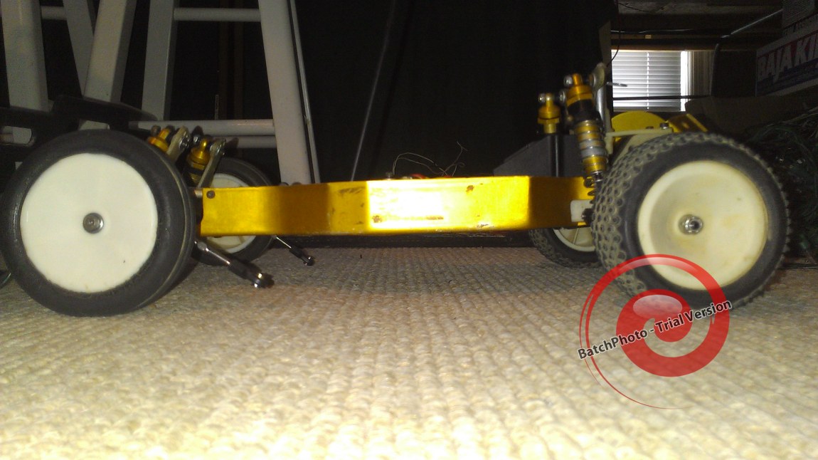

do you think the car sits too high? I tested it with my graphite and they sit about equal but it still looks like it sits a bit high for a buggy. I don't exactly remember being able to fit my whole hand under it before I rebuilt it.
I think she looks great.Dave145 wrote:do you think the car sits too high? I tested it with my graphite and they sit about equal but it still looks like it sits a bit high for a buggy. I don't exactly remember being able to fit my whole hand under it before I rebuilt it.
Best way to tell is to set her on a table with battery pack in the car. Look at the dogbones(from the rear).
They should set level with a battery pack in the car.
