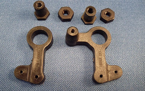

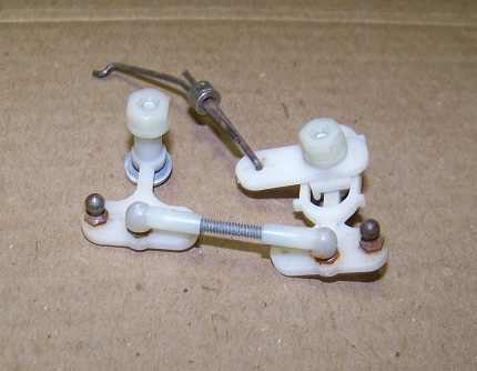

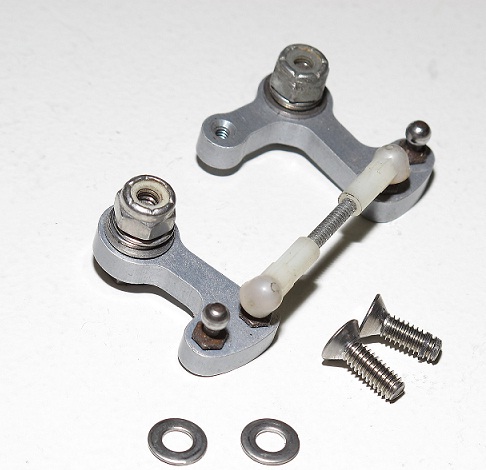

OK, here's a start:
The Stock Associated crank, used on the early production cars. Houge crank. Looks similar to the "Worlds" crank. I can tell this one by the name molded into it. Is this the old Losi crank, or another aluminum version? How can you tell? Who made this? If anyone has anything different, post it up.

Re: Bell Crank ID
I beleive those last ones were made/commissioned to be made by someone on the board here. Beleive they were a direct copy of the worlds car bellcranks...Russ Winn wrote:Who made this?

Re: Bell Crank ID
I think Chris Chan from Hong Kong sold those out of the BST.klavy69 wrote:I beleive those last ones were made/commissioned to be made by someone on the board here. Beleive they were a direct copy of the worlds car bellcranks...Russ Winn wrote:Who made this?

Re: Bell Crank ID
Hey Al,a01butal wrote:I think Chris Chan from Hong Kong sold those out of the BST.
is this camlchris? I was thinkin it was one of the pancar guys but can't find the thread about getting these made. He had a thread first somewhere and then went thru the b/s/t area to sell them for like $40 or something like that. Kinda foggy about the details yet...

Re: Bell Crank ID
klavy69 wrote:Hey Al,a01butal wrote:I think Chris Chan from Hong Kong sold those out of the BST.
Yes, that's him. Those pieces are the best bellcranks I've had yet.
