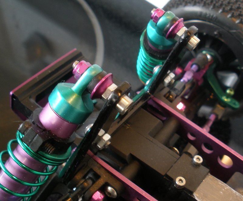

Here are some pics of my fabricated carbon fiber shock towers, you can see them right behind the stock green anodized towers. The glossy black edges, IMO, give it a more finished look. To me, it looks much better than simply cut or even sanded edges. These edges were filed & sanded smooth with a slight roundness, then colored with black Sharpie, then CA glued.CAT3K wrote:Just re-read this, do you have a pic of how this looks? It sounds like a cool idea with black glossy edges.Coelacanth wrote:I color the cut edges black with a Sharpie before CA'ing the edges, it looks better with nice, glossy black edges.

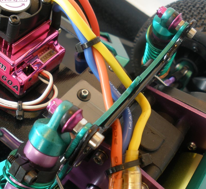

That looks quite good. Has it been CA'd or not? I wonder if one of those paint pens would work as single applicationi job. Not sure if the solvent inside will delaminate the fibers though.CAT3K wrote:Well i gave it a try, i'm not sure if do this colour again, but as a concept it works ok. Maybe red would look better?
It's tough to get it even and neat though, more practice would be needed, unless i do black.
Paul.
I've done red edges on my yok" hotdog long ago, but never CA'ed them. Every time I handled the chassis afterwards, I had red lines on my handsCAT3K wrote:Well i gave it a try, i'm not sure if do this colour again, but as a concept it works ok. Maybe red would look better?
Paul.
I should have mentioned what i'd done. I was struggling to find a colour, so ended up borrowing one of my daughters gel pens. They're more like a paint pen with a fine point. This colour was lilac/purple. I CA'd over the top of it.zoomzoombang wrote:That looks quite good. Has it been CA'd or not? I wonder if one of those paint pens would work as single applicationi job. Not sure if the solvent inside will delaminate the fibers though.
