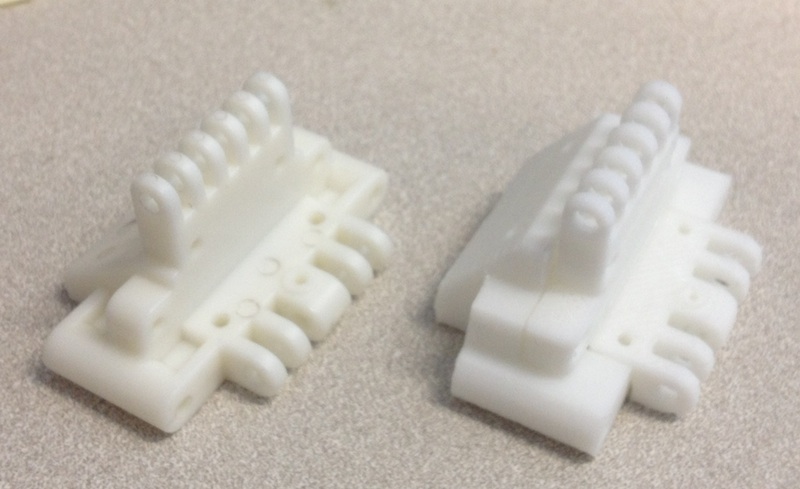

The first part back from prototyping is the the XX front bulkhead. It got moved up in the schedule and is done earlier than expected.
Original on left, new multi-piece prototype on the right.
The new design will be easier to make and allow people to only have to replace the portion that is broken and not tear apart the whole front of car to replace.
I now have to test everything, already found the top brace holes are little small and have to be made larger. Then there is also a problem with the gap between them that must be adjusted.
i will have pictures of other stuff in the near future as they get done.

It all depends if I put the new bulkhead in a mold by itself or with other parts. That is proving right now to be a hard choice to make, the molds cost a small fortune and it kind of makes sense to do multiple parts at once. It lowers total costs for that mold per part.
Ideally you want to add another part that is going to have near equal demand so that when you need to make more you don't have a bunch of parts you don't really need. The brace might be the ideal candidate to go in the mold. But I don't think demand is as near as high for it as bulkhead.

Brilliant! I love the two-part design, great idea!
Great to see someone out there making parts to keep our precious vintage racers on the track & keeping the costs down!

Would these be dyeable?? petpeeve of mine is white bulkheads
