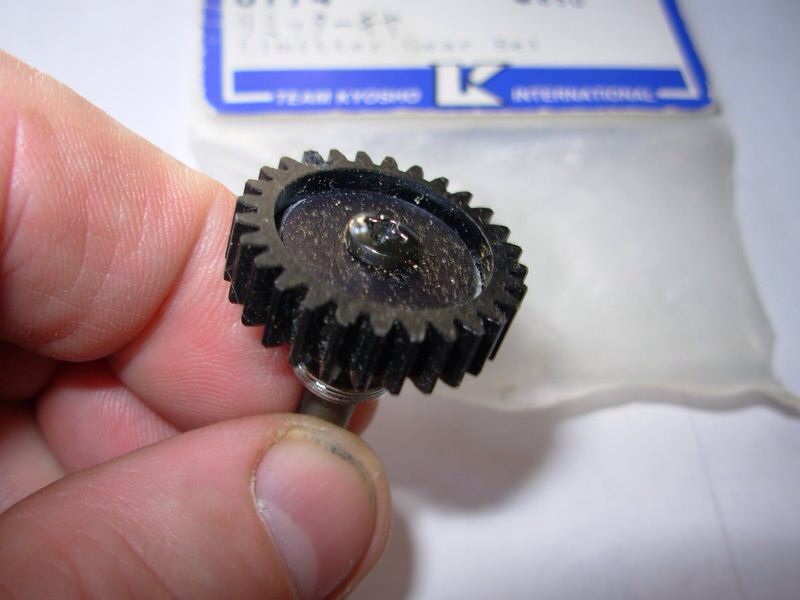

I have an ot-74 limiter gear, and its fixed with a philips head screw. Is this not the same gear set? Were there different productions of the same part?

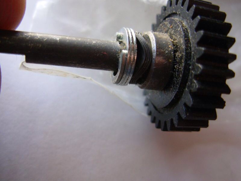

That doesn't sound right; there should be a threaded shaft protruding through the limiter gear, with the gear attaching with a gold-colored reverse-threaded nut. The original Optima gear (not the Turbo's OT-74 Limiter Gear assembly) is just a sold single part with the gear fused to the shaft, so no nut or screw. Also note that there are 2 kinds of OT-74; some had a thick, beefy spring while the other had 3 or 4 little spring-washers. They did the same thing but I've heard the beefy spring one was the better one.
More discussion on this gear setup is here:
http://www.rc10talk.com/viewtopic.php?f=30&t=17162
I've never owned the OT-74 with the spring-washers, though...only the thick spring kind.

Ahh, go figure, that's the variety I never owned, and the pic I found of it only shows the side view.
