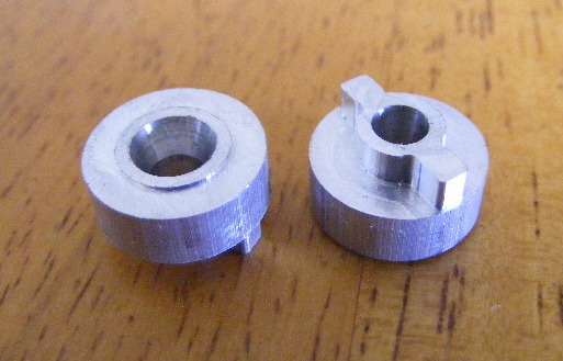

He also makes this to fit RC10 wheels on the Scorpion. This is his eBay ID http://myworld.ebay.com/dwyz250/&_trksid=p3984.m1438.l2754

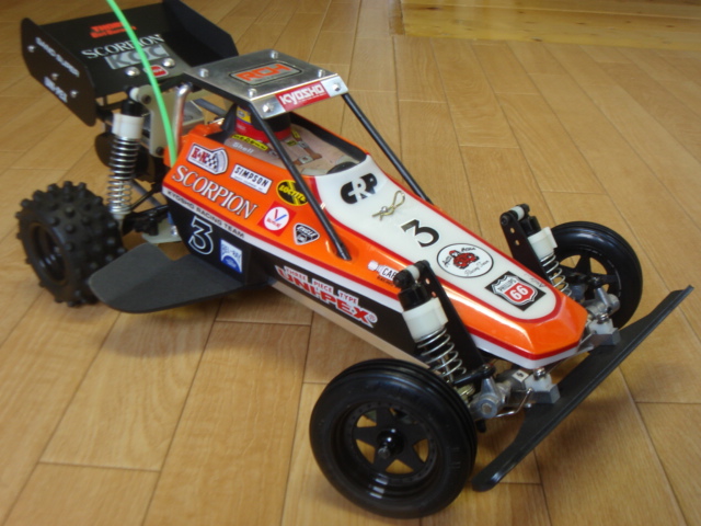

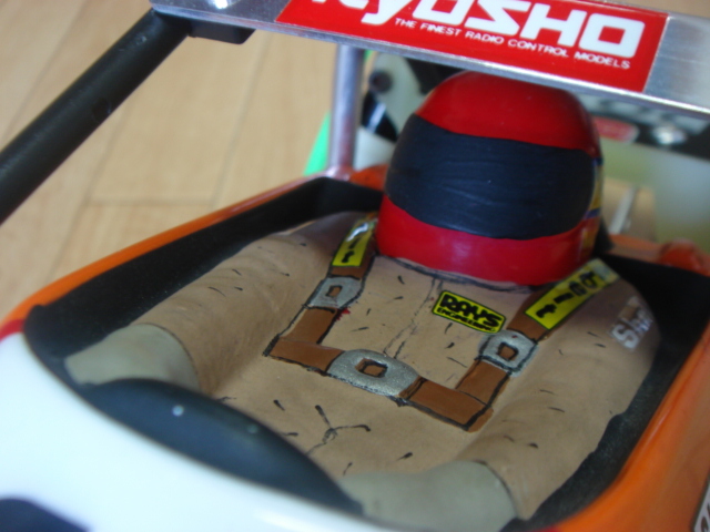

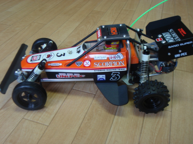

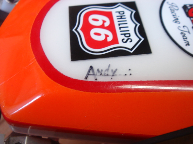

Her is another Andy Scorpion body that my friend in Japan owns.
