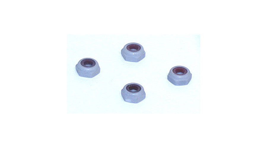

For the front wheels, I need to find a link to the wheel nuts I have, basically a 12 point 1/4" nut with a 10-32 thread inside

they look like this:
still havent found the link to the item though...

I would suggest that your nylon wheel nuts are probably well used & not gripping the thread like they once did, but yes they do bind up the bearings if they are tightened right up which means you have to back them off until the bearing is allowed to spin freely - there is a small lip on the inner face which should grip the inner part of the bearing, but this gets crushed if the nut is over tightened. I've got different metric axles on my car that work with Yokomo wheel adaptors but the wheels are secured with regular aluminium nyloc nuts.

I've found the same thing as what DerbyDan mentioned; overtightening front wheel lock-nuts always binds up the wheels. I tighten them up, then back them off just enough so they spin freely. They're lock-nuts so they shouldn't loosen off any further.

I use some Losi low-profile locknuts (LOSA6303), with spacers, on the front wheels. I haven't had any trouble with them coming loose. You do need to make sure not to tighten them all the way down though.
