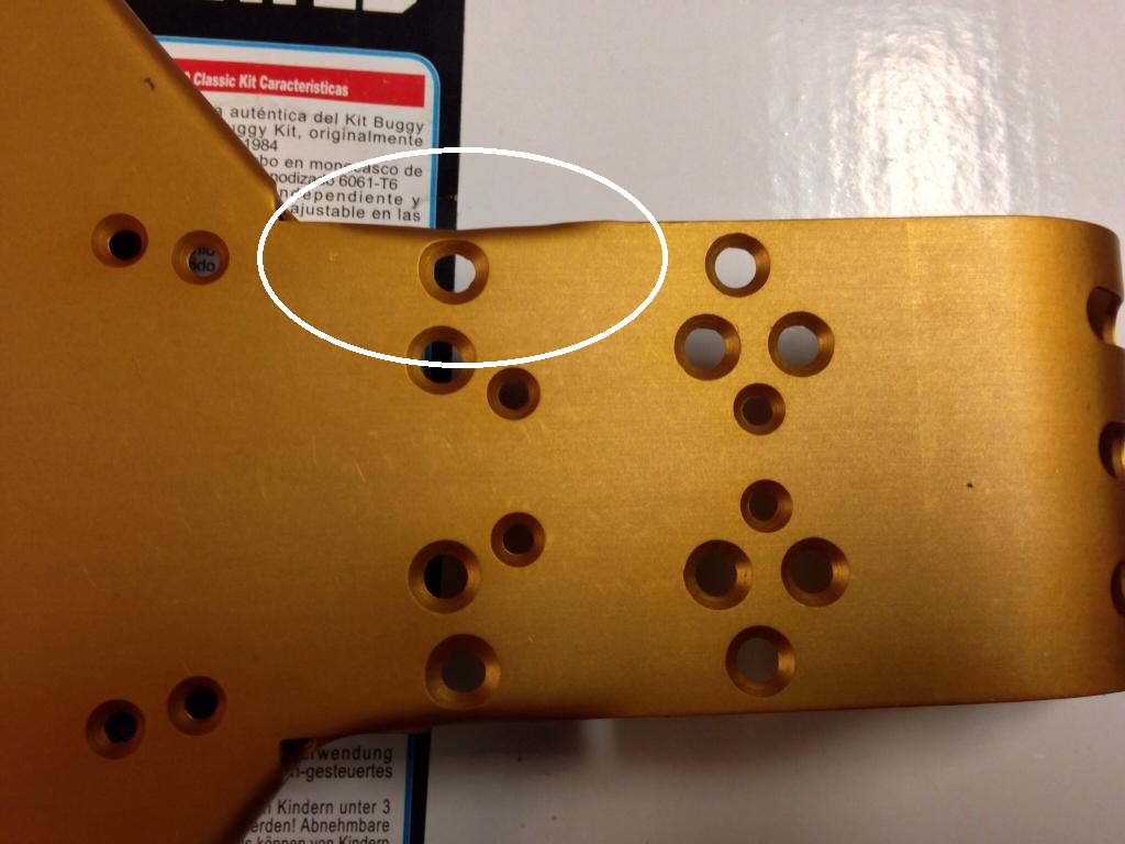

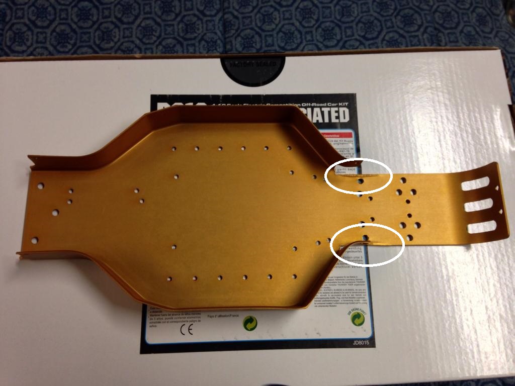

THE H.P FREAK wrote:HI!... Its just the shadow and the camera angle.
I don't think so, I see that odd crimp in every picture in exactly the same place...top AND bottom. It doesn't even look like a straight edge in the close-up bottom picture. Is this how all the re-re pans look? :shock: (Click to see the images at proper size.)
SnoopMaxx
Posts: 699
Joined: Sat Mar 06, 2010 3:38 pm
Location: Vraa Denmark
Re: THE H.P FREAK's RC10 'Classic' build
Post by SnoopMaxx »
The die that's used when making the chassis goes all the way out to the end of the bulkhead mount
and after that the extra material is removed

Coelacanth
Posts: 7421
Location: Alberta, Canada
Post by Coelacanth »
Were they also like that back in the 80's? I don't seem to recall ever seeing gold pans with that kind of deformation...on here or eBay or otherwise. Maybe I haven't been looking close enough. :?
SnoopMaxx
Posts: 699
Post by SnoopMaxx »
I posted these of my original A stamp a few month ago
