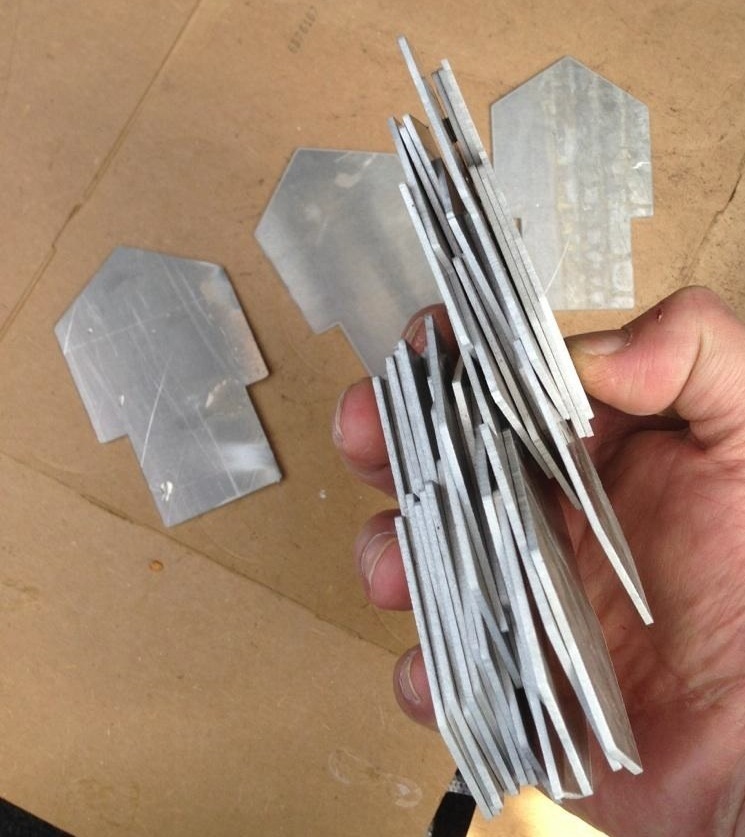

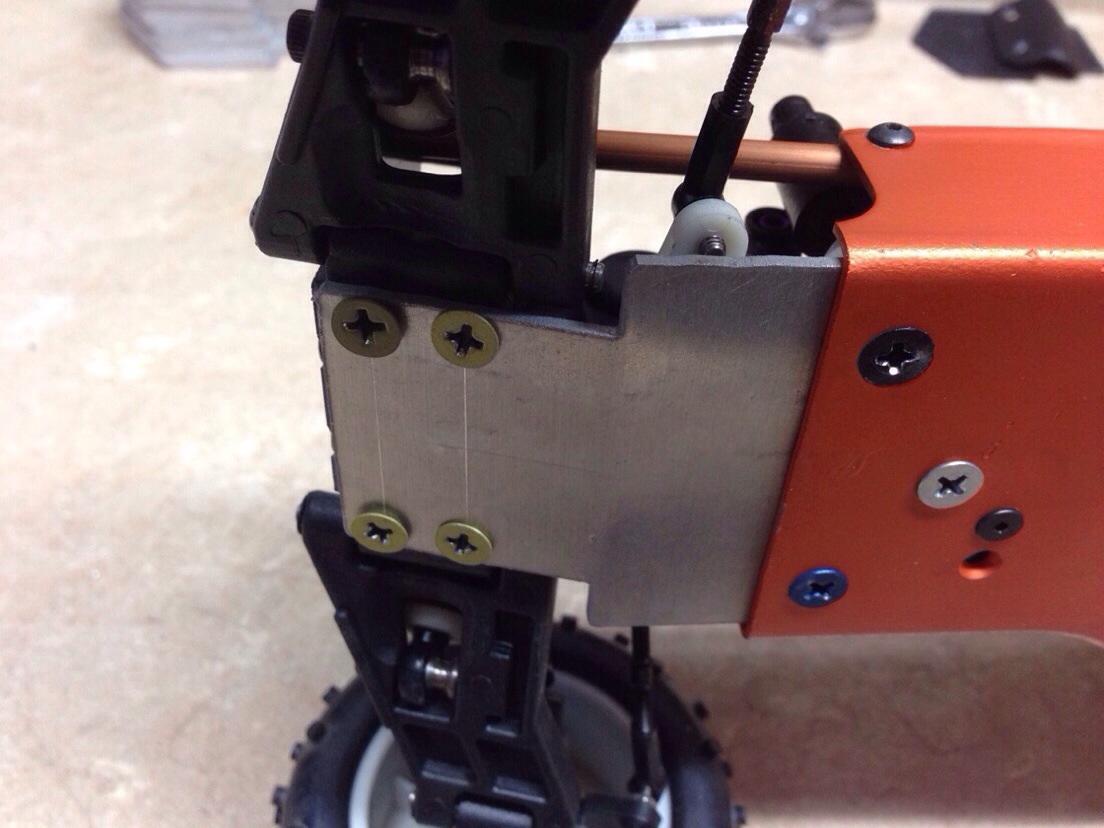

Woot! Finally got the noseplates cut out, need to drill and anodize them. Still plenty of things to go still- like cut down belts and getting some more pulleys machined but this is a huge step 8)
Just a mock up, ignore the non countersunk holes. Bumper is missing from pic

Wow, that's a lot of noseplates!
