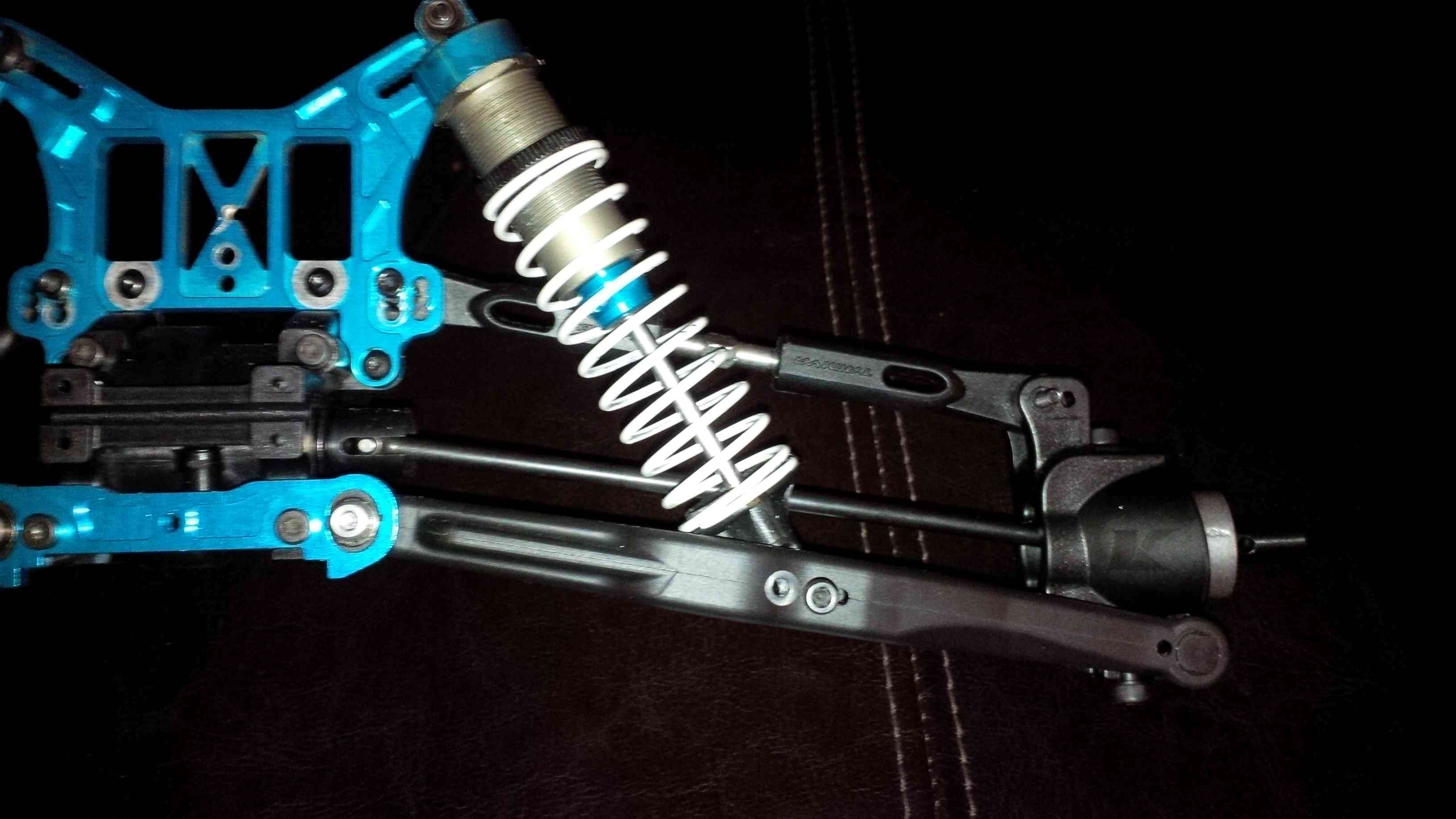

so i stumbled on a combo of front end parts that require no real modifications, (no hogging out parts) and uses the STOCK long driveshafts...
i bought a 801 buggy roller for some choice parts a while back and decided to run the rear tower and shocks up front, i bought some st-rr universals, they fit, needed dremeling of the c-hubs (i was trying to use the buggy knuckles) and at full suspension compression the dogbone end would pop out of the diff... this is trying to use the xray truggy arms
pissed i spent 70 something dollars on driveshafts that didnt fit, i decided to look for other hubs and knuckles... on a whim, i was thinking if i used kyosho pieces, they would offset the Universals and would give the correct spacing into the outdrives... i got a complete set of what i think are MP9 readyset hubs, complete front and rear, bearings, and all hardware... studying the hubs in hand, they seemed exactly the same, minus a few camber placements and no second hingepin hole... you can adjust the caster in the kyosho hubs via a spacer that was included... so with no real scientific method it just looked like the hubs kicked out the wheelbase enough, threw in the kit cvd in and voila...
the arms arent too expensive and pretty beefy (you need the xray caster bushings too), combined with the kyosho hubs, is a near no modification fit, i drilled the xray bushings so i could use the stock threaded hingepin, or just get the xray captured pins, you might want to file the back of the arm slightly as with the combo of buggy shocks and tower, the knuckle rubs against it at full extension, but still has full lock to lock steering throw, best part, it took all the work out of finding the correct driveshafts!!!!!
